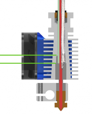

I took your photo and attempted to scale it to the E3D drawing and then superimposed the images. If I were to hazard a guess, I would say that your Bowden tube is not completely seated into the top of the heat break.
Re: Canola Convert
That plug is coming from much farther inside the hot end. Feels like it's near the heat break.

Maybe you drilled too far, thinning out the nozzle cone, and not enough heat can get to the nozzle tip? That would explain why the filament feeds great, but jams if it ever stops. If the filament easily passes through at first, it transmits heat to the tip area, but once it stops, the tip cools too much.
Take some fresh filament and run it through. Mark the filament right at the top of the hot end, and then pull it out. The measurement will tell you precisely where it's jamming.

I tried to be very methodical with the finish of the drilling. Used a magnifying eye piece to make sure I didn't end up with any burs as I know they can be a huge problem.mhackney wrote:Make sure there aren't any burs.
I used this (http://www.thingiverse.com/thing:197152) and tossed on my 40mm high CFM fan instead of the stock one. I also wrapped the heater block in kapton tape in order to try and keep the heat closed in for the tip in case 626Pilot is onto something.
I went from my plug (top filament) to the one on the bottom after the changes.
I tried moving the filament in and out, stopping, going slow... I couldn't get it to jam at all. I'm going to try a print and see how it goes.

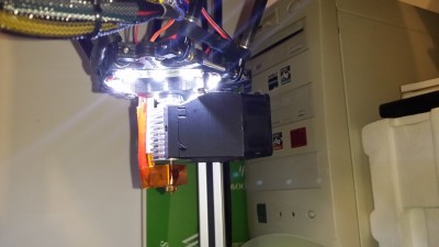

Update:
Designed a 50mm fan holder that would fit into a GoPro base so that I could cool the print from the side of the build plate. I don't have a blower for the nozzle yet with the E3D being mounted under the effector instead of on top. The print went perfect. It was only a 28 minute print though.
I'm now trying for a 16 hour print now. Not many retractions. We'll see what it does.

I came downstairs to my printer this morning to this:
BUT!!! Then I look up to the top and see this crap.
I didn't have time to restart the print this morning, but I have high hopes! It was putting down amazing lines and had already run longer than I've ever got it with the E3D. Again though, on this print, there probably wasn't a single retract except from the loops to the print. Still, when I was playing with it manually, it was working like a dream.
