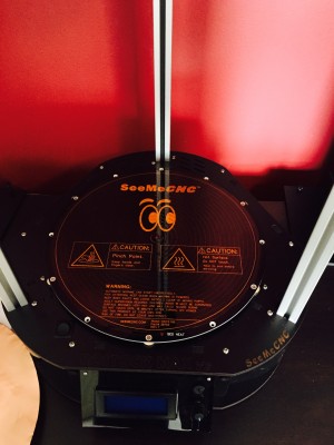

This may be the best Christmas Gift ever!!! I mentioned to my wife, that I had the easiest gift idea ever, one gift, a Rostock MAX v2...... Hallelujah, Santa was on target 120%!!!
It has become known and named by my teenagers as my "BAP" or Bad Ass Printer...... Totally Awesome!!!!!
It has been a ton of fun to put together with my kids, and has consumed our office space at home....
Great instructions and has been seamless. Today while soldering the wires to the Onyx Bed, I noticed one of the solder pads lifted off the back of the Onyx Bed when I bent up the resistor wire wire to trim it. I realize these pads are to allow easy connection of the wires and completion of the circuits, but because the pad lifted off the board, I am worried about a circuit break. I checked the impedance between the + 12V DC solder terminal and the proximal side of the resister, across the resister, from the resister to the LED, across the LED and from the LED to the -12V DC solder terminal. All these measurement are appropriate with impedance being 0.00 with only resistance across the resister and LED.
Is this going to be OK long term with the Kapton tape in place or should I place a small jumper wire to ensure connection? I also worry about the thermistor pads as well. Thoughts??
Thanks!!
Dan
Thanks!!
Dan

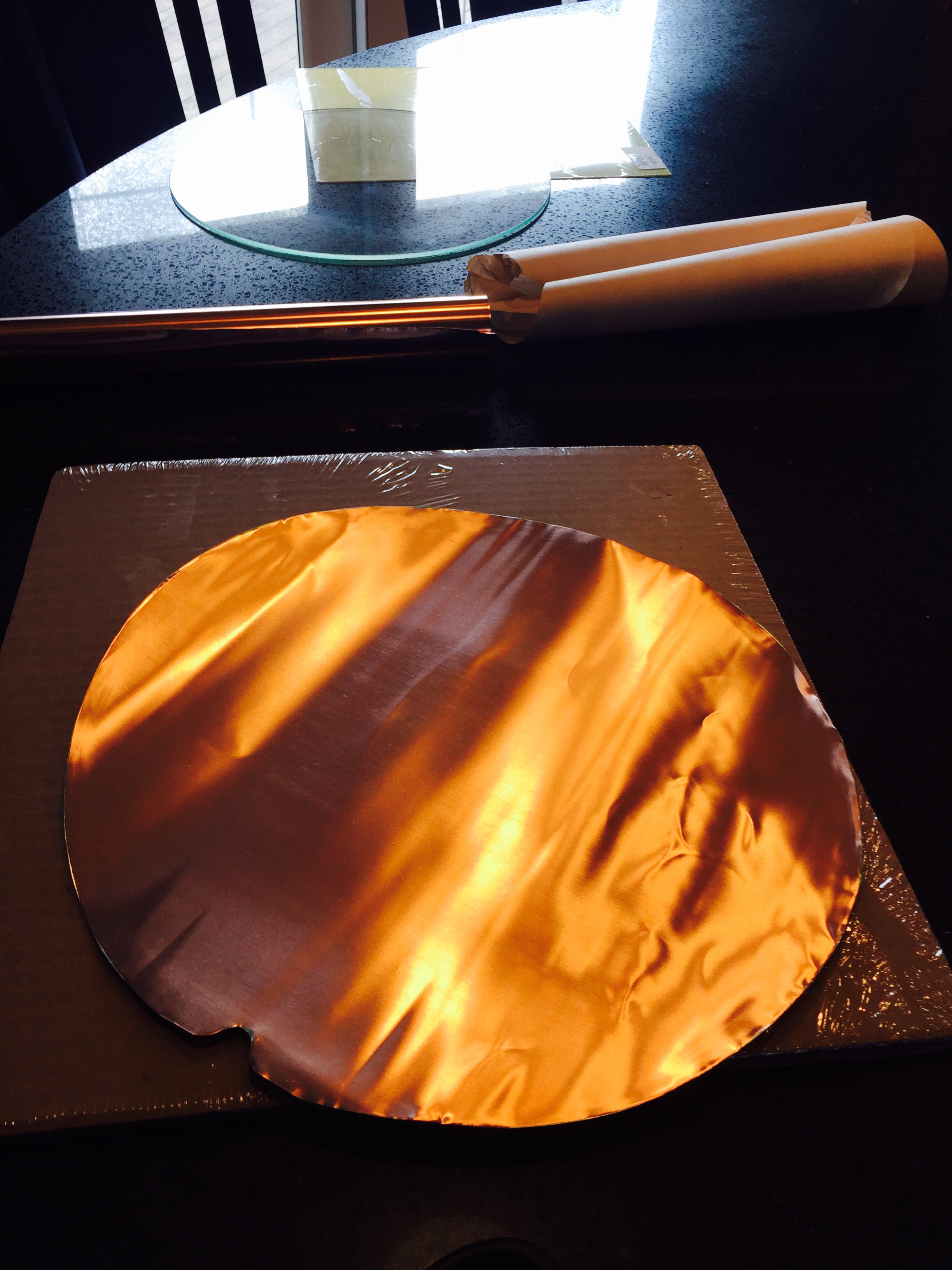

Copper Sheet for Onyx, and PEI for the Print Glass
The final steps: UpGrades - A copper sheet between the Onyx bed and glass, as well as add a PEI print surface.
I ordered the following.
1) PEI from amazon is: PEI (Polyetherimide) Sheet, Opaque Natural, Standard Tolerance, ASTM D5205 PEI0113, 0.03" Thickness, 12" Width, 12" Length ($17.34)
(http://www.amazon.com/gp/product/B0013H ... UTF8&psc=1
2) St Louis Crafts Copper Foil Roll, 12 Inches X 5 Feet ($24.48)
(http://www.amazon.com/gp/product/B0042S ... UTF8&psc=1)
3) Kapton tape sheet to protect the Onyx ($19.95)
(http://www.amazon.com/Addicore-Kapton-P ... B00JPTKFRU)
UpGrade Plans:
Place the Kapton tape sheet on the Onyx. Was easy to put two sheets on and then trim off the excess with a blade.
Then, taking the 12" wide sheet of 36 GA copper sheet, I placed the print glass on the copper and I drew a line around the glass with a pen to make an impression. This was then easy to cut with an old pair of kitchen sheers.
Now I'm going to set up my PEI print surface as detailed by mhackney (http://forum.seemecnc.com/viewtopic.php ... &start=618)

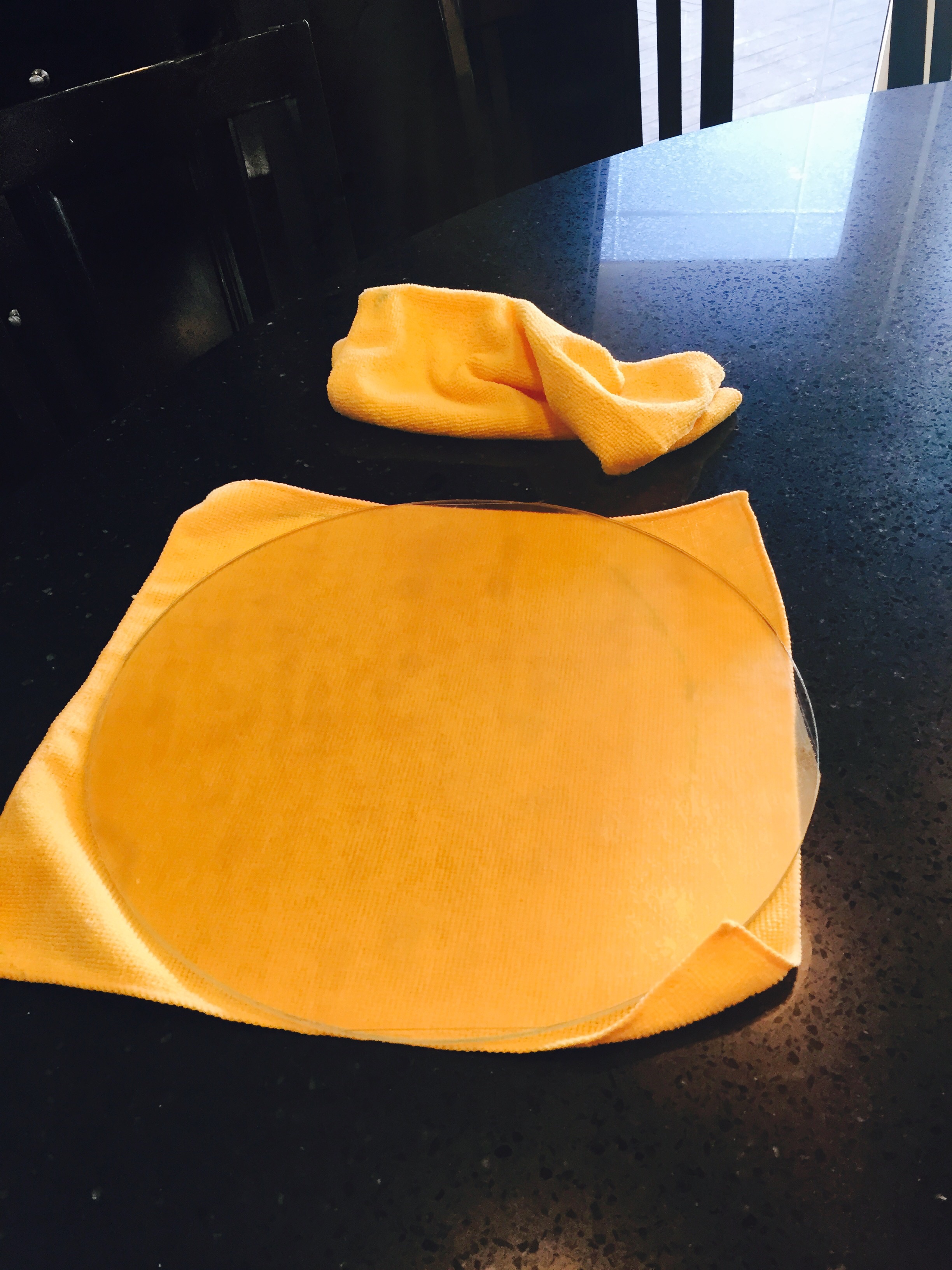

1) Triple-washed the glass, after scraping it down with a razor blade, a cleaner, then Windex, then isopropyl alcohol
2) Place the 3M tape - TapeCase 468MP 12in X 12in
3) Isopropyl EtoH clean the PEI, let it dry, then laid it down with a minimum of curling of the plastic.
4) Weight it down
Will let you know how it all goes.

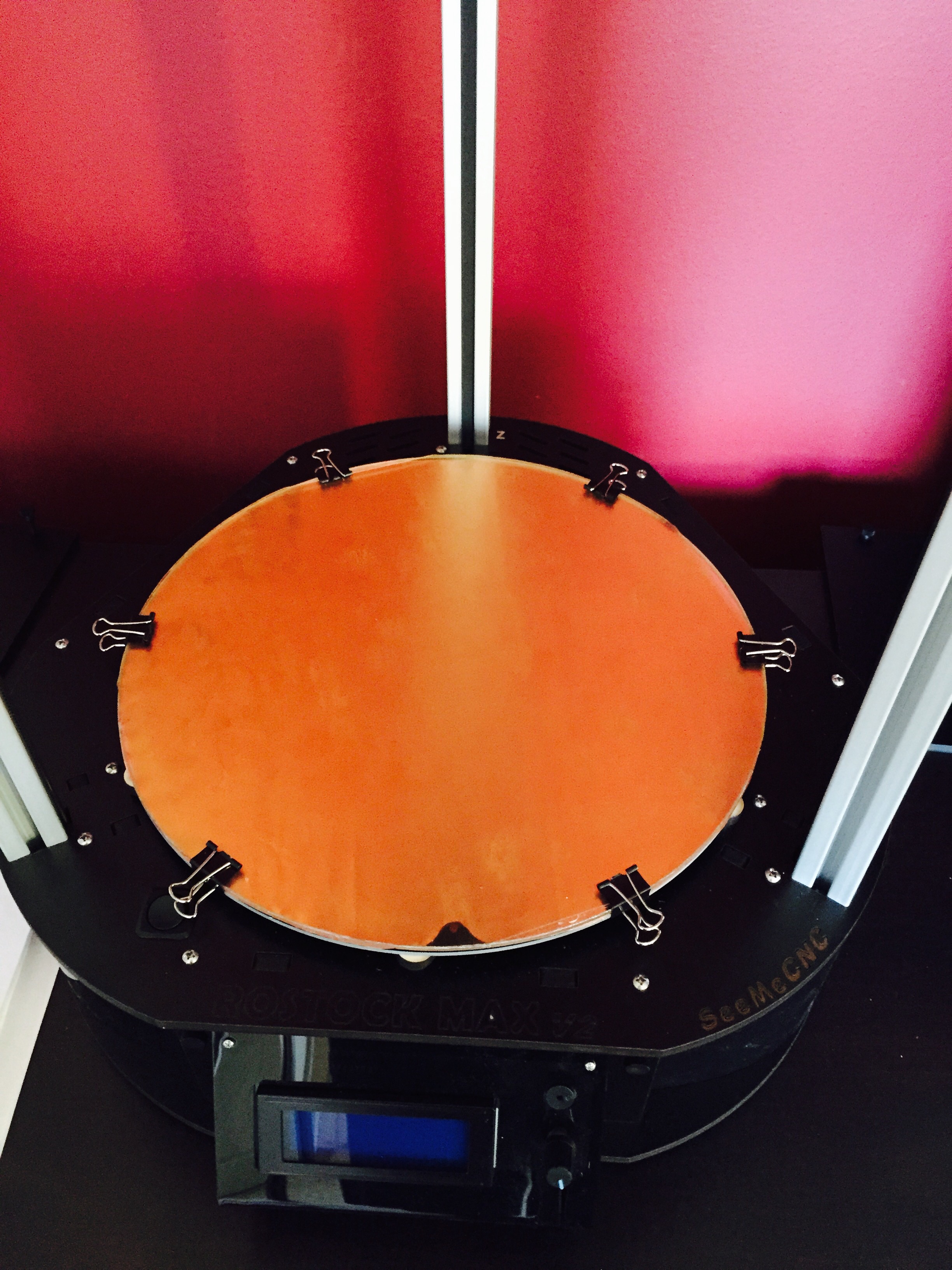

PEI Installed with 3M 12" X 12" TapeCase
Just now placed the PEI as detailed above and at the following link (http://forum.seemecnc.com/viewtopic.php ... &start=661)
I used a new utility knife to cut the PEI which worked awesome and left a nice smooth edge. then i rubbed off a bit of the 3M tape which stuck to the edge of the glass.

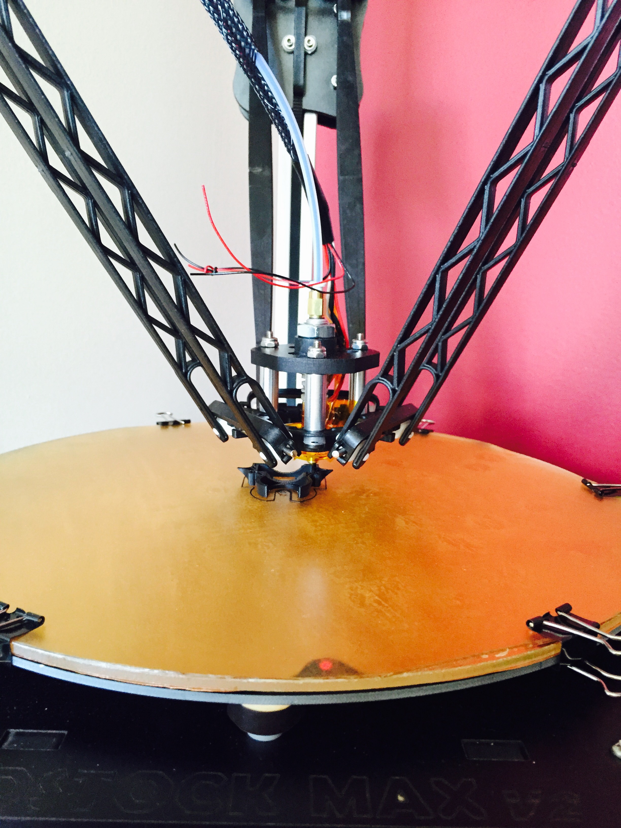

Re: My "BAP"

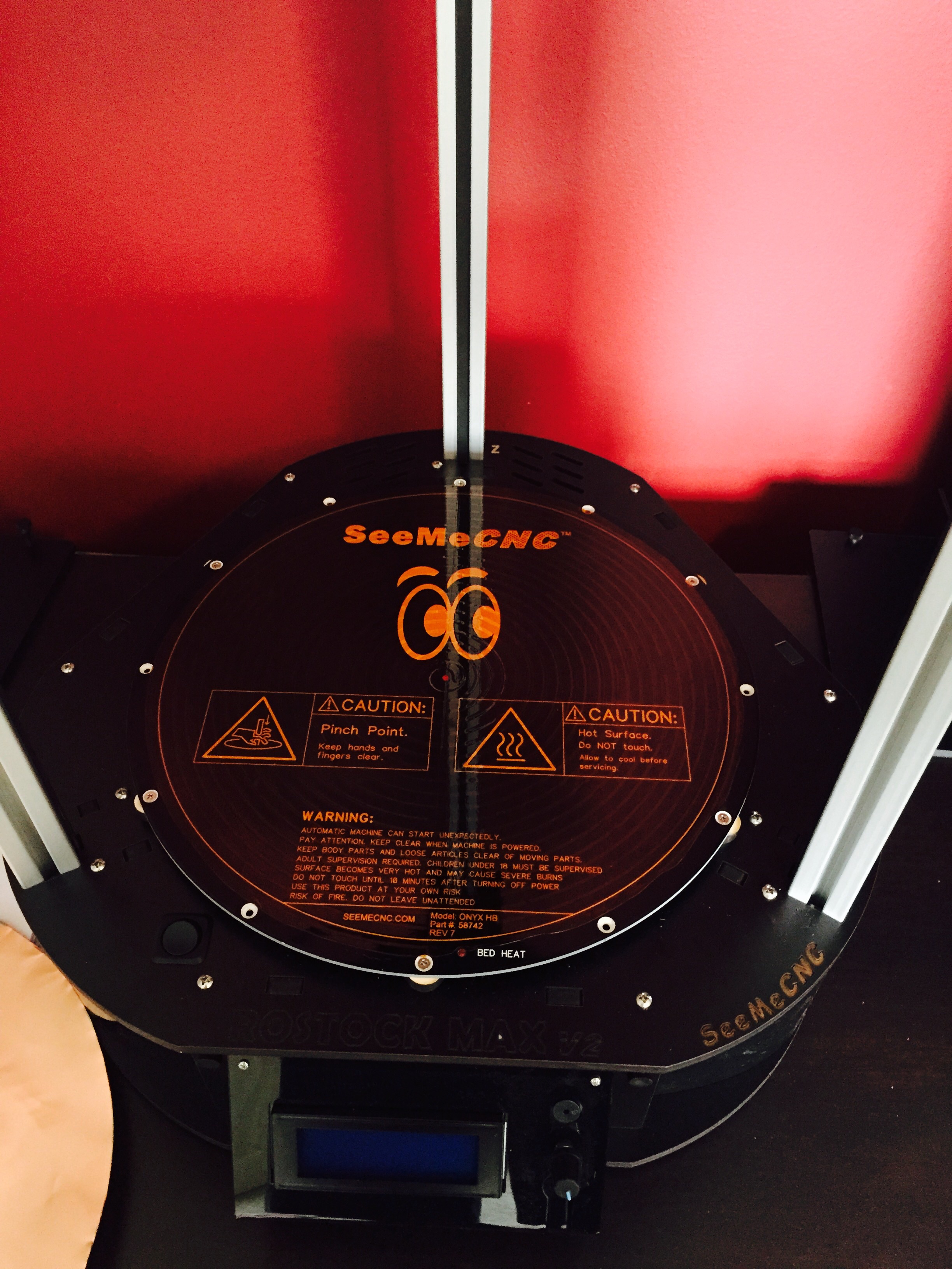

Adding the Kapton tape
Re: My "BAP"
My cut copper heat conductor
Re: My "BAP"
The 3M Tape is on
Almost there!
PEI is on, and the glass and PEI is on the copper sheet and clipped in place.
Awesome!!!!!

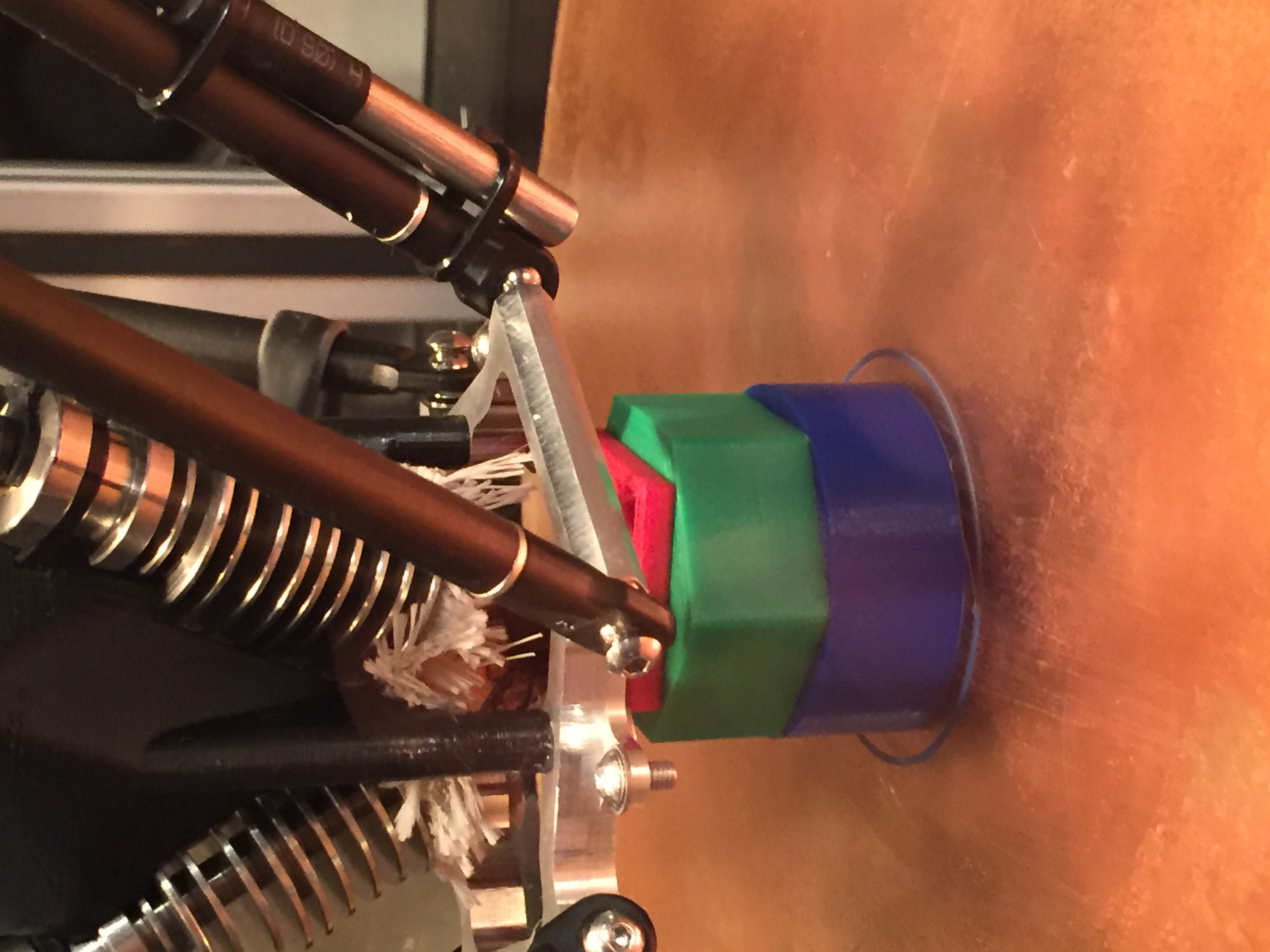

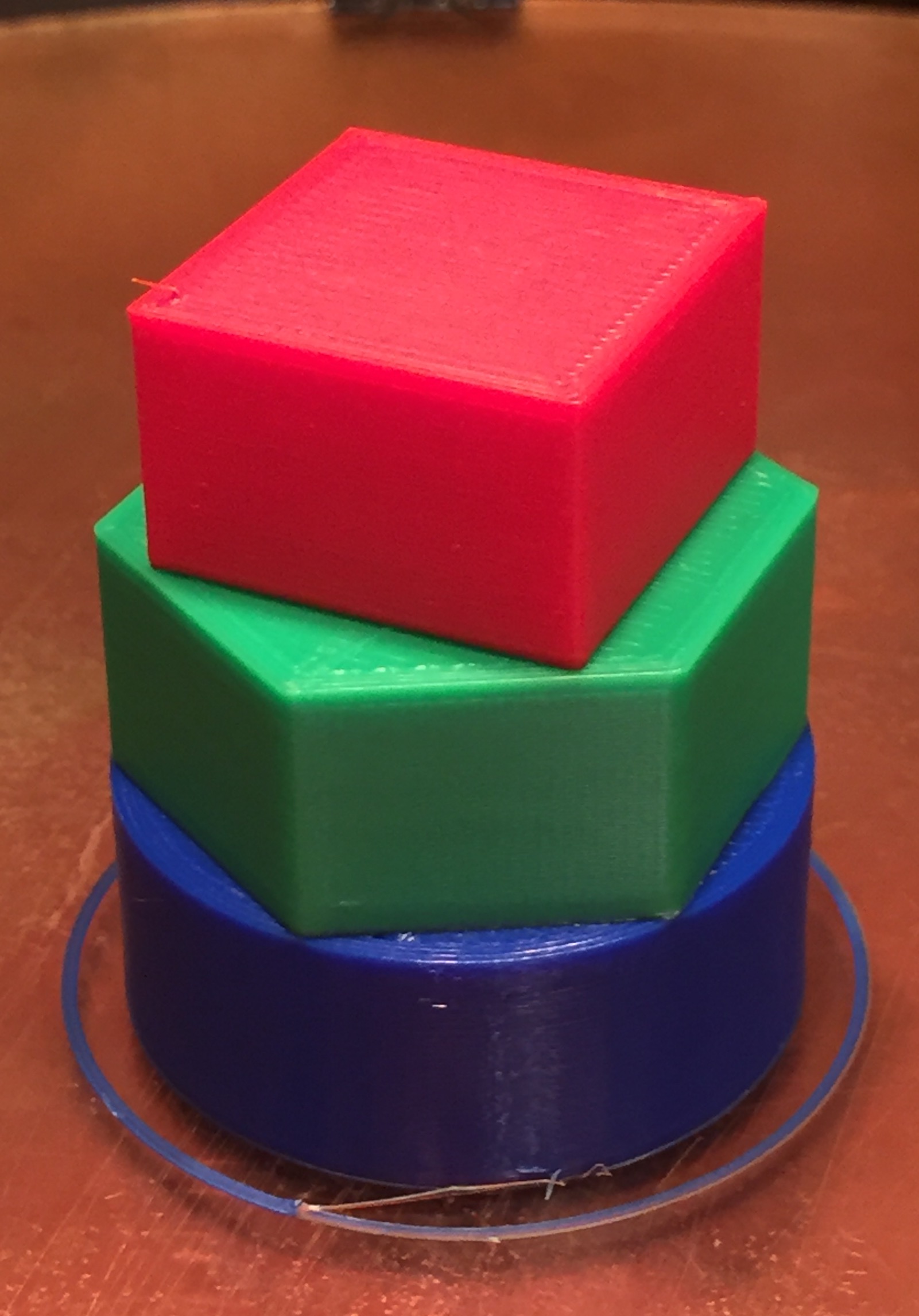

Ok, it is all calibrated. Took me about an hour and 45 min to get it money on!!!
Re: My "BAP"
I just loaded up the PEEK fan file. Here we go!!
Re: My "BAP"
Other than replacing the power unit..... Up and running without a single hitch!
Awesome!!!
