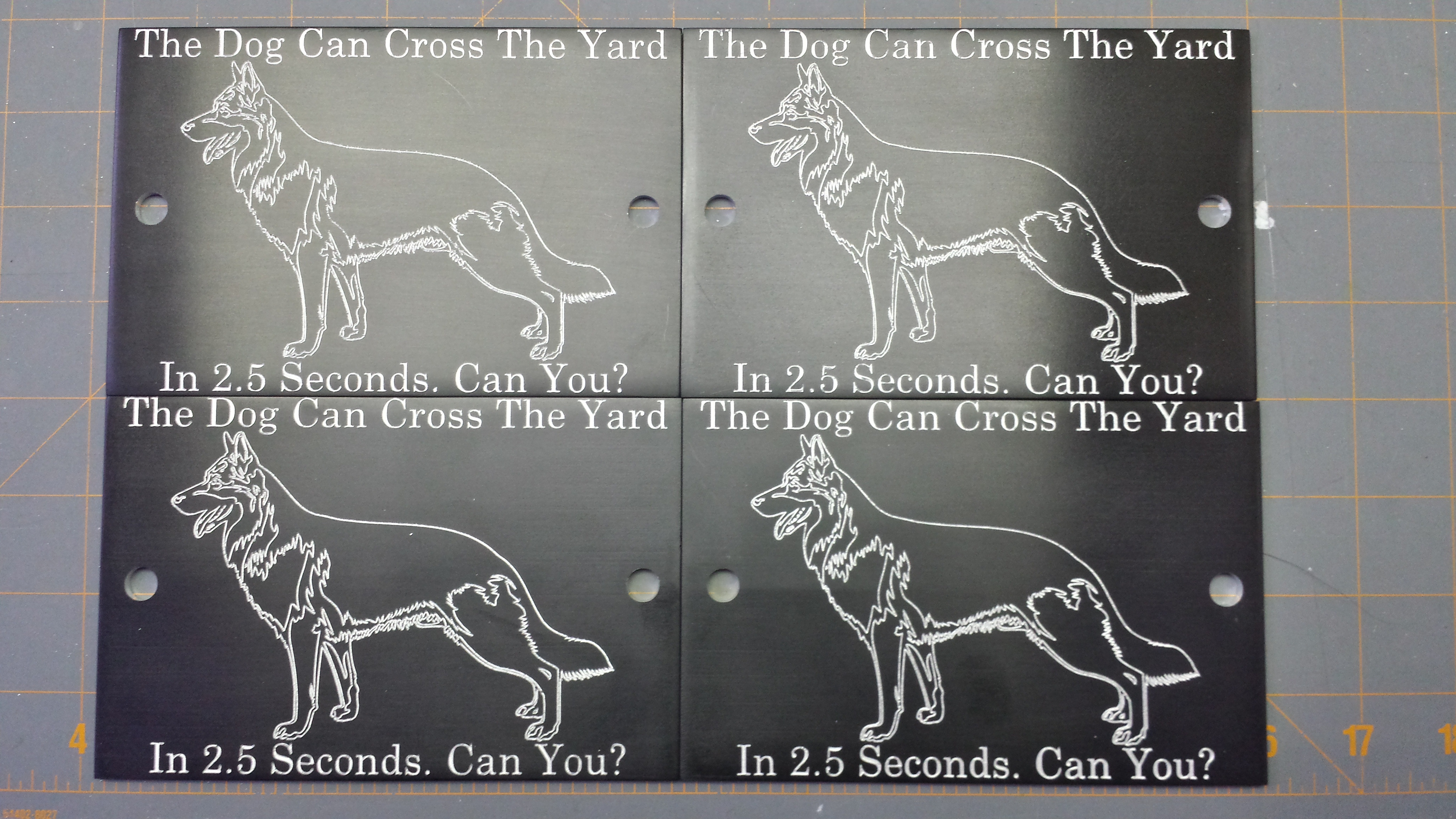

I have used the very same bits in metal and they work great.. Here is a shot of a sign I did for my folks and their new german shepherd The dog was done as just a 1/4mm deep etch. the lettering is done at .5mm v carve with aspire 4 for this one. All four signs were done with the same endmill and it was still sharp once finished. The blanks were cut from the stock sheet then prepped and anodized black. Then mounting hole were cut with a 1.6" endmill and the sign was engraved with the 30 degree .2mm engraving bit. I get mine here http://www.ebay.com/itm/10x-Carbide-PCB ... 418193a5ce they work great in metal, stone and also good for a fast PCB prototype, but I do not use them for final PCB cuts. I use another bit for that.Jassper wrote:Thanks Nitewatchman, I do have some bits like that. I'm surprised they work on metals.

I but my small endmills from http://www.drillbitsunlimited and they ship fast and have a great section of smaller endmills.
I use http://www.ebay.com/itm/381043625814?_t ... EBIDX%3AIT for my aluminum most of the time unless I need something smaller... Of course I tried another bit on the stock SEEMECNC mount I used in the tumbler shots and as you can see it was not near as good of bit.
I run the endmill above at about 100mm M taking a .1mm cut each time.. I tired the new endmill at 65mm M and tried to cut it at .25 and it chattered on me as the pics showed.
I did this with a .80mm endmill from drillbitsunlimited Then anodized it and filled in the mill work for a contrasting color. Custom blending the Aggie maroon anodizing dye was interesting to say the least. This was a one off gift and NOT SOLD so I THINK I am OK with not being hunted down by the Aggies!
