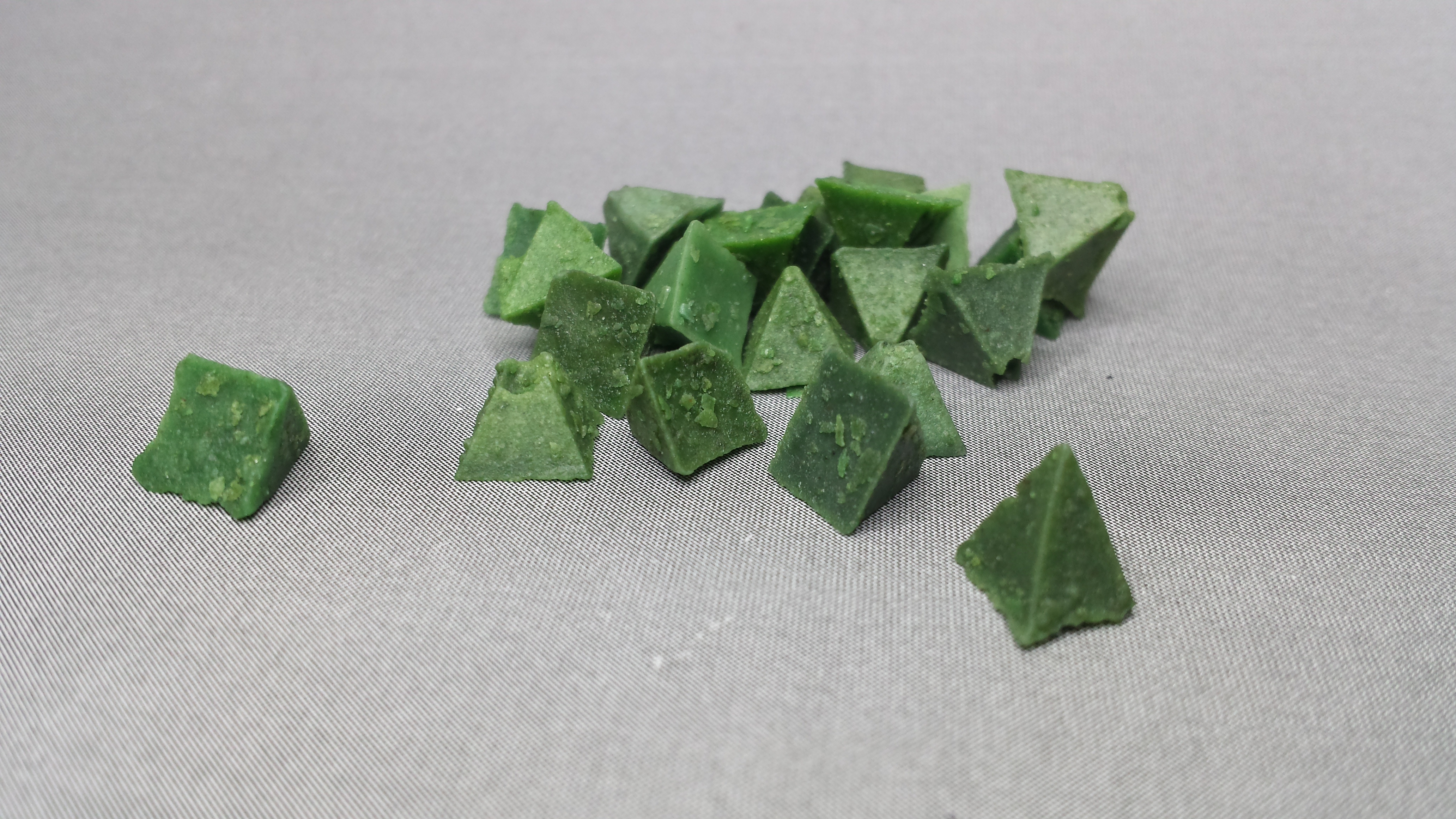

travelphotog
- Posts: 398
We all know what these are for..
So in about an hour so so we will see if we get any good results.

travelphotog
- Posts: 398
Before
After 2Hrs in debur compound
Running a polishing cycle now.
in 2-3 hrs should have something more to show.
