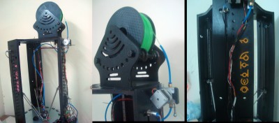

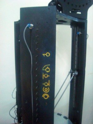

DELTA-1 turned black ... MDF absorb color better say it drink color...so did a primer of (50%Wood glue+50% water mixture)..after dryout just spray paint...

I want to make sure I'm not being ignorant, but are those the Unown Pokemon spelling out "Delta 1" in orange on the side of your printer?
That's what I thought it was before, but with the close-up it's hard for me to deny...
Edit: Upon closer inspection, they indeed are NOT pokemon, yet bare a striking resemblance in my opinion.

This is Alien Lines font:

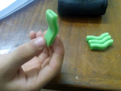

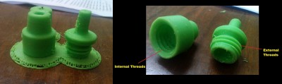

Today was the first test print... PLA 215 Nozzle and 75C bed temperature...used white
glue stick. The raft was detached but the brim was solidly adhered to the bed till the end of the print..
http://youtu.be/Ik7lkaavRuA

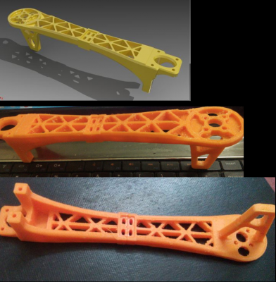

some photoes
some photoes

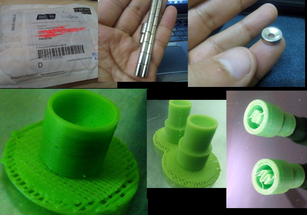

- Posts: 276
Re: My DELTA-1

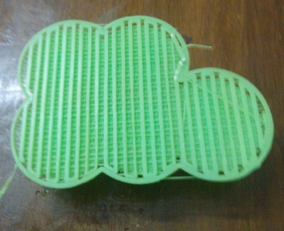

Now i need help
... why the bridging between the parts... and all my 5 cylindrical objects are somehow flat at exactly opposite side..why?

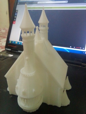

- Posts: 276
Re: My DELTA-1
Though the auto-calibration function worked great and the sample test results were also promising...But i need much more than that...more accuracy, repeatability and precision or mix of all these ..Presently the bed is fixed and i can not adjust it for leveling purpose... .... So back to the CAD modelling stuff, designed the new part for precise leveling of the bed...The new part will help me leveling using 3-point contact method....Machined the part and can be seen how 6mm Nut set in the machined recess ... Unable to do all this without CNC.... i need the same accuracy of my CNC machine in the 3D printer...

Re: My DELTA-1
Wow..yesterday i received the magnets (took 40 days from China)..These are tiny magnets N50 but very very strong... I installed 06 of the countersunk magnets on the original magnets(Dart game Magnets) using super gluei...but the rest of 6 can not be installed as the DART magnets are already fixed in the machine and i am getting polarity difference with the new magnets:(.... With half of the magnets installed i calibrated the DELTA-1 and 3d printed some of the parts that will receive the new magnets..ultimately machine is now making parts for his own and i see bigger difference of quality with the new magnets...
