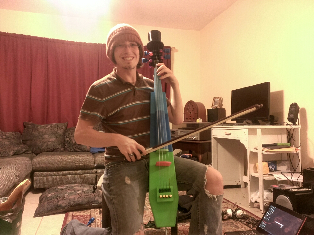

Just wanted to put in my two cents as to why I love PLA so much.
I managed to print a cello with it...

Lightninjay - you printed that cello in PLA? That's amazing! I assume you printed in pieces then glued them together somehow? How did you handle supporting the string tension? The instrument is beautiful! Well done!

The Cello is one of the best prints I have seen from a 3D printer. An excellent job!
A wave file uploaded here that allows us to hear the tonal quality would be great! (hint)

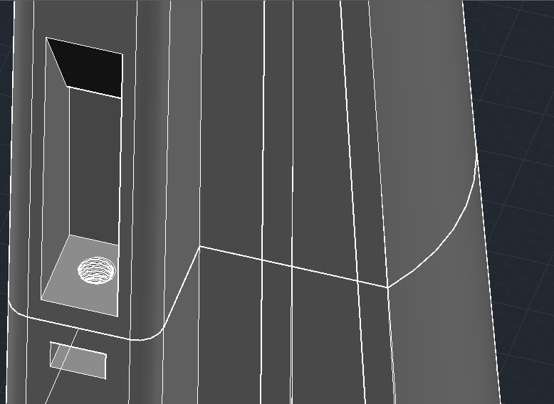

Teri, I modeled the whole cello in autocad and then broke it into four sections that could fit within the build height of the printer. Then I designed threads directly into the parts so I could bolt hardware through the sections to hold them together. Lastly, I took a note out of the "F-F-Fiddle"s handbook and threw in a threaded support rod that runs the general length of the cello in order to take most of the tension of the strings.
Carl, thank you so much for your praise! Saying something of that magnitude means a LOT coming from you, having seen so many prints in your time here. Here's the tonal quality you requested!
[youtube]http://www.youtube.com/watch?v=m4EP1y5HThM[/youtube]
One note I would like to make, the video was taken using a cell phone camera and microphone in a closed bedroom space that tends to echo a bit, so I personally don't think the video demonstrates with true justice, the actual sound of the instrument.
That being said, I'm currently doing work on an electric pickup for my cello design which will allow amplifying and modification of direct sound waves generated by the strings' physical vibrations in space.
