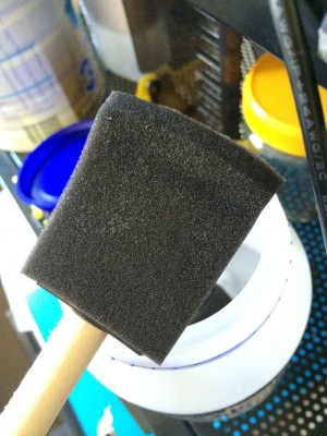

The well used foam brush, notice no caked on glue as I'm only applying thin and even coats.

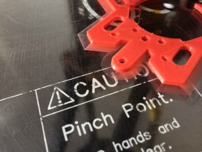

Close up of the plate with glue applied and printing ABS with no brim, you can barely see there's any coating at all!
Another printing ABS with brim. As you are applying the coats, just before it dries completely while there is still a small amount of moisture, stop brushing and the surface will even out slightly and then dry clear with virtually no brush marks. :)

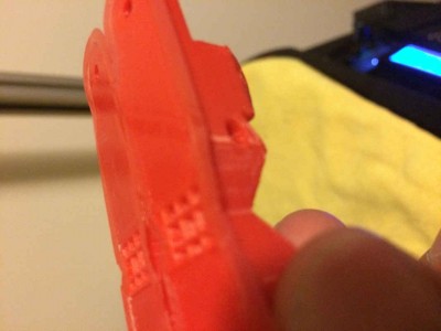

Its kind of hard to see but this is the finish you can expect once done. Also as noted by a fellow forum member the print releases with no glue attached meaning even if you rinse the parts in water after printing they still maintain that glossy finish!
