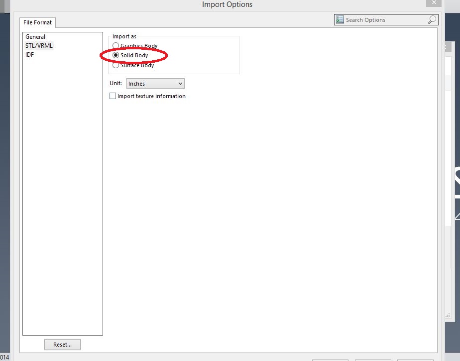

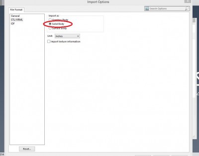

Importing STLs as solids into Solidworks is pretty simple. Check the screen captures. As far as modding whats there i.e. adding bodies to bodies, that is pretty simple too. Say you have three different files you'd like to combine into one part. Import all the STLs as solid bodies as separate parts. Then save each file individually as a solidpart file. Then open anyone of the three files and go Insert/Part and translate the parts to where you'd like them to be. Once you're satisfied with the position of everything you can then use the Combine feature and do exactly that, combine all three bodies into one solid body. From there, export as STL and you're ready to roll.Proto wrote:Wow... I guess the way to get a lot of response to a post is to ignore it for a few days![]()
