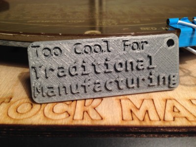

Well, apparently I was right, and wrong. That 118 degree drill bit (or was it 138...) is quite terrible at making a good smooth transition. I even bumped the temp by 15 degrees above what I print at regularly. I made a thing, but it was under extruding and not extruding at all in a few places. Looks like the next one (already in progress) will need a few changes. Bridging was much better though (sharper point on the nozzle gives better bridging ability too)
Appropriate Message for a traditional manufacturing class
This file has pretty much everything a good torture test has. Everything except a nice big swooping overhang...

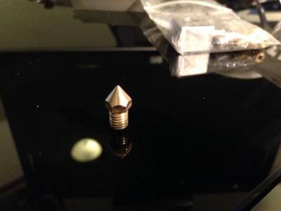

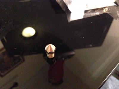

We got a 2mm drill bit ground to 80 degrees and I think it will work well. I made a new nozzle today that came out nice. I broke the .36mm bit in one of the nozzles (these lathes don't move fast enough...) so I used the one just larger (I think it's a #78) that is just above .4mm. I think I have one that will work well, but I need the wrench flats before I try again. I also am going to reuse the original one with the more abrupt transition. I can redo the hole with my new bit and hopefully get nicer results. When all is done I hope to have 4-5 complete nozzles. If they work well and my local maker space ends up getting a lathe I may offer to make a few if some are interested.
Also, I now have a 2mm orfice nozzle :D I was trying to get the broken part of the #79 bit out by taking a small amount of material off the angled part (it exposed a tiny bit of the bit that I could grab onto and remove from the nozzle). I did just that, and I moved my hand to what I thought was the carriage feed wheel to back the tool from the work piece, turned the wheel, and cut off the tip of the nozzle. I accidentally grabbed the cross feed.
Nylocke
Posts: 1418
Location: Iowa
Re: Mike's Birch V2
Post by Nylocke »
I got the wrench flats machined, and with the new 80 degree drill bit I think it will work nicely. Going to do another test print soon.

Re: Mike's Birch V2
Your nozzles look good, please let us know how they work with that 80 degree hole.
