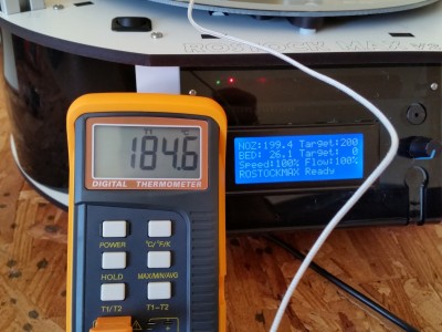

Can I get some opinions on the legitimacy of my thermocouple test? Particularly the placement of the probe/binderclip combo. Professional-grade work, I know. 8-)
If this is legit, then my target temp of 230 for PLA was actually printing at 215, which seems a lot more reasonable.

You want the tip of the thermocouple in the corner of the 90 degree angle formed by the nut on the nozzle and the bottom face of the heater block that it's screwed in to.

Nice thinking, but you need to be checking the temperature of the nozzle, not the heater block.
Two good locating tricks:
1 - pull the bowden tube out, drop the thermistor right down to the tip. If it fits.
2 - Unscrew the nozzle enough to get the thermistor behind it, then tighten the nozzle until it just grabs the thermistor and holds it in place.

Yup you guys were exactly right, thanks for not letting me be lazy. ;)
I used the "unscrew the nozzle" method and as it turns out, the thermistor is bang-on accurate! I heated the extruder up to 200 and the thermocouple read 199 - I'm not going to sweat a 1 degree difference.
I swapped out power supplies, reset both PID components, and I'm doing a print now, which I'll keep on eye on. Fingers crossed that this solves the problem!
