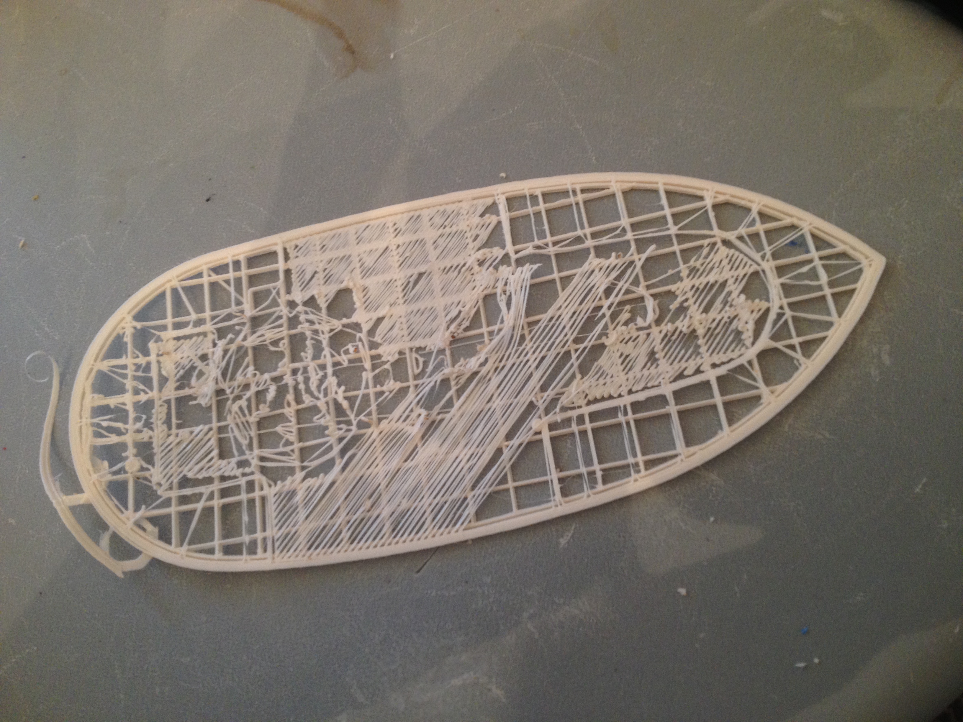

I am not sure why this is failing. It is the lid to a box. The printer starts with a nice grid but it is suppose to be flat instead it does this crazy mesh.
What has to be changed? I imagine something in the STL file itself? Attached is also the STL file. Thanks

What slicer are you using? and do you have raft enabled?

Yeah it looks like the model might be a few mm off the bed when the print starts and so it's building a raft or support of some kind before actually beginning the model. The model itself looks fine so I don't think it's a problem with the model itself..
