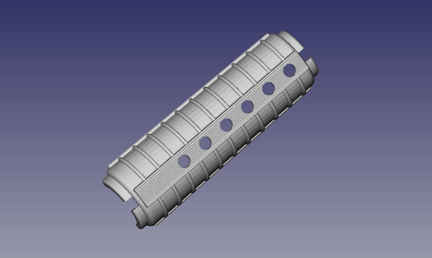

On my list of projects is a hand guard to cover a 10.5" barrel out of weed trimmer line, dying it black afterwards.
nitewatchman
Posts: 624
Location: Birmingham, Alabama
Re: Should I print this?
Post by nitewatchman »
Mac
Something like this?
I find it easy to modify the length by cutting it into three pieces with Netfabb, throwing away the center, positioning the two ends on the bed with Repitier and then saving out the spliced ends as an .stl file. Makes it any length you wish.
M4-handguard_half.stl
(2.68 MiB) Downloaded 373 times
