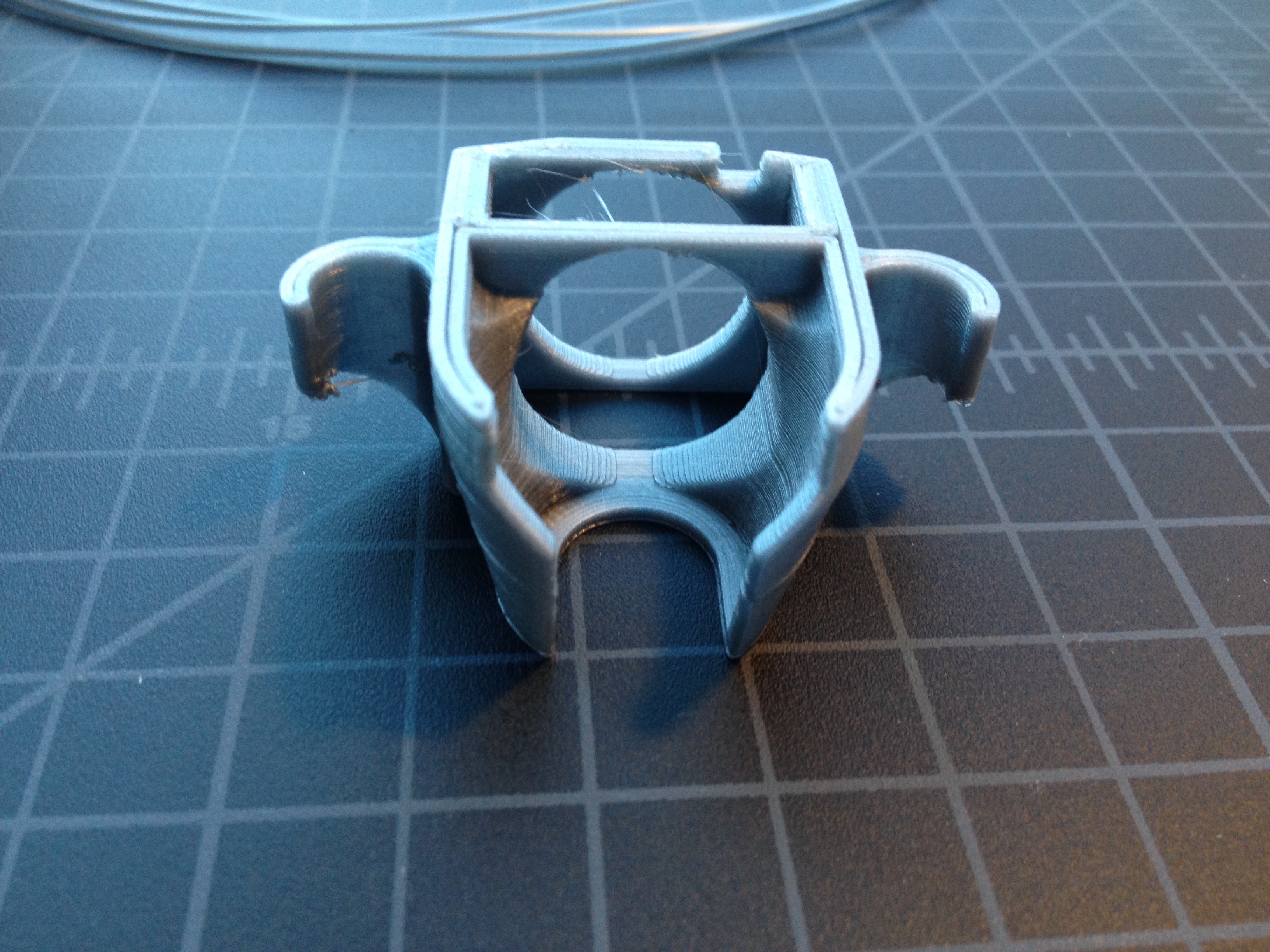

A weird thing happened when I turned on the machine for the first time:
So I uploaded a video detailing the entire first print process. I added some pictures below to summarize it if you have a short attention span.
I am very happy with the Rostock MAX V2 and the build process, to say the least. It was a fantastic time putting it together, and the first print was even better than I could have imagined.
Thanks SeeMeCNC and Gene!
