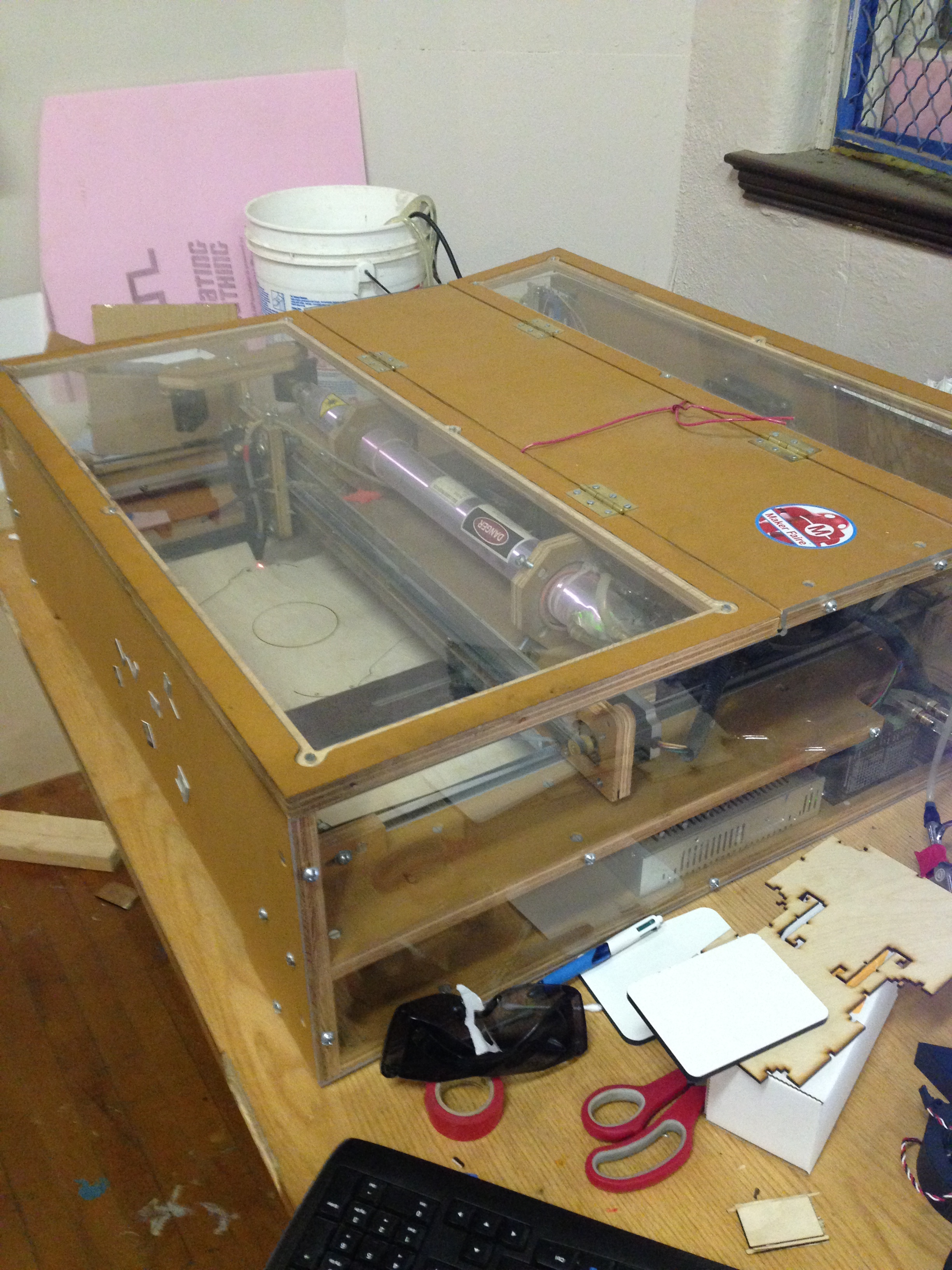

I was at my local Makerspace yesterday getting the bed plate cut out. Our 40W isn't powerful enough/calibrated enough to cut 1/4, so I had to use some 1/8" plywood. Counting on the glass to remain flat :D

You could have cut two pieces out of 1/8th, and then epoxy the two together,,,,,

I was going to do that, but it was 11 at night and I still had to go out to eat :P

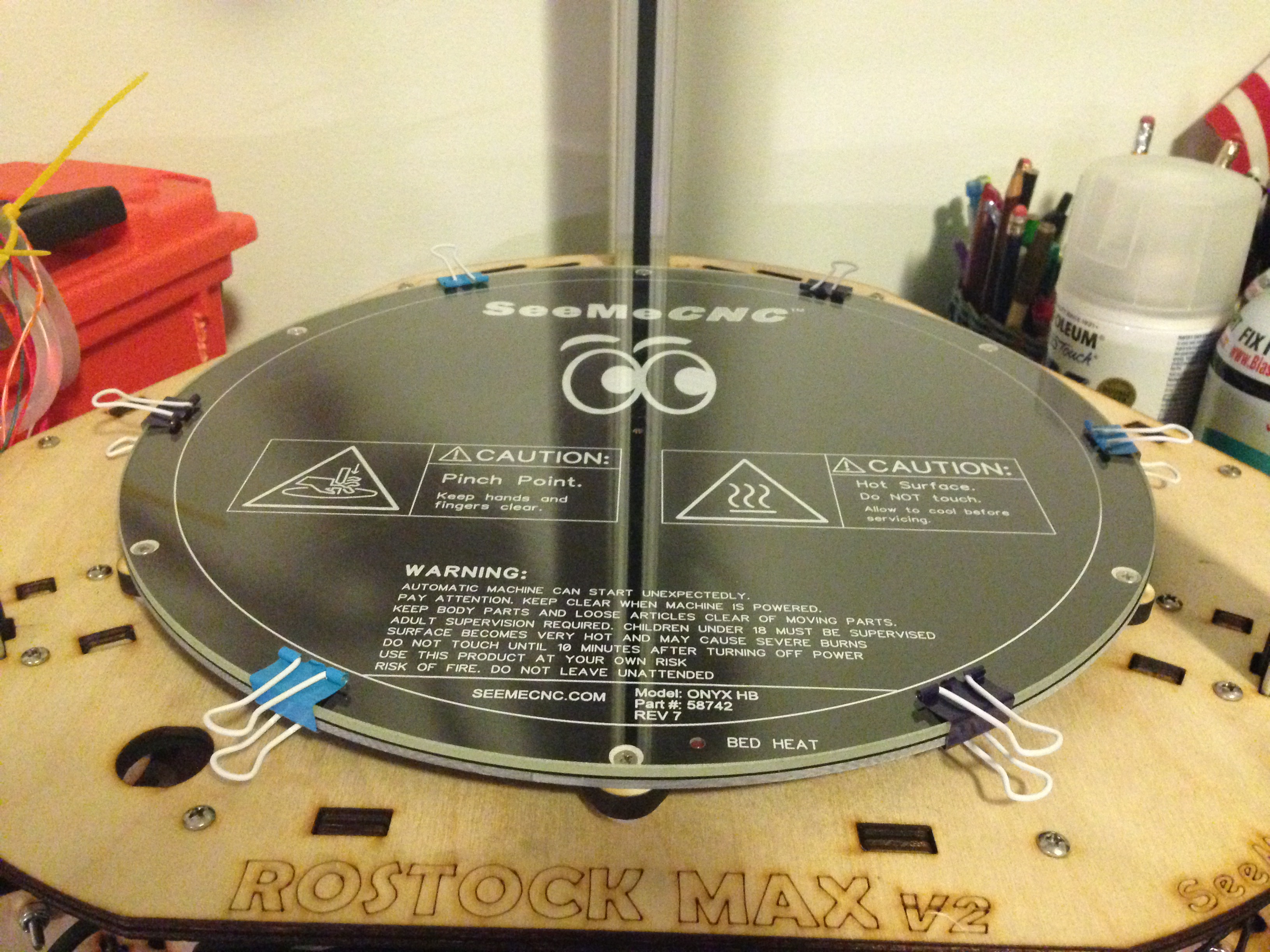

I ordered the Onyx Rev7 and it arrived today. Got it all soldered and everything and I mounted it on my machine.

I had a spare EPCOS 100k thermistor laying around so I used it (its larger and the leads are thicker) instead of the included NTC 100k thermistor.

I miss the way they did R3(?)-R6, with the 2 LEDs. I liked the hotend status LED. Oh well.

Its all mounted up! I still have to plug everything into the X3 Pro, which I will do tomorrow night. Looks pretty nice, though now I am really nervous about breaking that glass... Garolite is nearly indestructible on a 3D printer, and slamming the hotend into it wasn't horrible (not that I've ever done that...)
