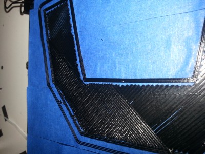

Hey All, I was a terrible customer and completely ignored my build thread in my excitement to get teh Max up and running, after some teething problems with calibrations and finally zeroing in on what i consider at least passable quality prints, i have run into a problem. larger prints are experiencing a situation where the perimeter passes do not meet the infill. In fact at the worst locations i can see completely through to the heated bed. Is this speed, filament diameter, layer height? Otherwise the troubles have just been figuring out retraction to clean up prints and how to speed full print cycles. i have gotten the bed as flat as possible, though the acrylic warps terribly in the middle in some situations, not overly happy with that aspect of things as heat, time etc all makes for a print that is not completely flat, instead crowned.
That being said, the max is a wonder of DIY engineering and im quite happy with the results so far. I am heading out now or id post a picture of the issue, and will do so when i return. Please Help!

Assuming the generated GCode is good, the most likely culprit for the fill not reaching the edge is backlash, which is usually a function of the belts not being tight enough.
I use predominantly kiss slicer where I do set the edge/infill overlap to 75% but I don't get gaps at the edges.

Thanks Polygonhell, ill try the belt tightening route and see how that works. I may also experiment with kiss slicer as well if eliminating backlash does not solve my problems.

With the Rostock MAX, I _seriously_ doubt belt lash is a significant contributing factor. Mine have been tight as guitar strings from day one and I've got (or HAD!) horrible infill problems.
I printed my best infill yet the other day. I used Cura with an infill overlap of .8 (80%). The Slic3r guys really need to add this option.

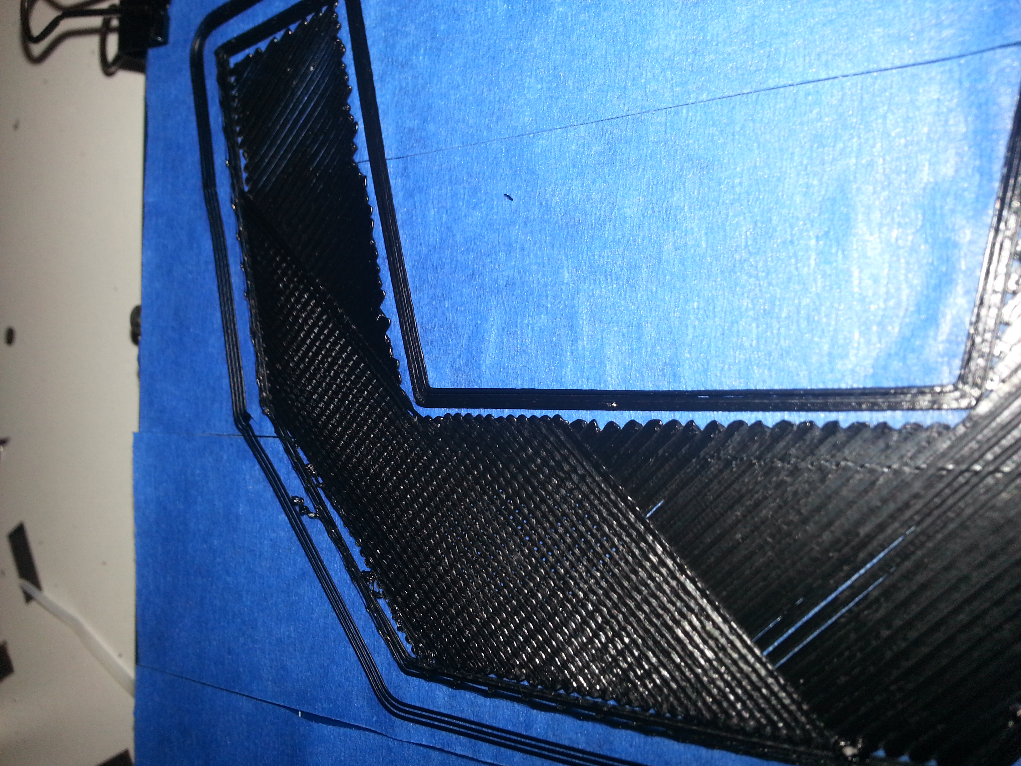

Okay so this is even more apparent in its severe detachment (perimeter from infil) No matter what settings, the infill refuses to contact the perimeter, this is generally a problem around 100% of a print. obviously, as you can see, its closer in some areas and more prevalent in others, the gcode displays correct layers when stepping through them...please help ready to sell this thing!
I should also note that the perimeter is exactly sized as the model is built (built in NX 8, exported as stl and sliced with slicer both the included version and the new .098 revision exhibit the same problems. Someone suggested a switch to kisslicer which i am not opposed to but i have not come across a good setup tutorial on configuring for the Max. I also havent had much time to search out any kiss info either...Links would be appreciated, PM, whatever, desperate in CT.

Looking at that I'd say you are losing steps, or one of your belts or pulleys is slipping because the infill is overlapping the the perimeter on one side, but not reaching the other.
I'd check the screws on the pulleys first, use some loctite or other threadlocker to hold them in.
if it's the stepper skipping, it can be one of a few things
it could be mechanical, and there is too much resistance to motion on one of the columns.
It could be the stepper drivers set too aggressively or not aggressively enough, are you using a RAMBO or RAMPS?
It could be your trying to move faster than the steppers are letting you (turn down your travel speed in the slicer)

I am going to try the first few layers now running slower speeds and tightening the belt pulleys. This is a Rambo board, suggestions on settings for the motor drivers? When off, the print head can easily be move around, with no apparent binding, so I don't think that there is any mechanical hindrance to motion in that regard.

Assuming you've ruled out loose pulleys etc.
if you're using a RAMBO board, and you didn't change the default motor driver values in the firmware, I'd start by pointing a fan at the motor drivers.
You can turn them down in configuration_adv.h.

The driver values are at 195 as the stock setting, I moved to 180, no appreciable improvement in the problem, lower still? Whats acceptably low? Pulleys are all tight, verified no free play in cheapskates, belts are tight.

I'd start by trying to figure out which tower is skipping, it's likely the one in the direction that the infil is moving. If it's not obvious during a print I'd write test GCode to try and reproduce it.
After that, I'd try and figure out what's different.
I'd try dropping print speeds and travel speeds to really low values (10mm/s or less) to see if it is likely an accelleration or speed problem.
Unfortunately if it's loosing steps there are a few things it can be and all you can really do is try and isolate them, there is no magic this is the issue answer unfortunately.
One possibility I forgot to mention is if the head isn't moving parallel to the bed, and it's rubbing on the bed or the printed material as it moves, that can be enough resistance to cause one motor to slip.
I usually look at the GCode visualization, and compare it to what i'm seeing in the print, and look for obvious correlation, like the perimieter looks good and if the issue is as it appears to be when the infill starts, I'd look at the travel move before the infil to see if it's moving in the direction of the shift.

I've started down the path of understanding and solving this infill problem - see my build thread post.
It would be great if we could band together and print the same calibration thing and report our conditions and photos. I've create such a thing and posted it in my thread.
cheers,
Michael
cheers,
Michael
Eliminating those Delta Rod Blues
Well, I solved my infill gap problem and suspect the "fix" may be generally applicable to others with gap problems. Here is a lengthy post (plus read a few leading up to this one): Don't Get Those Delta Arm Blues!
Basically, in my case, one stiff U joint was causing the problem. Imagine if you had 2 or more stiff U joints!
cheers,
Michael
cheers,
Michael
