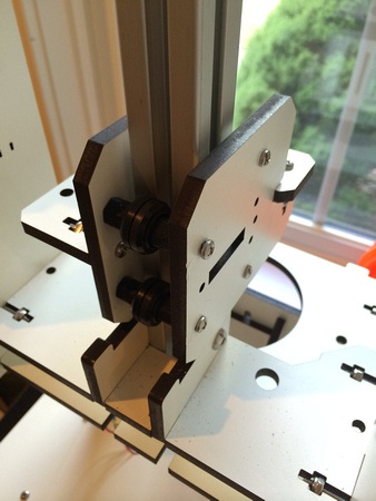

mhackney, the bottom holder for the extrusion is one layer too high.
The tabs on the "T" shape that received the t nut, gets sandwiched between the tray holder and next lower board. Notice the tabs cut out on both of those layers in your picture.

Re: mhackney's Beta DropLit build
Ah, good catch! That will lower the column significantly too. I think I can make that change without too much disassembly.

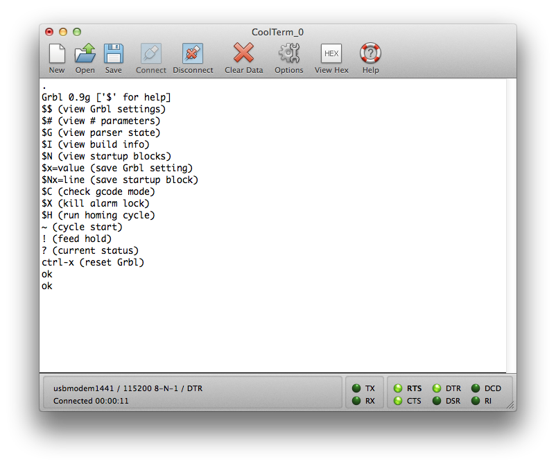

grbl .9g hex file configured for DropLit
All, here is the latest grbl firmware preconfigured for the DropLit and compiled into a 'hex' file that you can flash to the Arduino. It is pretty much "load and run" but if you need to tweak configuration you can do that with any host application and set parameters in EEPROM (but I have preconfigured defaults and if you wire your stepper and stop switch like I did, it should work out of the box). When you first connect (set baud rate to 115200) you will see a version string returned. It is "Grbl 0.9g-DropLit" for this release. At this point enter the command '$' and ht return and you'll get a list of commands grbl handles. $I returns the firmware version and info string. '$$' returns the list of parameters. To set a parameter you use '$N=XYZ' - you'll understand what this means when you see the '$$' output.
I've been using the Universal GcodeSender (v 1.0.4) that supports all platforms and is by the same author as grbl. But you can use Repetier, Prontorface or any other host or terminal app (CoolTerm is another good cross-platrform app to use).
Follow the information on the grbl wiki to flash the attached hex file - but first, remove the ".txt" part of the file name. It should be named grbl.hex when you upload. I use the command line method on Mac OSX and Windows 7 that uses the tools built into the Arduino IDE. The utility that SeeMeCNC posted on the DropLit github works well too but it's Windows only.
Once flashed, connect and then jog using normal gcode movement (Z axis only) or the Z +/- buttons in the host application if it has them.
Although the grbl firmware supports a lot of features, the DropLit has minimal requirements - a Z axis stepper and a single end stop switch - so the configuration is pretty simple.

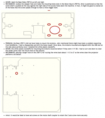

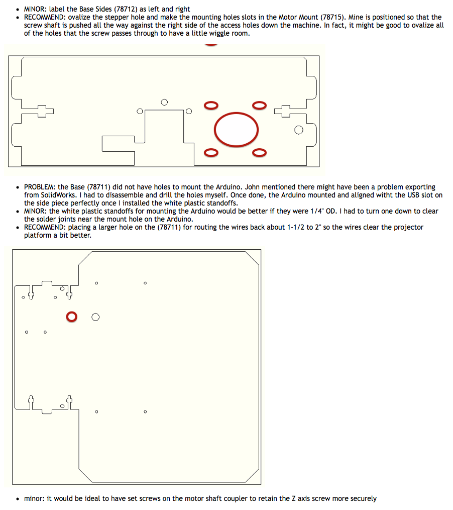

Lower T-nut mount update
As rgthane pinter out On Monday, I had not installed the lower T-mount extrusion holder in the proper place - doh! I had to do a little disassembly to get it int the right place and thank heavens for holes in the cabinet sides that allowed me to use an Allen wrench! Here's the proper placement:
