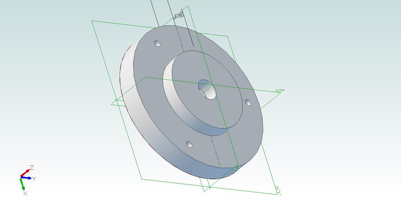

I just made a Jhead mount. Try it out and see if it works for you.[img]http://i1102.photobucket.com/albums/g446/davidflowers1/utf-8BSU1BRzA3OTMuanBn.jpg[/img]
jmount top.stl
(488.77 KiB) Downloaded 449 times
jmount top.stl
Jmount.stl
(596.75 KiB) Downloaded 586 times

Re: Mounting a JHead to the standard effector
Post by DavidF »
Maybe someone will find it helpful...
