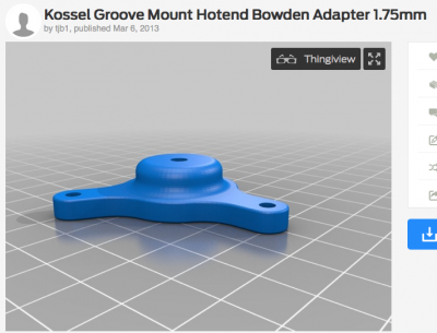

I figured out a solution but I haven't quite been able to execute it. I'm using this E3D Mount and there's enough space on the bolts above the top plate that I could slip on another one of these pieces with threads to accept one of the bowden tube couplers. I tried converting the STL back to an object file to make the center hole smaller but I don't know how to convert the faces back into closed polygons.

Here's one I used for my E3D-V4 that was before they had a bowden option.
http://www.thingiverse.com/thing:57889
Edit: Another option is you can get a Bowden V5 heatsink for $23.95 from Filastruder here. If you don't have it, you'll need one of E3d's Bowden couplings which you can also get from Filastruder. The threaded part of the standard RMax bowden coupling is too small.

I would just print out the top part of http://www.thingiverse.com/thing:57889 and use that instead of 626pilot's top piece.

So I printed it and (with effort) screwed the threads of a pneumatic coupling into it but while just testing the extruder feed the coupling popped out. I fired up my soldering iron and heated up the coupling while screwing it in again and it's staying put for now but I'm not confident it'll hold. What did you guys do to mate the pneumatic coupling to the unthreaded, plastic top piece?

Ideally you would use a tap that is the size of the PTC to make the threads in the plastic.

Or you could use a 5mm heat-set insert.

I used a 5mm tap for the standard SeemeCNC push-to-fit coupling as Eaglezsoar suggests and haven't had any trouble with it popping out. The heat-set insert is an even better solution, especially if you take it apart often.

If your using the SeeMe push fit connectors, you can get away with just running an M5 screw through the plastic to establish the thread, a tap might be marginally better, but the plastic is soft enough a machine screw will do the job.

I was able to use a socket set on this pneumatic coupling from one of the newer SeeMeCNC hotend kits, which allowed to apply enough pressure and torque to thread it into the ABS part. Yay! Thanks everyone :) loving this E3D hotend already. (And yes I know the blue-printed parts are awful. They're from that very Rostock which badly needs a belt tensioning. The yellow part came off my Orion.)
