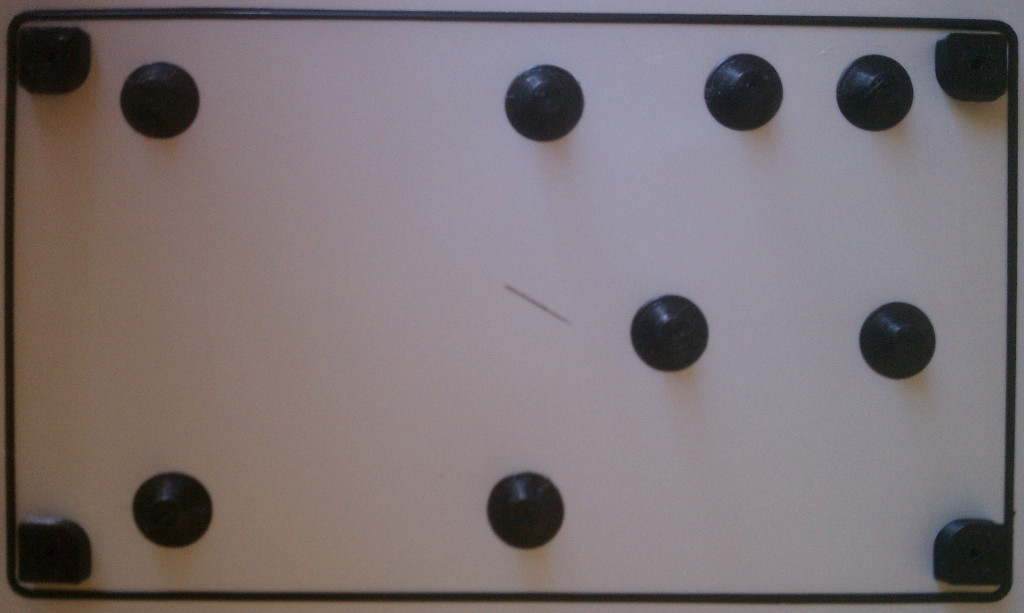

I had some "styrene" from a hobby store I purchased a while back.  I figured it would work for a good test.  It is quite possibly ABS to begin with, but the packaging does not say.
The bonding of the plastic seems to be very good. I had to use ABS slurry to make the styrene stay on the heated bed. I just put it on the edges. The ends of the styrene were held down with the paper clips that come with the Rostock. You have to tell Slic3r in the Printer Settings to offset the model from the bed. Repetier host will not offset the sliced model using its settings BTW. In my case it was 0.082" as measured with a caliper. The packaging says it is 0.080". I figured that is pretty darn close.
Here is my print before: Here is my print using the styrene plate: It is practically a night and day difference. The print to styrene looks very nice indeed. Yes, my own printed plate could look better and I am not sure why there are seams. However, the print to an existing plate takes so much less material and prints much much faster. I do have to cut out the plate, but that is just a straight edge and razor. So four cuts.
Edit:
Nooo, it is not bonding well to the styrene. I need to experiment with the first layer temperature and possibly slow it down to get the ABS to bond well to it. Darn!
Edit:

I was just reading this (cool idea by the way!) and I would have thought the same thing. Maybe you could jack up the temp of that first layer a fair bit higher to get that better bond. I was going to even suggest using a lower than normal Z0 to get that extra temp onto the surface of your material.Demolishun wrote: Edit:

Yeah, I was going to try hiking up the temp.  I tried it 235, I think I will push 250 maybe and try going slower on the first layer.  That should increase the heat on that layer and make it "linger" to melt the styrene.  I love the idea of dipping too low to force it to melt into the material too.  Thanks.  I think if this were true ABS it would have worked better, but I think it is trial and error to see what works for what material.  If this can be made to work then every hobby store that carries this is potentially going to be a source for 3D printer people.
