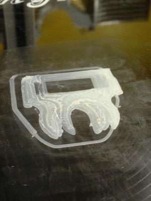

I'm very near the end of a Max build, and everything has been going well until I got to printing the first fan shroud.
The first layer goes down fine, but then the next layers shift about a centimeter to the right. It looks like the nozzle isn't traveling up for the next layers, and is just dragging on the first layer until it gets dragged off course. The slicer settings are the recommended abs settings. I checked and loosened up the cheapskate carriages, and tried to get all my belts tightened to the same tension. The joints on the arms seem to be good, and bearings and pullies seem to be ok as well. Any other ideas on how i should proceed?

I think your assessment is correct - the head isn't moving up after each layer.
It also seems like your first layer is pretty squished too, perhaps the Z height is incorrect? Have you run through the LCD Z height calibration? Just a thought but it could be that it is actually moving upwards but since it started 'below' the bed height it's just printing a z=0 for a few layers.

Still no luck. I recalibrated z hieght from LCD, and the first layer looked good, less squashing of the material. I tried to let the next print go to see if it would recover eventually, but each subsequent layer falls to the right. Should I just try the full calibration for all the towers again? I also re-sliced the file, and have tried printing from the computer and just from the card. Ideas?
Re: First print fail
This looks like a classic example of slipping belts or pulleys. Make sure the pulleys on each of the steppers are secure and that the belts are tensioned properly (per the manual) and are not slipping.

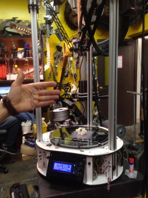

OK, so I found another problem--my belts were threaded incorrectly around the bottom, and after correcting this, the skates move so much better, and I thought surely that was the issue. Over the weekend I reinstalled and set up Repetier from scratch, calibrated again,tried slowing down the prints on the non printing moves ( to perhaps diagnose any slipping). Printing slower, the print is better, and does seem to be lifting for each layer, but each layer shifts to the right. Nothing I do seems to affect the problem. I tried printing another file, with the same shifting results. Anyone have any other suggestions?

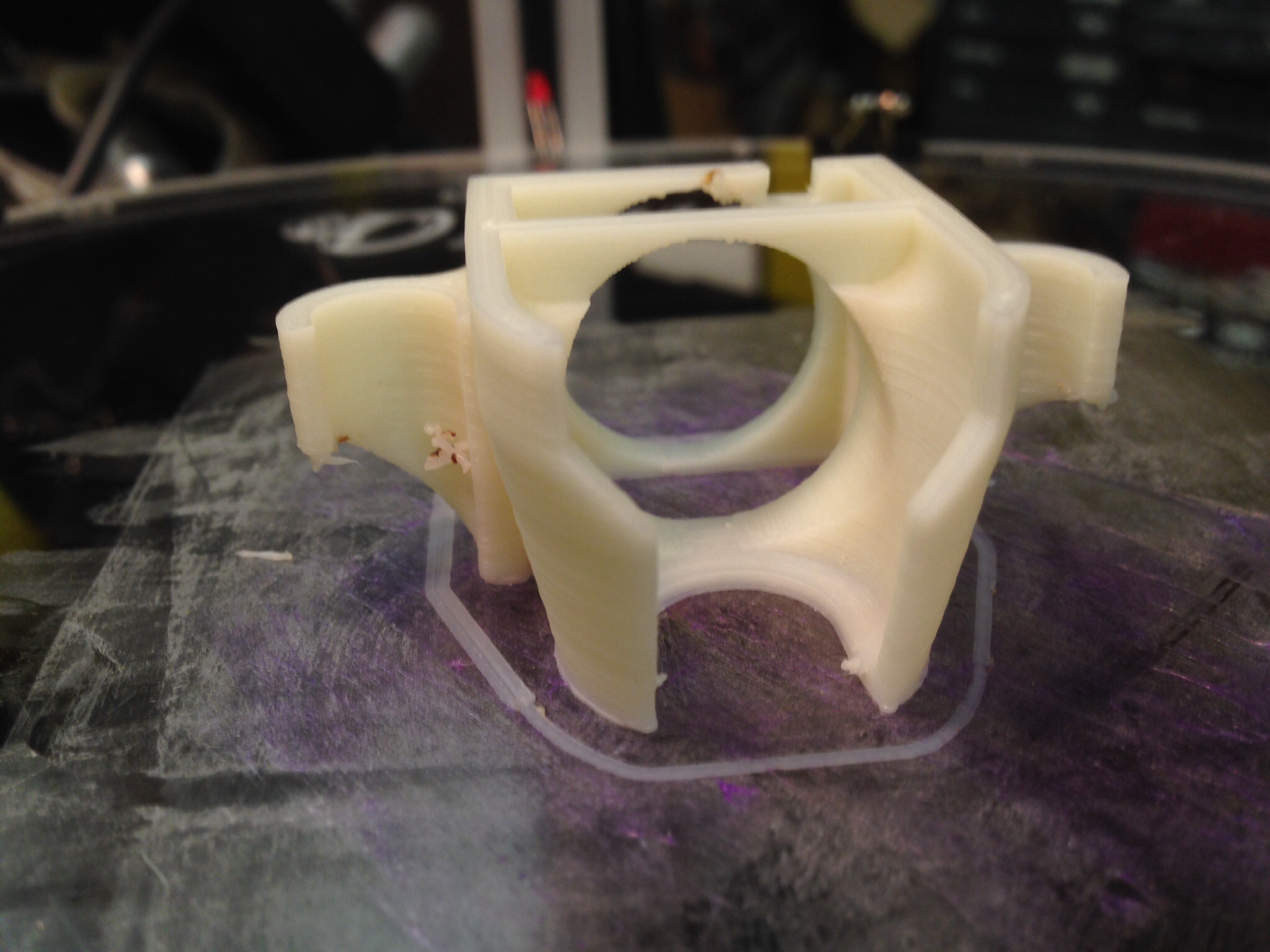

Solved!
After much forum searching, found this topic:
http://forum.seemecnc.com/viewtopic.php ... set#p29972
That's it. The ezstruder stepper was wired and routed along side my y end switch, causing the stepper to pause and throw everything off. In the end, I'm glad it happened, as it forced me to examine and clean up my previous work.
Thanks everyone for help. Prints are coming out great! Second pic shows wire( now hanging outside machine. Was thinking of leaving it as a battle scar, but will probably rout it thru another tower soon.
