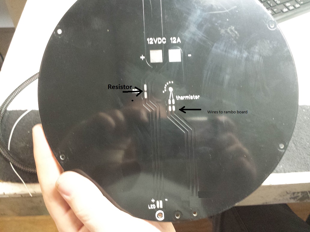

geolupulus wrote:Photos of the V3 rostock max heated bed!
OK, that's different, but it makes sense. Here's my guess as to the connections:
- The two large square pads are for the main heat input
- The pair of small oval pads near the edge, near a small hole through the surface, are for the power LED
- The second pair of small oval pads that are near the main heat pads are for a current limiting resistor for the LED (note that the resistor will be in series with the LED)
- The two parallel pairs of pads nearest the center hole are utility pads, connecting to nothing. The thermistor installed in the center hole is soldered to the pair closest to the hole, and then you attach the thermistor wires that go to the RAMBo to the adjacent pair.

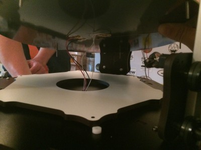

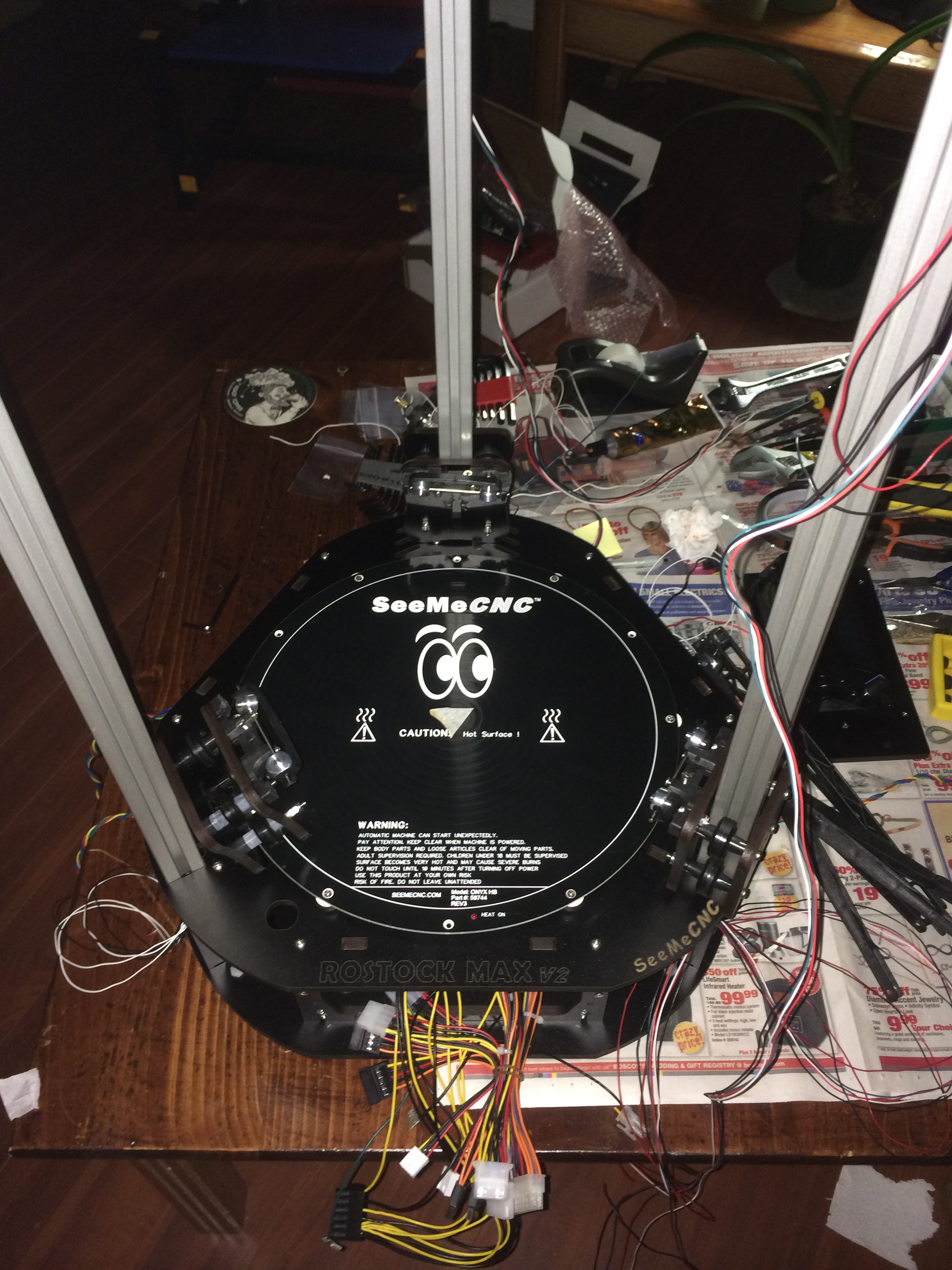

Thanks a lot dtgriscom! I have taken your advice and soldered as you suggested. I took plenty of photos and will upload them if everything checks out when I complete the build and turn the printer on!
New heated bed notes: (Based on differences in the old manual and our experience installing the new heated bed last night) The manual showed to rout the wiring out and over and around the snowflake mounting plate, now that the wiring connections are toward the center of the heated bed, it is much neater to just rout the wires straight down, through the center of the snowflake and then into the base.
Also, make sure the heated bed is aligned correctly before you start screwing it down, we didn't initially realize there were 12 holes on the bed and had to unmount the heated bed because the LED was between the bottom of the bed and the top of the snowflake. Luckily there are only 6 mounting locations so we just rotated the bed 30 degrees and it was good to go.
Bed aligned correctly
Wire routing for new V3 heated bed

quick and crude, but since the new heated bed is like the orion one, I made a pic to help people with what wires go where on the bed...

guanu wrote:quick and crude, but since the new heated bed is like the orion one, I made a pic to help people with what wires go where on the bed...
Well, I'm a bit confused by your picture, presumably of an Orion bed. The "thermistor" pads clearly have traces leading to them from the edge of the bed, which contrasts with the updated MAX bed, which showed none. If those traces are attached to another circuit on the bed then my above guess is wrong: they aren't just isolated utility soldering locations.
... anyone know the truth?
Dan
well considering I work at seeme, I know the truth... that pic was from an orion bed we dont currently use, and thoes traces should be ignored since they arent used, thats why I labeled what is used where, and since it had the silkscreen for + and -, I thought it would be easier.. so ignore the traces that arent used and not labeled from the pic...

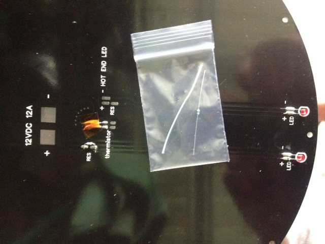

I have a question about the Onyx Headed Bed, Rev3. in the Rostock MAX v2 Assembly Guide.
The kit came with 2 LEDs an 2 Resistors.
I installed the LEDs.
Where does the second Resistor go?
It’s not in the manual.
I also have a picture of the bed.
Can you help me?
Thanks,
Ron
guanu
SeeMeCNC Staff
Posts: 392
Post by guanu »
second resistor goes where its labeled "RES" just like for the heated bed LED.... the resistor goes from the RES pad to the + pad.. and then the + and - for hot end led go to the hotend wiring on the rambo for the hotend... (with the rambo green screw terminals at the top, the first 2 spots are for the hotend, first - then +... just add the wires from the hot end led of the bed to the wires from the hotend to the rambo... this will have that LED light up when the hotend gets power)
