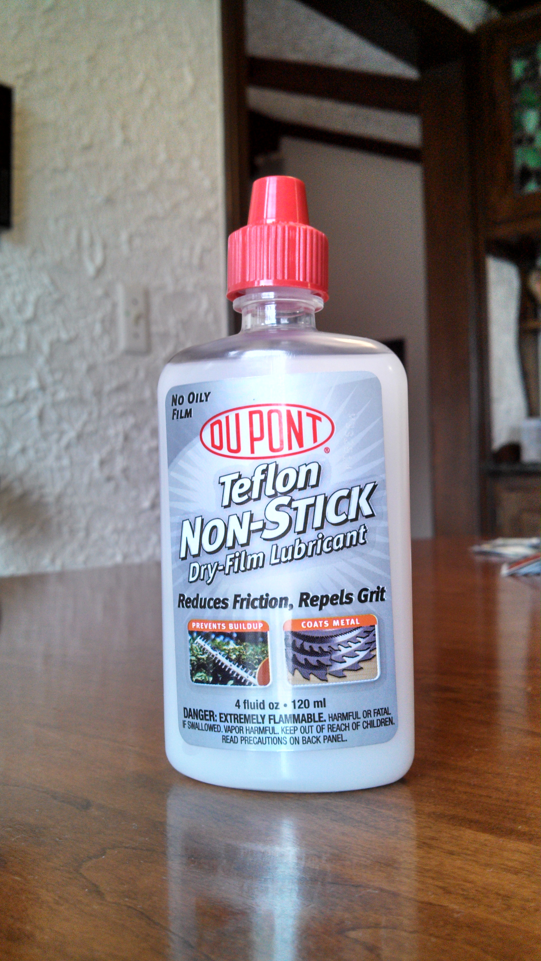

"You shouldn't need to lubricate the shaft, as they are nitride coated, but if you want to use a lubricant, make sure it's a dry lubricant, like ptfe powder etc..."
I think I'm going to get some pfte lubricant. I am also thinking about making a clip to go over the existing clip that would also cover the ends of the rod.to keep it from migrating. I'm open to other suggestions.

I picked this stuff up at Lowes.

I just want to report an update.
I've used that ptfe film on my u joints. I only use a tiny amount. I have not had any movement of the shaft at all. Seems to work well.
Re: U joint issue
I also removed the the u-joints and added some white lithium grease to the metal bearings where they connect to the arms, and also on the edges (they appeared to be rubbing on the sides of the effector platform). I did not add any lubrication in the middle of the bearing where the pins are positioned.
So far, so good. Since adding a bit of lubrication, the metal pins haven't moved a bit!
