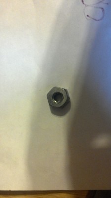

Spent a week trying to get all the axis aligned perfect, but one side of my z-axis was giving me a heck of a time. And I just couldnt get it to work without jamming, , tore it apart only to find the acme screw was drilled and taped off-center , at $2.00 a pop think the quality would of been better, but they all were of low quality, picked them up from mcmaster-carr , replaced it and now im able to get the machine going just fine. Lesson learned to always check the quality of your parts and not assume because of the supplier its going to be good.

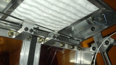

Here's a pic from the inside looking at the door mechanics
I am having a few issues with the bronze rollers and its not quite as smooth as I would like it, might have to change or improve a few things
as far as the space I do get the full length available, but the doors are at a 70 degrees slant, so if I did print a box the full length of the table 6" tall it would hit the doors at the front, but then I could just open the doors for the print.
