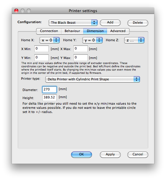

OK I've done all the calibration stuff and got to the step of opening up the peek fan shroud STL file, problem is I'm not sure why its dropping on the outside of the bed...
These are my printer settings...
Re: Error Following PID Autotune
In your printer settings tab, swap back to classic printer, and put in -100 for bed front and bed left. I think that should solve it.
I'd like to know about the offset as well. I was under the assumption that it definitely needed to be set as a Delta printer vs. Classic. I could be wrong. I ended up just using the translate values you see on the first image you attached, and centered it from a top view. Printing it now just fine with Aquanet hairspray on the glass. (The elmer's glue sticks did not work for me, for whatever reason.)
Sorry, I forgot to tell you to swap back to delta after. It's just a bug in Repetier so it uses the wrong value for the bed center.
Thanks, I'll try your suggestion and see if it centres it.Nylocke wrote:Sorry, I forgot to tell you to swap back to delta after. It's just a bug in Repetier so it uses the wrong value for the bed center.
