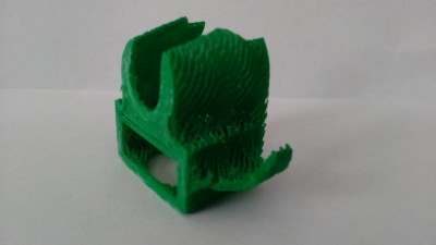

So for my first test print, the fan shroud.  I know the Z was too low to start off, but you can't tell that.  But I think it was just printing took fast.  It was default PLA.ini file from git, for the Slicer, on a Rostock V2.

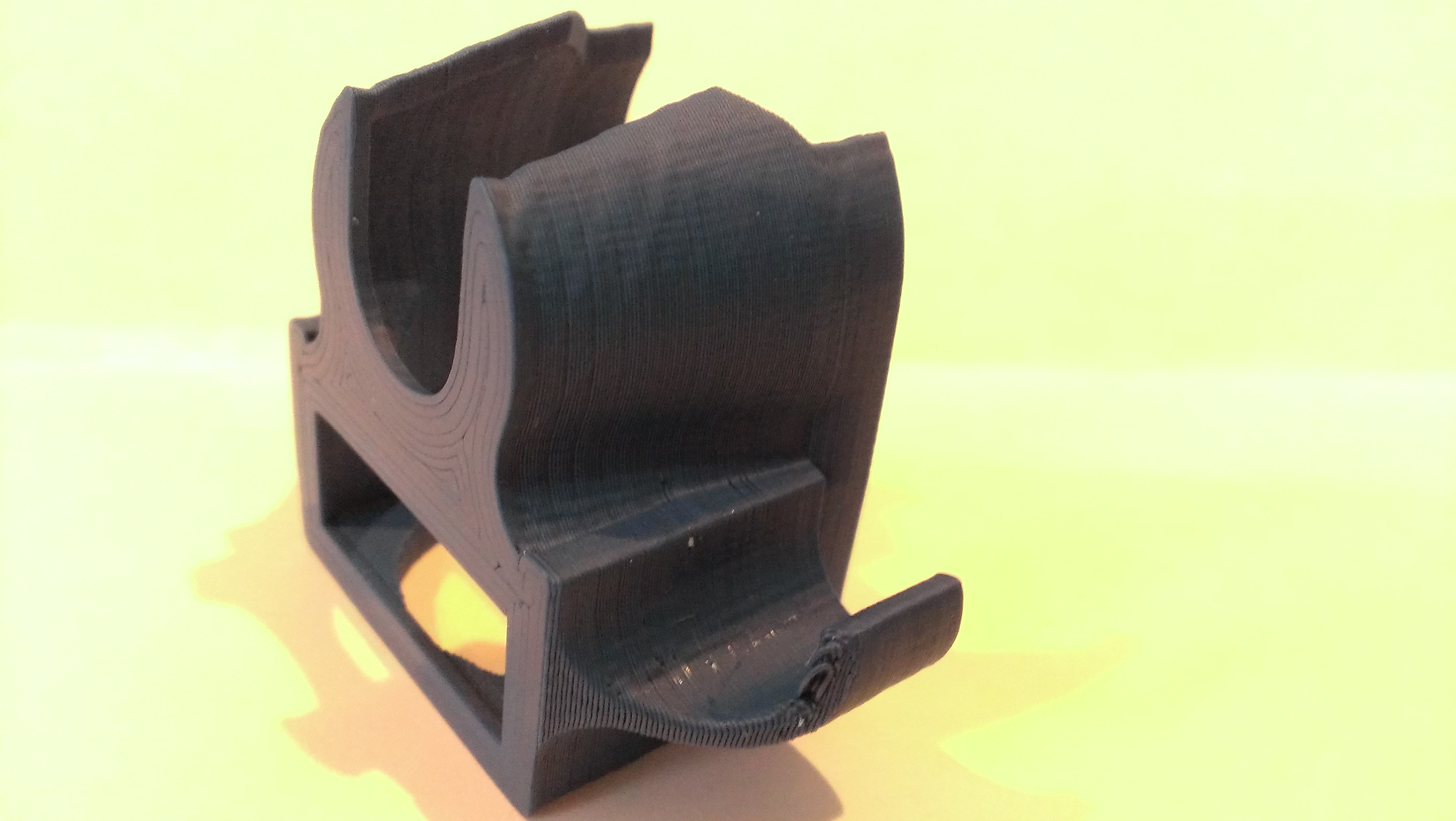

On the second try I slowed it down, and it already looks better.

I found that my filament settings had the filament diameter at 3.0 mm. Nothing like 42% fill on everything...

Now with the correct filament diameter.  Looks much better.  The areas having any bridging had drips, but the quality of the other surfaces is much better than I expected from a printer I just assembled.  And frankly a very quick calibration.
I suspect the temp is a little on the high side.

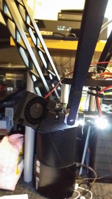

When you print in PLA, you need to cool the filament as it's being extruded. http://repables.com/r/212/ You should print this guy out of ABS and there should have been a squirrel cage fan that came with the parts. That's what it's for.
Ends up like so:
It will be slightly different for you as I'm assuming you have a V2. The fan shroud is slightly different. The link I gave above is the shroud for the V2.
Ends up like so:
