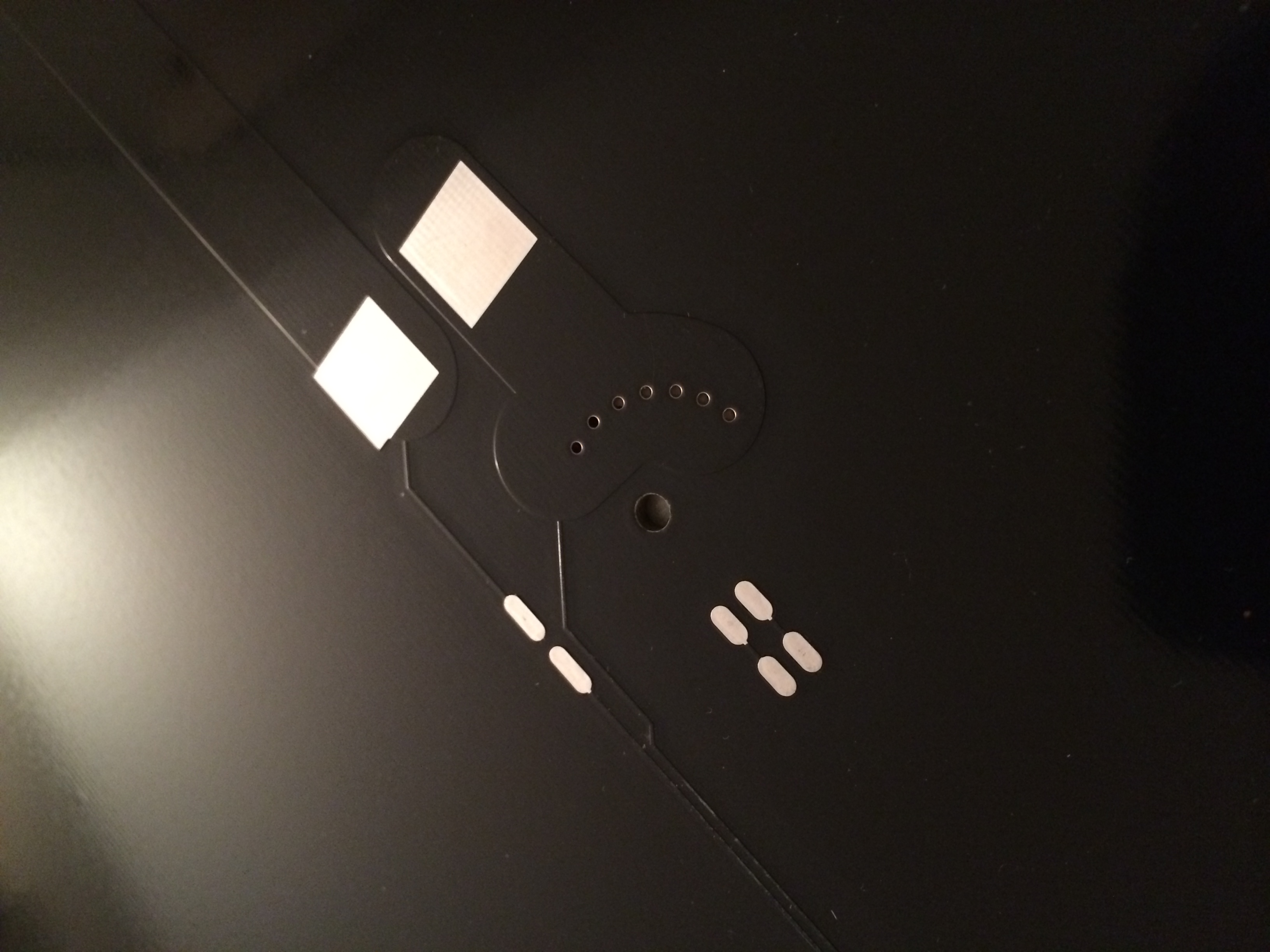

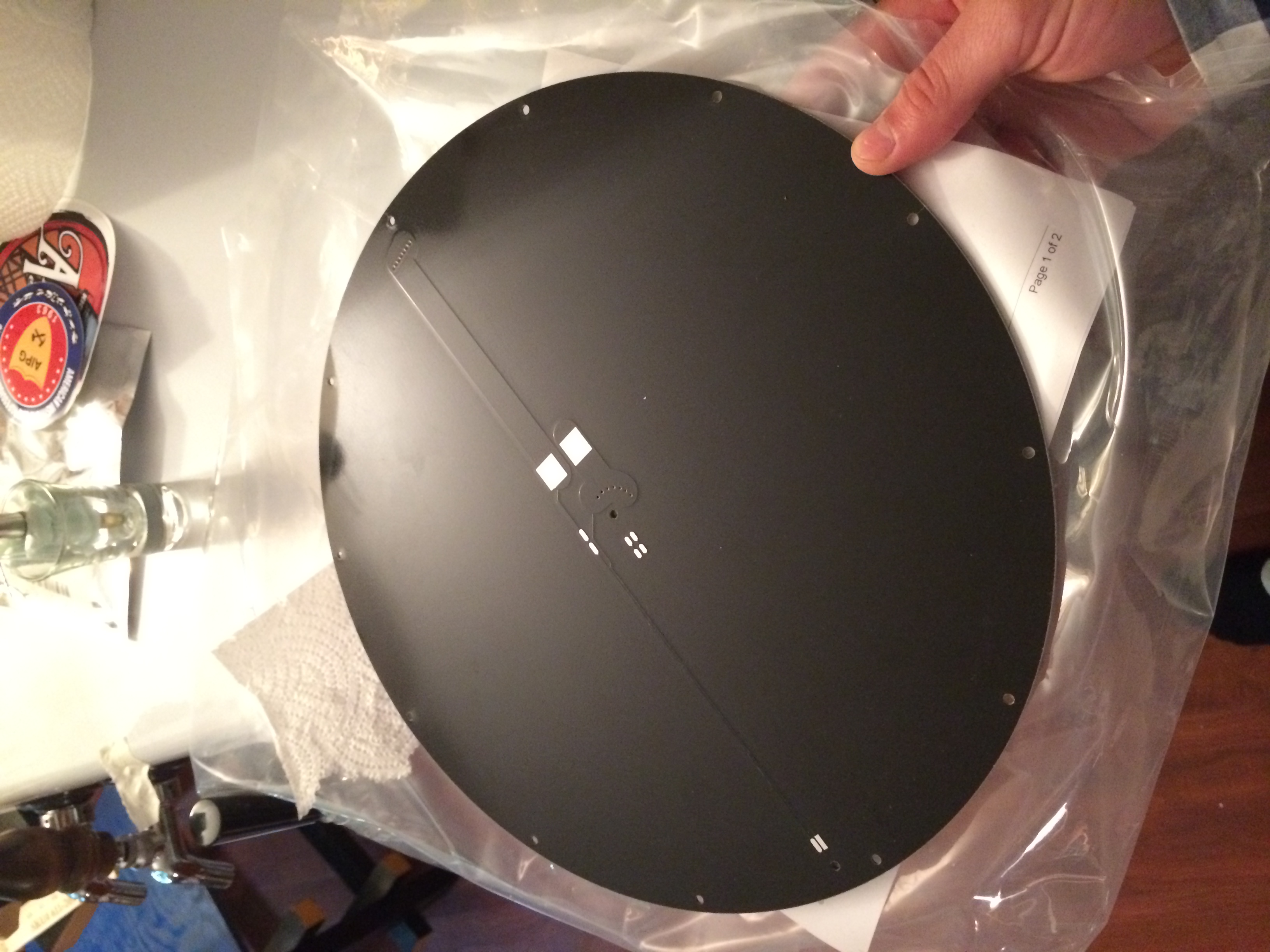

Received the new version of the heated build plate (one with the SeeMeCNC eyes on it) with my Rostock V2 that came the other day. The connections are little different than what's in the manual. Could you provide a little help with that?

geolupulus wrote:Received the new version of the heated build plate (one with the SeeMeCNC eyes on it) with my Rostock V2 that came the other day. The connections are little different than what's in the manual. Could you provide a little help with that?
Would you be able to post a picture of the terminal area (the bottom, where the connections would be made)?

dtgriscom wrote: Would you be able to post a picture of the terminal area (the bottom, where the connections would be made)?
I will take a photo and post when I get home tonight! Thanks
album: https://www.dropbox.com/sc/kub3w362uezglf7/zr959_EweL
Photos of the V3 rostock max heated bed!
