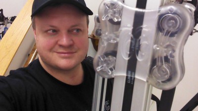

Re: Pingel's v2
geneb wrote:I really scratch my head at issues like this. I guess the photos are clear to ME and not anybody else. :)
When the new cheapskates come out, it'll be a moot point though. :D
Do you mean these cheapskates?
Posts: 5358
Re: Pingel's v2
Yep!
Prozac
Posts: 132
Joined: Thu Feb 06, 2014 9:45 pm
Location: kentucky
Re: Pingel's v2
Post by Prozac »
Damn those for some reason look really good and I dont even know what the improvements maybe , or is it just Eye Candy cause Im Hungry!.
Posts: 5358
Re: Pingel's v2
The assembly goes from 11 parts to 2, not including the bearings & their covers. No need to adjust eccentric cams as there's a "spring" built into the part that grips the rail properly.
