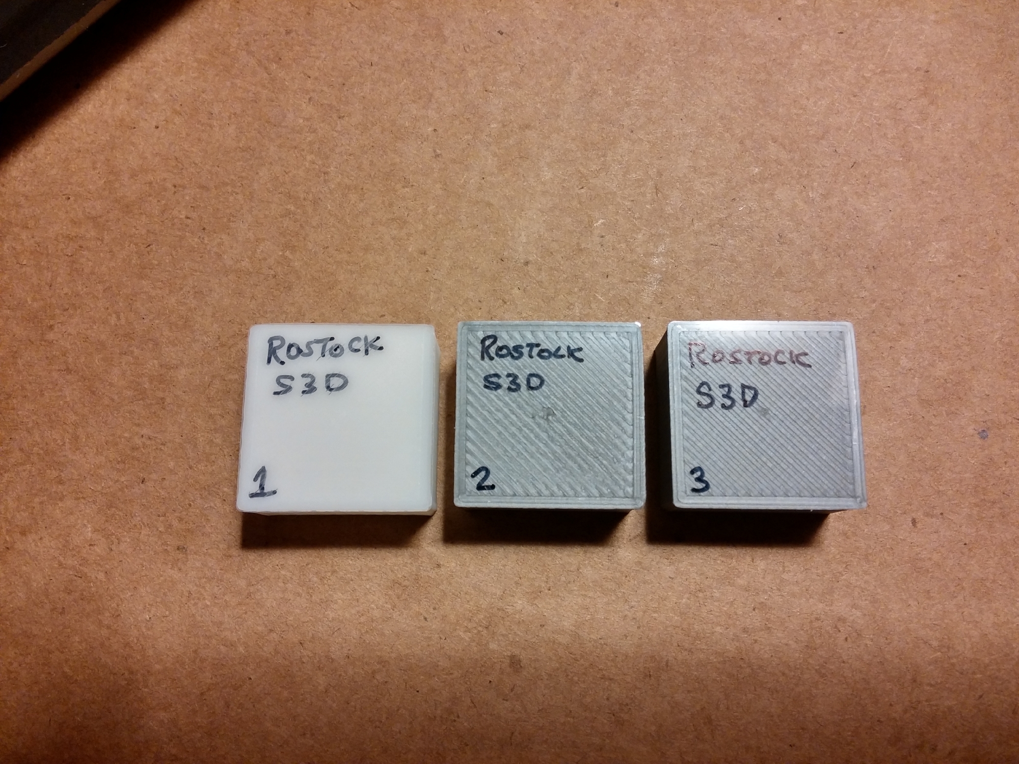

Alright. Here is what I have. The FlashForge parts where sliced with Simplify3D at .15mm layer height. The Rostock parts were sliced with Repetier/slic3r at .15mm layer height. I tried keeping all of the settings the same. I used the same roll of material (PLA from SeeMeCNC) on both. I'm wondering too if this is a case between different slicers, not just nozzle size. Notice the windows in the sides of the FlashForge parts. Simplify3D could not fill that really thin wall whereas the Rostock with a bigger nozzle was able to fill it.
Bottom View
Bottom View

Anyway, attached some pictures of my cubes that turned out well and my Simplify3D profile in case anyone would like to use it or critique the settings. The white filament was PLA from Filament Central. Very good stuff. The grey PLA was from SeeMeCNC. I have not printed ABS yet.

I got the .35mm nozzle installed this morning. My results are much better than my .5mm nozzle. I was thinking about drilling it out to .4mm but I'm glad I didn't. I'm still tweaking things in Simplify3D. I think what I have is pretty good right now. I've been playing with the layer overprint setting in the infill tab. Normally it is set to 15% and I have it cranked all the way up to 75%. This seems to help the top final layer layer close up to the sides. I can post my .fff profile if others would like to see what I have.
Also, I started playing with MatterControl today. I get pretty good results with both the slic3r engine and the cura engine. If I had to pick a winner I'd pick cura. There isn't diddly squat for settings like slic3r (or S3D) but it makes for some good prints anyway. It kind of reminds me of Makerware in that regard. Minimal setting to screw with and great prints afterward. I'm actually kind of sitting on the fence now between S3D and MatterControl/Cura. Perhaps tomorrow I can abandon calibration cubes and print something a little larger with much more detail for a comparison. Only so much time in a day.

Here's what I found today. I printed a pair of pliers from Thingiverse (http://www.thingiverse.com/thing:11816). I printed these on my FlashForge last night and brought them into work this morning for a comparison. Anyway, I printed 3 pairs of pliers on the Rostock using S3D, MatterControl/cura and MatterControl/slic3r. Overall, I got a better result with slic3r but really crappy top surfaces. Always something, right. On the other hand, cura is really really close. Cura handles those top layers wonderfully but extrudes much thicker lines. I don't see where I can control that. Even though I wanted S3D to win, I think it came out in last place on all of my comparisons. My FlashForge print blew the doors off of all three of my Rostock prints. I definitely have my work cut out for me. For now I think I'll use MatterControl/slic3r until I learn some new tricks. Anyway, pictures are attached for you to review. Perhaps y'all have some tips for me.

I'm sorry for the confusion. In a nutshell, I get better prints off of my FlashForge than my Rostock at this point in time. I want to change that. I feel as if I should be getting equal results, at least that is what I expected. I've seen prints from others. I know what the machine is capable of. The Rostock is an impressive piece of equipment and I get a little frustrated with myself when I can't figure things out. I'm still wondering about which slicer to use. I no more than settle on one and then I change my mind. It seems like everything that I have tried so far has at least one hiccup. I don't want to have to print 3 of every model using 3 different slicers just so I can see which will give me the best results.
These pliers take about an hour and a half to print at 40mm/s. I wish one of the Jedi Masters on this forum would print one and share the results (using there slicer of choice). Perhaps they could share their settings with me. Perhaps the gurus at the MakerHive could help too.

My tolerances weren't very close. Since I posted this I learned how to calibrate my towers with a dial indicator. My prints are much better now. Still not equal to my FlashForge but pretty damn good. I still use S3D as my main slicer. The prints on my Rostock are quite dimensionally accurate too. At this stage, I'm not complaining much about my Rostock. I still have to calibrate it often but I'm much faster at it than I used to be.

I kind of do that with S3D. On a .35mm nozzle I set it to .33mm and my extrusion width to .40mm. Kind of odd but I'm pleased with my results.

With a .35 nozzle, I'd run layer heights no more than .20. I use .15 or .1 for parts I run on the .35 - I want the finish, so I'm not terribly concerned about the speed.
