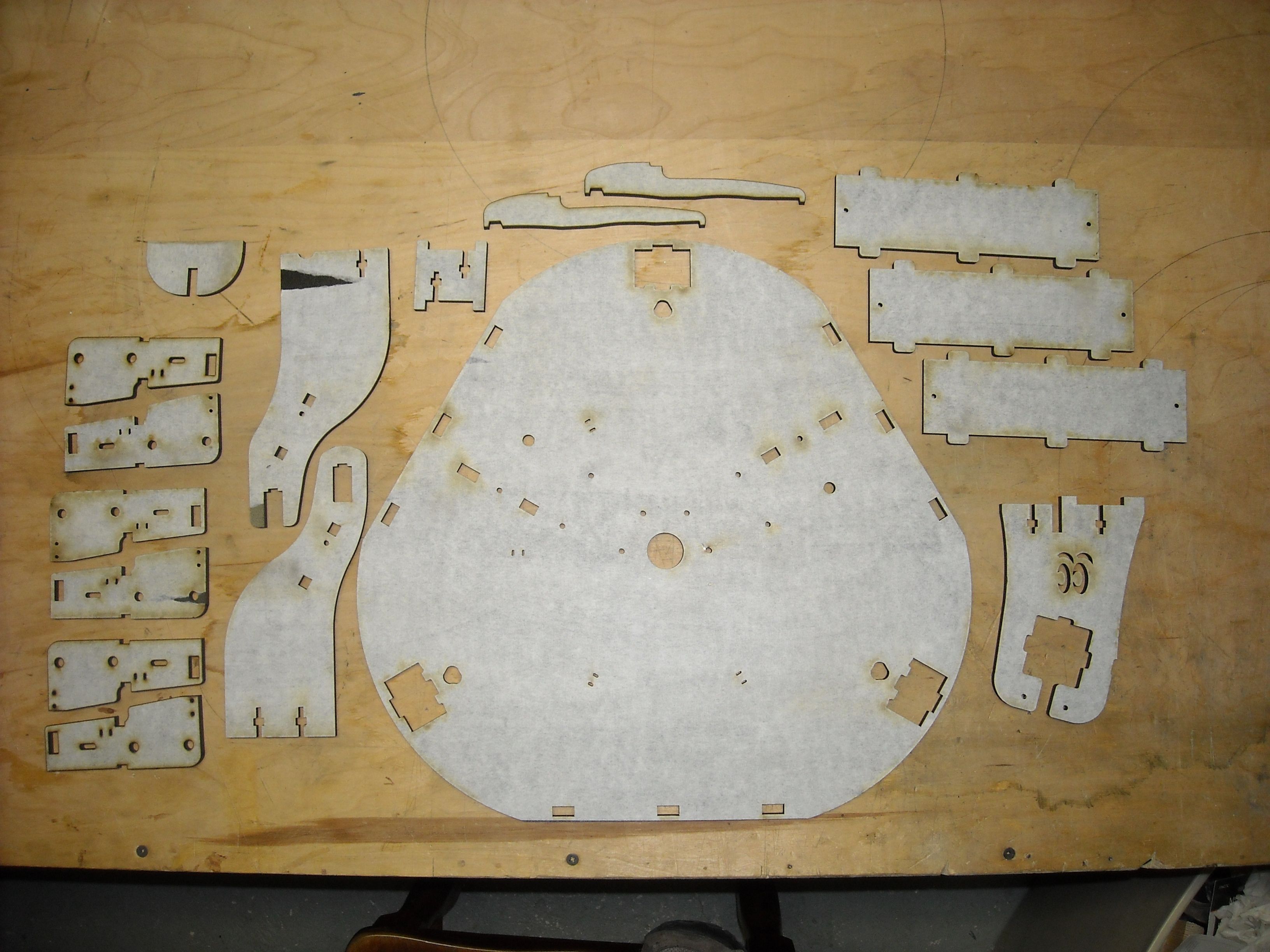

Here are photos of my kit's melamine sheets. It looks like SMC rearranged and spread things out a bit, which makes sense since the cost of the material is pretty minimal.
On the fourth sheet, I wasn't able to separate one piece, as the laser hadn't even penetrated the bottom laminate sheet. The laser kerf is too narrow for my #11 blade to get through from the top, and I'd be completely winging it if I tried to cut from the bottom. I'll be asking SMC for a replacement.
Gene, feel free to use the photos in your manual if you find them useful.
Dan
