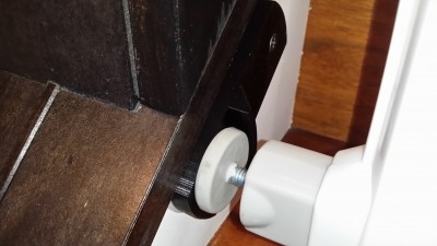

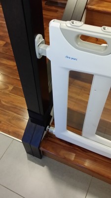

This was my first "real life" practical use for the printer. On my staircase, I have hardwood rails and didn't want to put screws in the wood, so I wanted to put them in the drywall. The drywall follows the staircase at a ~45 degree angle up and the holders that come with the baby gate are meant for a 90 degree installation. Now that I have a 3D printer, I figured I'd make up my own! It had since been sitting on 2 flat pieces of plastic and the rubber end on the baby gate would just slip right on by if there was any pressure on it. And this gate seems to be the one our kid loves to hang off the most and has taken a couple little spills because of the gate shifting.
I used Sketchup as I don't have a clue how to use the CAD programs. Even something this simple was a bit challenging for me, but I learned a ton just from going from prototype to final print.
My 'prototype' to make sure my measurements weren't out.  Lucky for me, everything was spot on.

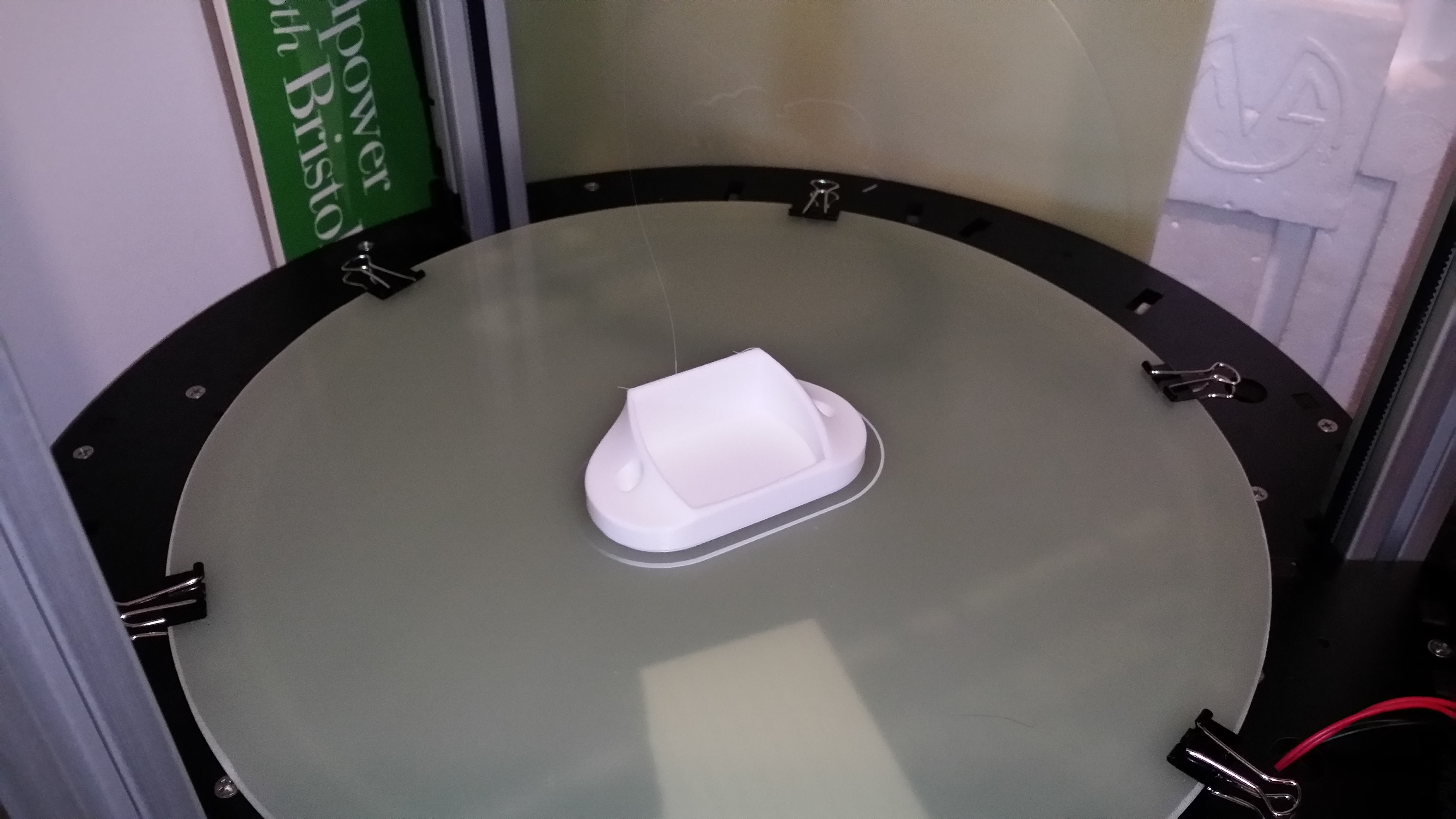

Final version fresh on the bed.
Counter-sunk holes and everything.  Super fancy.
Throw in some baby gate action and...
BAM!  Solid baby gate that doesn't swing around at the bottom.
Something simple, but it made my day.

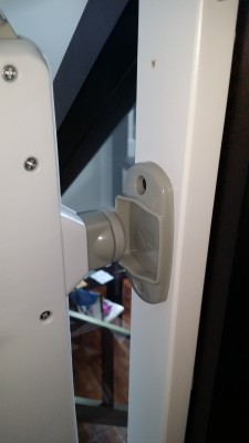

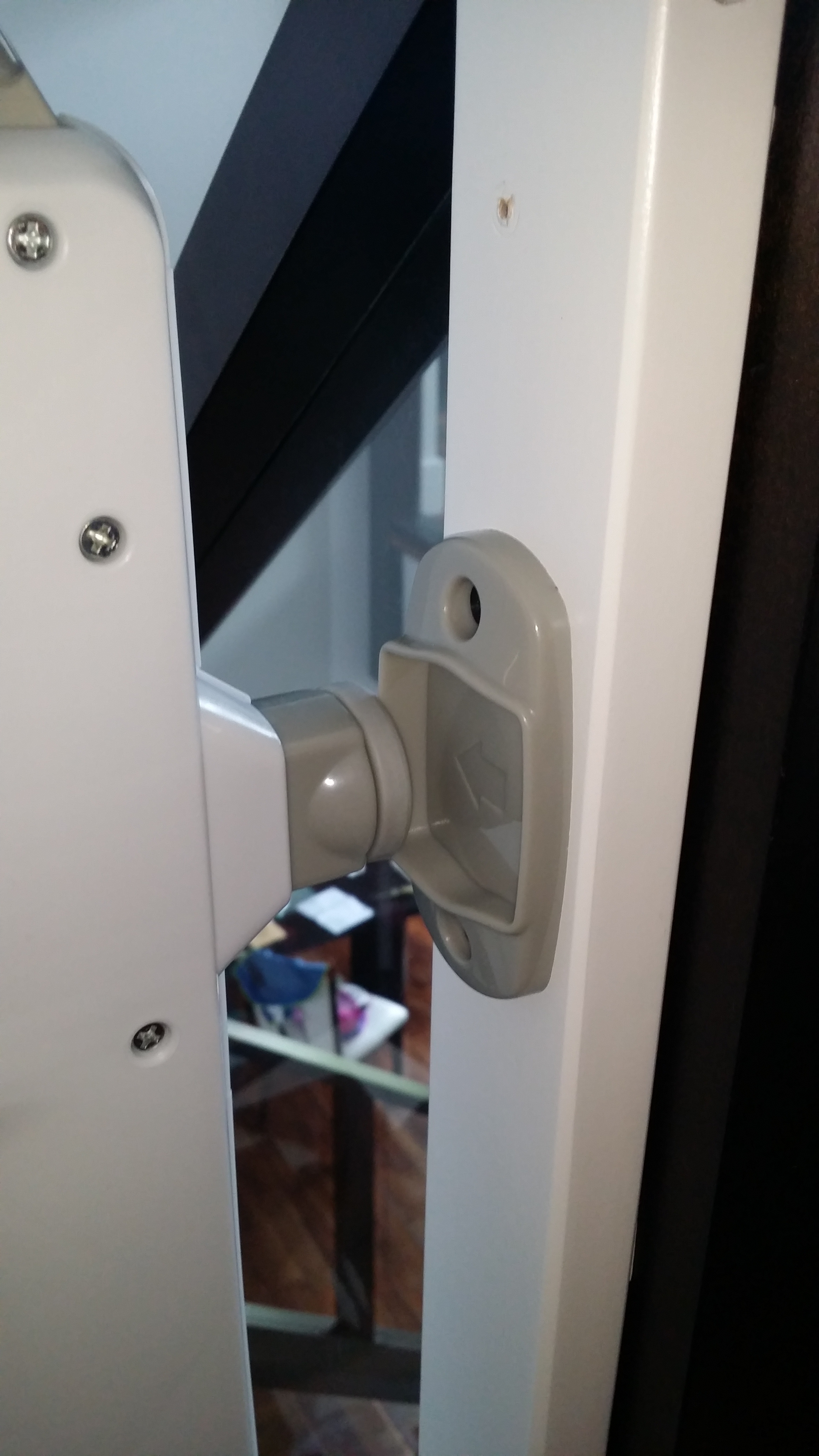

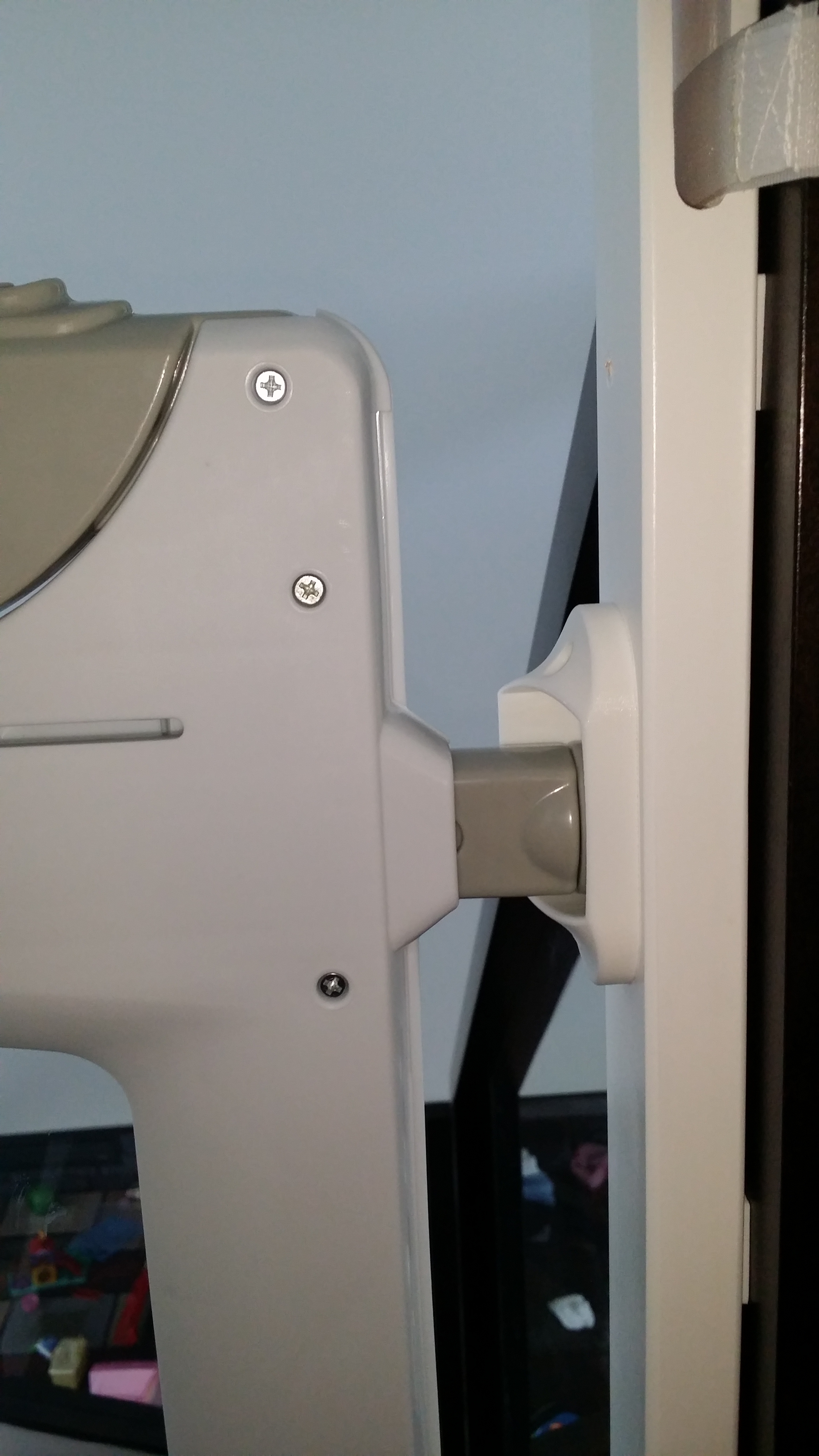

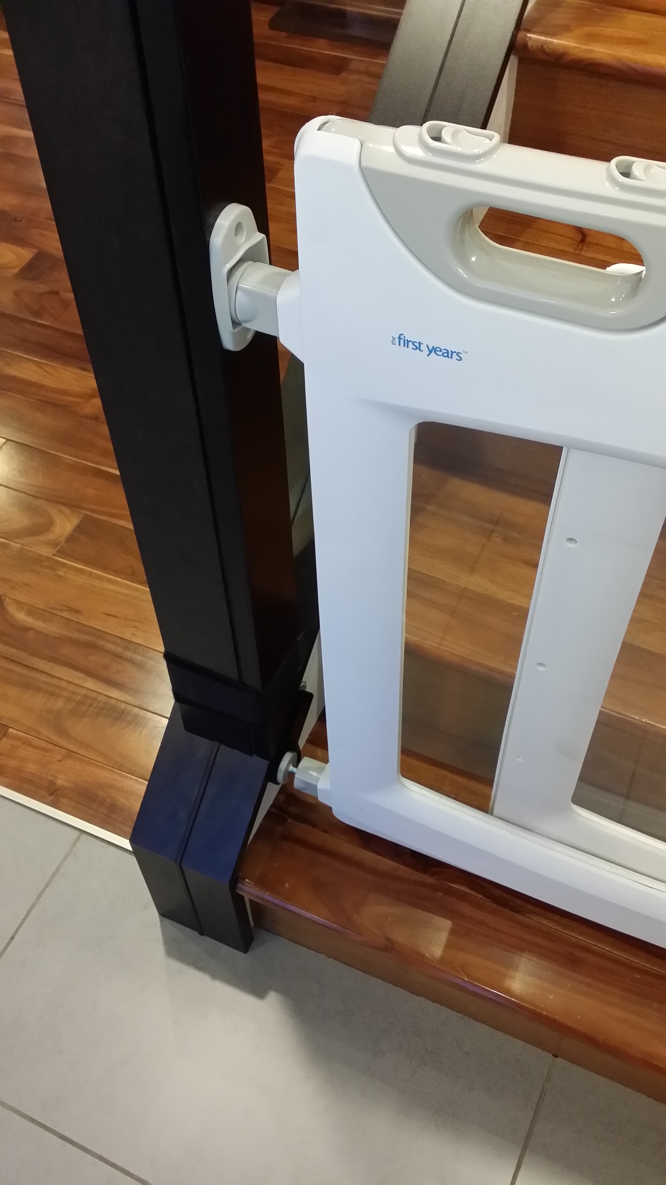

Well... here is another update to the baby gate situation.
We've put a gate at the top of our hardwood stairs. Our daughter, being a bit older, likes to help out by closing the gates. In typical 2.5yr old fashion, she slams these thing shut with all her might and pulls down the lever in an effort to 'help out'. This is the baby gate in question:
http://www.amazon.ca/The-First-Years-Ev ... B0000DBHHR

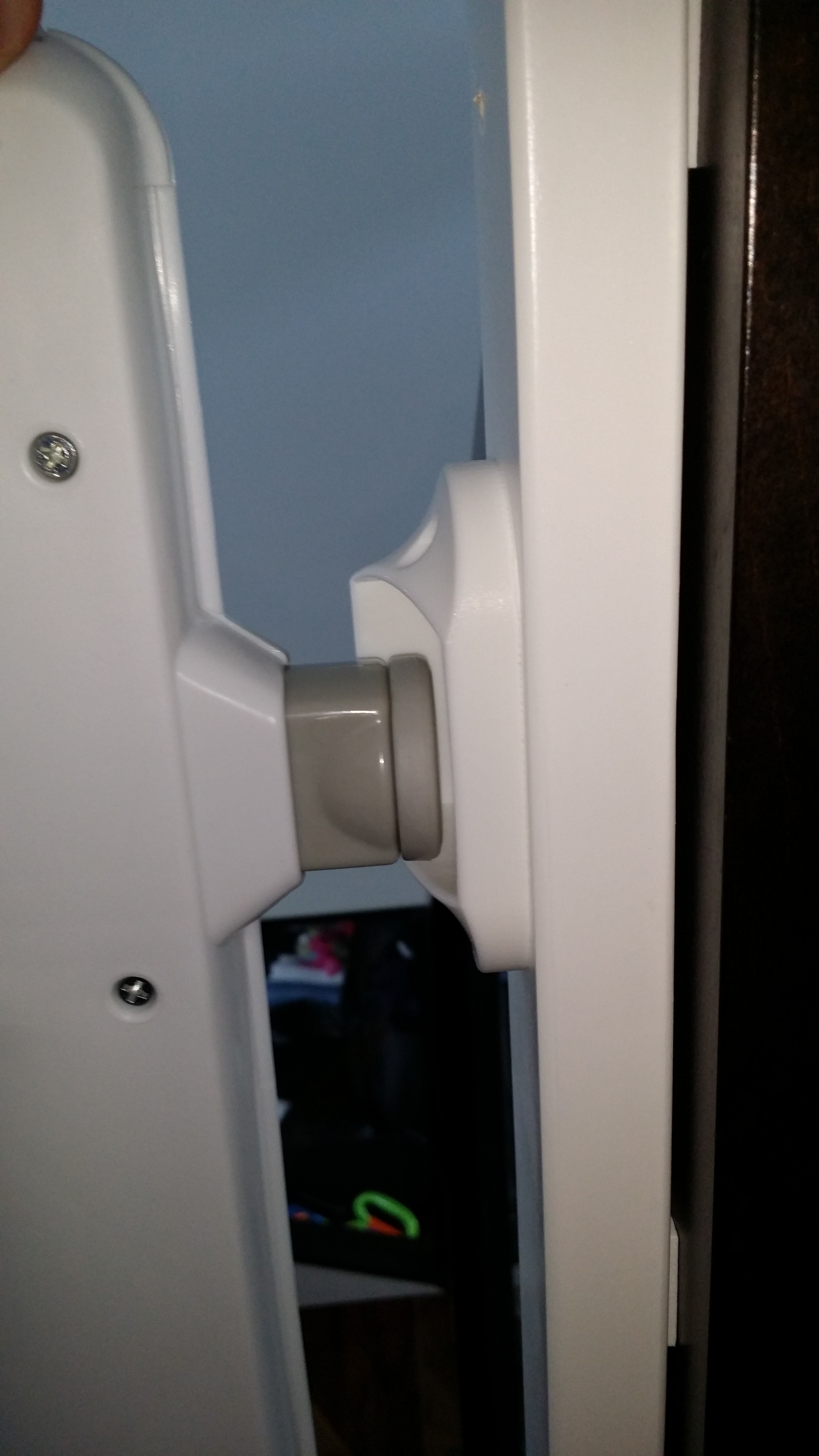

And here is the problem:
The gate locks fine.
But when opening the gate, pulling the handle up all the way causes this situation, which is questionable at best...
This is not what you want to see - a 2yr old that's pushing all her weight at a gate at the top of a set of hardwood stairs that may swing the wrong way. (I'm in no way trying to bash the product. We have these gates elsewhere in our house with no problems. The other locations might have a bit of 'give' to them in the frame allowing the gate to fit over a larger range (if that makes sense), however, in this location, it's quite rigid and it creates this scenario):

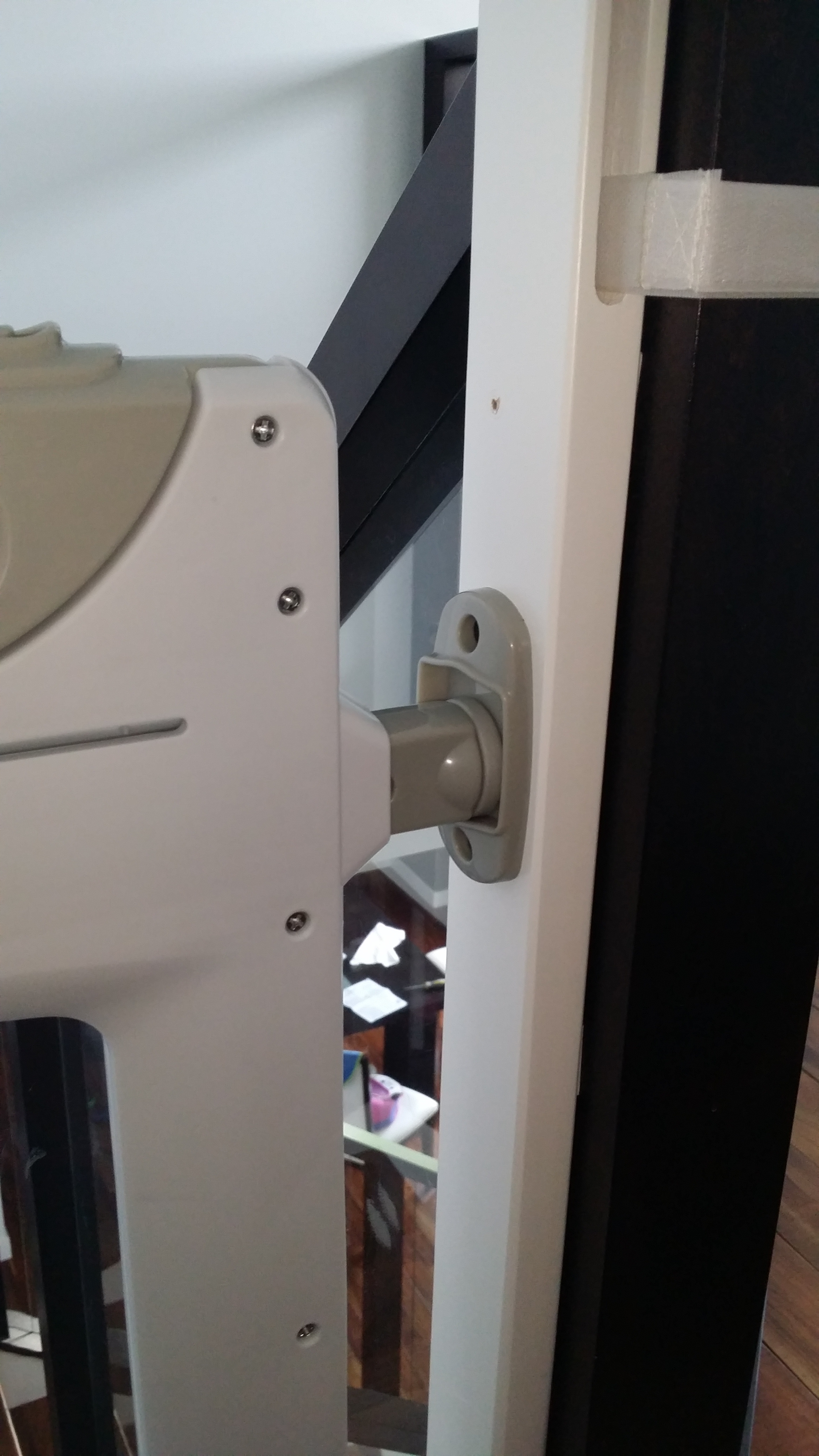

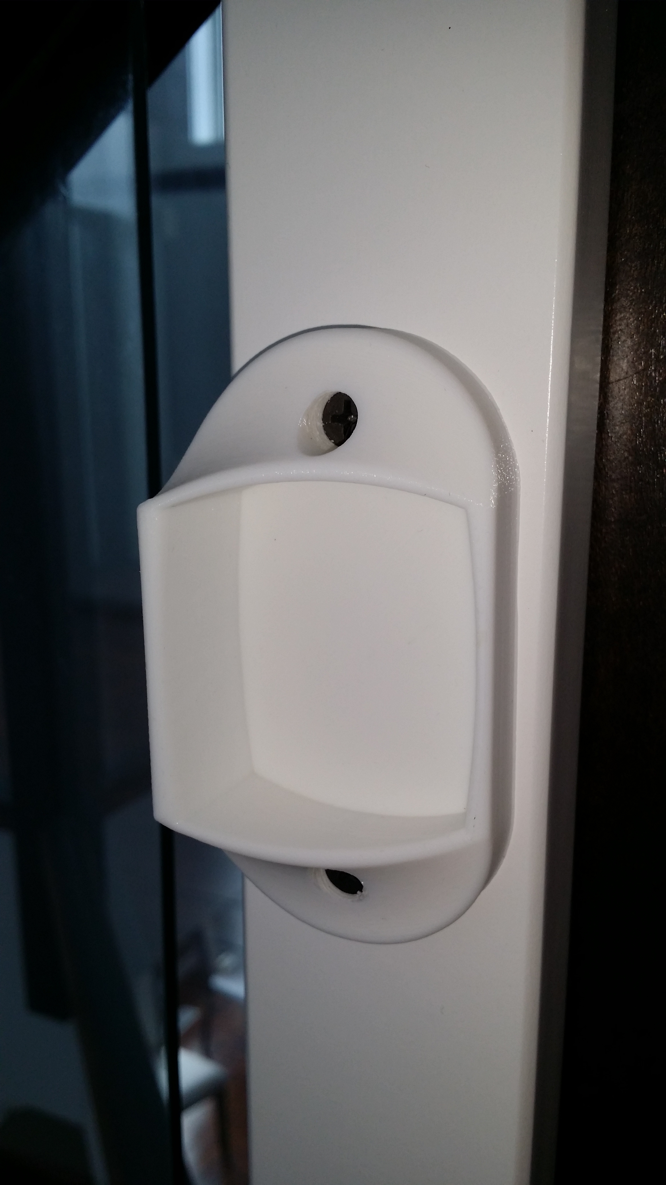

I went ahead and made my own gate holders... again. The one at the beginning of the thread was made a bit special as it was at an angle. I might also mention that I'm still fairly new to 3D printing. It was made in Sketchup and took me an embarrassing amount of time to make. This new one was made in Designspark and it worked out much better at a significantly less amount of time. I made a larger holding area at the back of the bracket:
It was printed with Sainsmart white PLA. 192C, 0.06 layer height, 80% infill. The brackets are very tough. I wouldn't put them in place if they felt flimsy, that's why I wouldn't use a lower infill. If my daughter pushed and broke the bracket that I designed and made, tumbling herself down the stairs... I would be devastated. I tried to break it with my bare hands and even whacked it with the handle of a screwdriver to make sure it would stand up to my girl hitting it hard and it stood up just fine. Even once the gate was in place, I slammed it shut a bunch of times to make sure. It's solid.
If anyone else just happens to use the same gate(s) and would like it, here is the .STL. Use at your own risk. I'm comfortable with it, but I've also tested my print in various ways and I've been satisfied with the integrity. Perform your own tests to be sure you'd use it for the safety of your child.
Tinyhead StyFst V2.1 Bracket.stl
(1.74 MiB) Downloaded 316 times
For some reason, I can't seem to get rid of this 'attachment' picture below...
