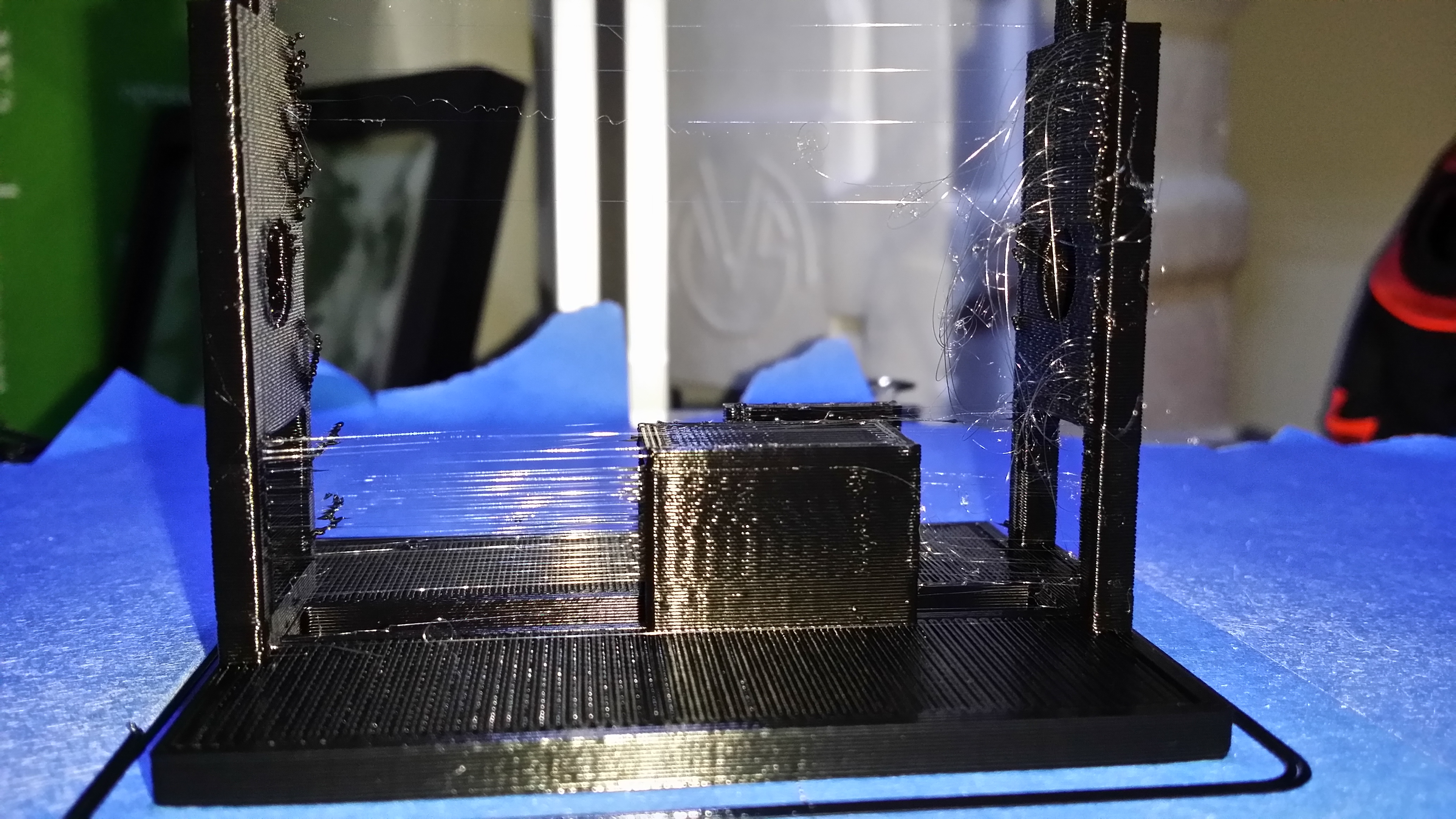

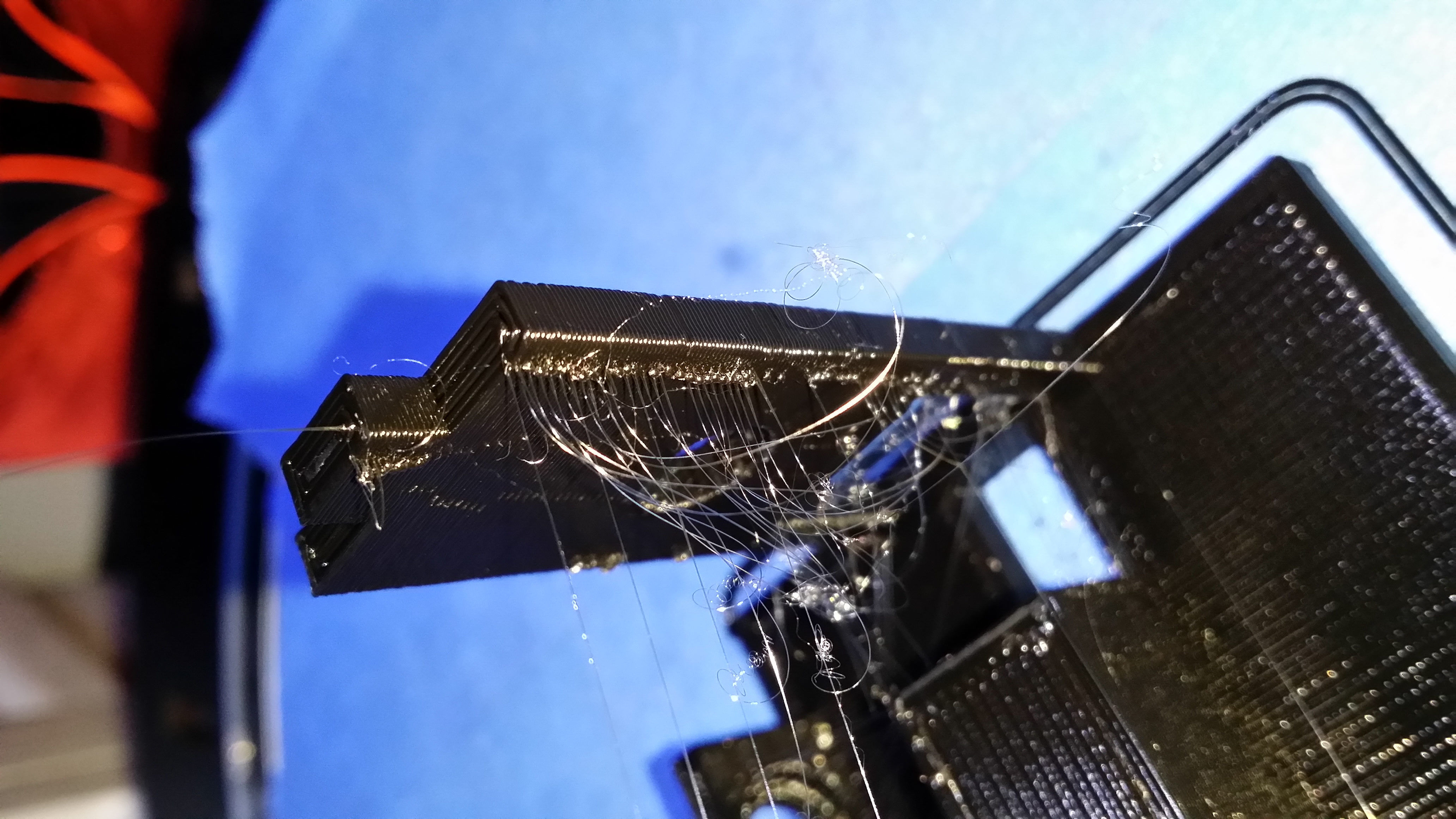

Instead of posting a new thread, I thought I'd try to add to this one! I've got the exact same problems that were mentioned at the beginning of this thread. I get PLA oozing and little blobs and strings all over my print. I'm using PLA and was running it at 195 degrees. I'm using the settings provided by geneb in the manual (all 30mm/s and 80% on external perimeters). I've been experimenting with those speeds a bit too to try and get better results, but they always seem to come out the same. I'm using Slic3r right now (might give Cura a try when I gather up my courage to try something different). I'm printing at 195 and if I go much lower, I end up with skipping on the extruder so I haven't wanted to go too low to avoid a jam. I've also tried different retract settings and wipe with success on smaller prints, but if I have a few things on the build plate or a larger object, I end up with this mess:
I've printed the hollow pyramid (http://www.thingiverse.com/thing:8757) and it turns out great. As well as many other smaller items. The SeeMeCNC hot end fan shroud came out looking like it was bought in a store (very minor little strings). But then I'll try printing a few chess pieces and I'll spend hours trying to clean them up poking my fingers on all the little bumps just to toss them in the trash afterwards because they looked like hell. I'm sure some of you guys might be able to suggest something right away, but I'm just at a bit of a loss.
