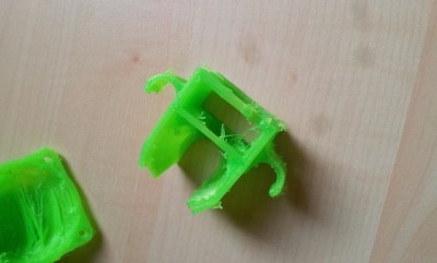

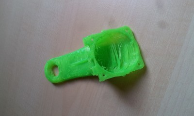

Im trying to get my first good print now for several weeks - but i'm still stuck with two major problems:
(PLA, Hot-End 190°, Head-Bed 60°, EZStruder, Firmware 0.91, RepetierHost and Slic3r, 0.5 Nozzle)
Although i did the printer calibration and the paper test for the 4 reference points, my first layers don't really look flat.
It seems as the printed lines are "pushed away" by the following ones, forcing them to make "waves" - which causes the next layers to get errors to.
Also the PLA doesn't really stick to the heated bed, so the first rounds of filament get stuck to the hotend and carried with it.
I thought mayby it's just too much material extruded, but on the final layer it seems like the lines make gaps between them which leads to a not solid surface...
Sometimes the printer manages to overcome the first layer but then i get prints with hairlines (right word?) on the sides of them.
Or the printed lines fall apart completele...
I'm really running out of ideas as i can't even manage one usable print at this time...
Daniel
complete fail print
complete fail print
hairlines on the final print
first layer doesn't stick to the ground
first layer makes "waves"

I now tried higher temps (65/195) and a brim. I tried to use a desk fan too.
That works pretty well for the first layer. There are still little waves sometimes, but these are really minimal problems (just approx. 0.2mm high).
I also increased the retraction from 2mm to 5mm, the number of hairlines decreased but they are still there.
Also the final/top layer looks better. The surface still looks not quite closed, but the gaps are much smaller than before.
I'll try several other prints (now i just did the calibration cube) and will post photos of them.
Thanks for the great tipps!

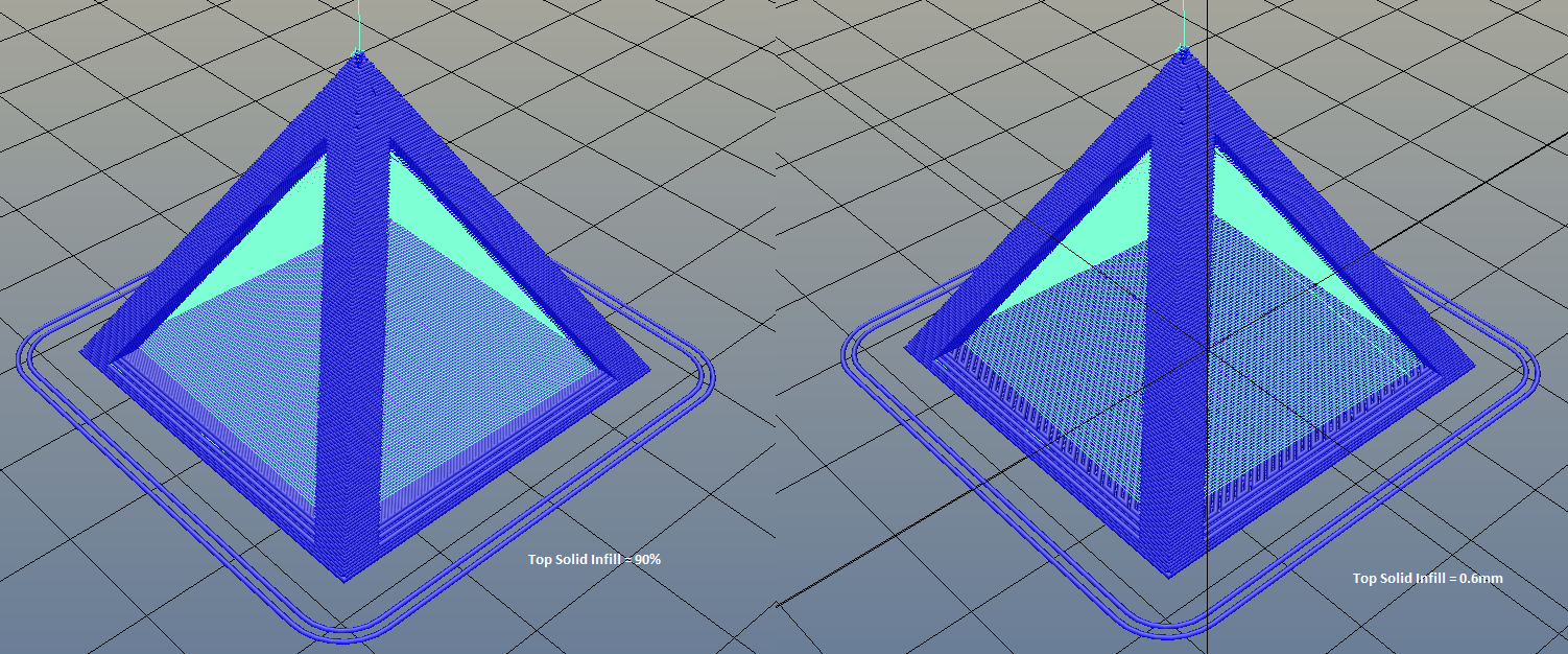

That's what my settings are for some of my prints. You could changing the widths to 0.6mm; I've read a few guys on here use that number as a safe medium.
Looking back at your original pictures, I'd wonder about the Z-height. That first layer looks really squished flat and if you're getting any ridges from it pushing the material around, the next pass is going to hit knock it loose on the bed. But it is a bit hard to tell, so I may be wrong.
Last thing. You can try pulling up a file in repetier, then use Slic3r (kind of built in) and make some changes to that top layer width. Then go to the 'G-Code Editor' tab and take a look at how the top seems to be filling in. Try a different setting, save and go back. You might find a width or a fill percentage that works better for you.
Testing with top fill to make the prints nicer and more whole.
As you can see in the picture, the one on the left had a much nicer finish to the top layer and didn't leave much room for gaps.
