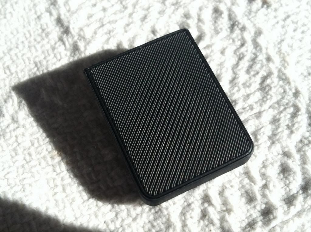

So I was out in the shop printing a couple more parts today, and I'm experiencing one thing that I'm not quite sure
how to fix when slicing.
Prints are coming out looking pretty nice, but this nozzle is producing much smaller and more accurate lines.
The single wall test printed perfectly at an average of just about .44 thickness (for a .44 wall -- .4 nozzle).
When trying to print anything not hollow or single wall, the lines inside the perimeter are uniform, but they don't seem to touch/have any overlap (25% infill). When I hold the print up to the light, I can see light through the tiny holes.
What setting should I be using to alter this? Extrusion width? The results I just described were using MHackney's KISS settings. .55 extrusion width. I would have thought .55 would have been a fairly thick extrusion width for the .4 nozzle?
All help is immensely appreciated!
Thanks again for guiding me through this 3D printing journey!
-Daniel

Re: Printing properly dimensioned parts?
See this topic, it sounds an awful lot like what you are experiencing.
The second and third pages talk about problems similar to yours. http://forum.seemecnc.com/viewtopic.php?f=42&t=1036
Hi Eaglezoar!
I read through the thread you linked to and there are a couple of ideas on there that I will look in to.
Here are a couple pictures of the print I did that I was referring to in my last post.
It's fairly clean, but the crosshatching is sparse. Hence, when held up to the light I can see light through the infill pattern.
[img]http://i161.photobucket.com/albums/t222 ... b4f53d.jpg[/img]
Bed side of print
[img]http://i161.photobucket.com/albums/t222 ... 6d72e1.jpg[/img]
Top of print
