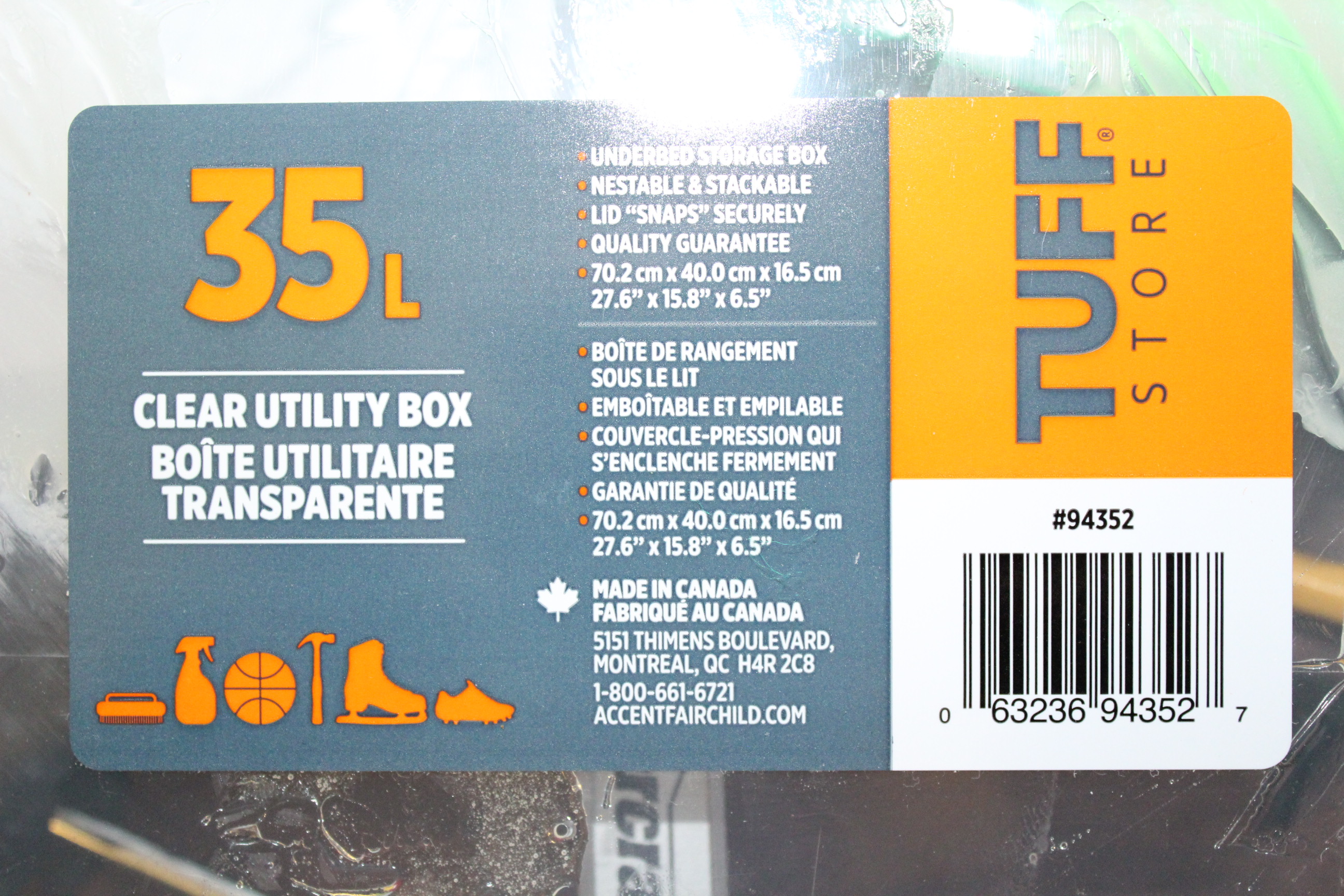

Hi Everyone. Check out my $20 enclosure.  Took 45 minutes and the warping seems to be gone.

Nice!  From what is the enclosure made?

You cannot post something so seemingly perfect without a link to the product......
Where did you get it?

It looks like a couple generic plastic storage bins with one end trimmed off and mated top to top. I see a couple knobs added with rubber bands on this side...the other side is either the same or has some kind of hinge. Tape would work. I applaud the ingenuity and reuse of common products.

Yes, 2 storage bins on their side and 3 hinges.  Really works well and doesn't look too bad!

The filament roll is on the desk behind enclosure on a stand. A small hole is drilled to allow the filament to enter at a descent angle.

Any chance you could give the details as to how you did this? Like what hinges were used, which brand and model of containers were used, what you used to cut them, etc....?

Can you give us a hint of where you got the containers, the brand and the size?Holy1 wrote:The filament roll is on the desk behind enclosure on a stand. A small hole is drilled to allow the filament to enter at a descent angle.
Re: Check out my $20 enclosure
I got them at Home Depot. Here is a photo of the label. I cut them with a good set of sheet metal shears. btw the .030 PEI material I used on the heated bed cuts well with red or green sheet metal snips. The hinges were also from Homo Depot.

Thanks for the pictures and the sourcing of the materials, the containers look like Canadian, I hope the states have something similar.
