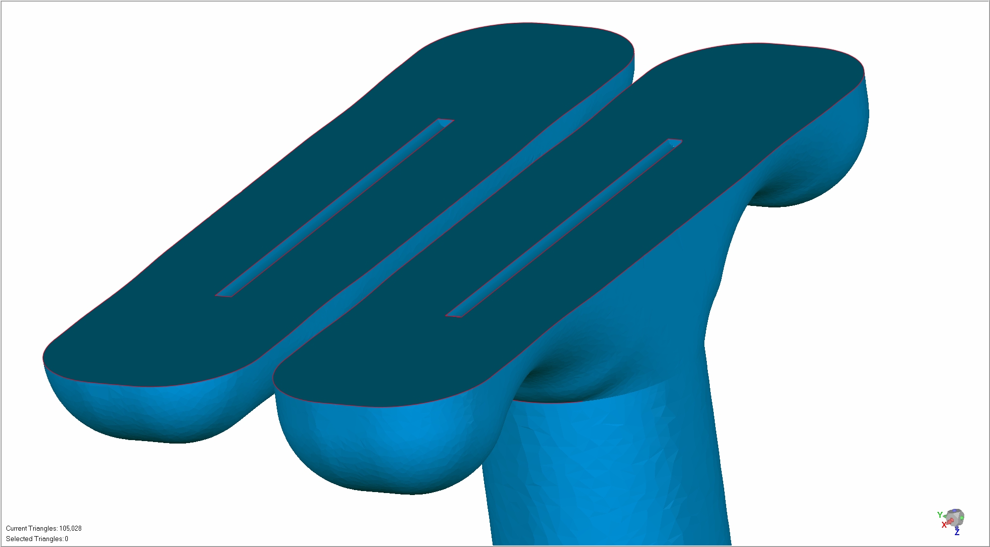

For this part I ended up splitting it into three parts, adding locating blocks and screw holes. Tried an offset step and a flat face but neither really held it in position with any confidence, this seems to work ok. A bit more mucking around but I don't really trust glue in an application that needs a bit of muscle.

If you've got the room, you might want to try using heat-set threaded inserts.

Nice approach!lasermike wrote:same boat as you. many of my models will need to be cut. i am trying tonight an option to add a 1.85mm cylinder lined up with my section cut. this will leave half on each side and am hoping to just put a piece of 1.75 mm filament in the slot and make the gluing easier. this one I ran horizontal to the split, might try adding 1 vertical as well, will see how this goes.
