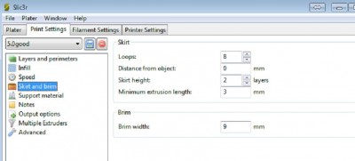

What is it with prints raising up on one edge? Most of my prints are doing this now. I'm using a light coat of hairspray on the hot bed. Seems to be happening more often for some reason.

MDMD I have printed with a brim before and the only problem I have with that is I really want to know why this is happening.

Jay, what you're seeing is a symptom of shrinkage with ABS. The easiest way to minimize that is to add a brim on the part or "mouse ears" on the corners that are pulling up. It gives more surface area for the part to stick to the bed with.

I tried printing with a skirt at my usual 90C and yes it worked great. I can deal with that. Funny comments about the brothel and hair salon. Thanks for the help!

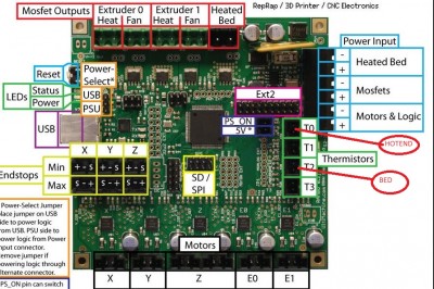

Here's the thing, my bed temperature displays 86C as soon as I open RepetierHost. I can hit the "heatbed" and it heats up but it's way off. I think I measured that when it's displaying 107C then I'm actually at 90C. I know that the RostockMax has PID control for heating the bed and hot end. I've definitely messed that whole closed control loop up.
The good new is that I've noticed I can take the bed thermistor input and connect it to the hot end input on the rambo and the temp displays correctly. I've also noticed that there are 4 total thermistor inputs of which only two I'm using (hotend and bed). I want to change my firmware and plug the bed input currently in T2 and put it in T1. I think this would be simply enough but as I downloaded the firmware and I'm going through it, I can't seem to find the T2 analogReads and swap that for T1.
Any help???

there is also some other points besides the bed pads that needs to get a layer of kapton tape to electrically insulate.
Posts: 5359
Re: All prints are raising up on one edge
Putting Kapton on the exposed vias on the Onyx are part of the instructions.
You've likely shorted out the thermistor port on the RAMBo and killed it.

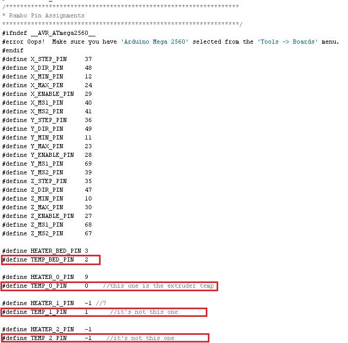

Yes thanks for the email! I've found the pins.h and the Rambo board temperature pin assignments. I believe I'll change #define TEMP_BED_PIN 2. Not sure what to change "2" to though. I've debugged a little and this is what I've found.
Changing pin 2 to "1" made the temp stay at 76.03C.
Changing pin 2 to "-1" made the temp stay at 89C.
The correct Celsius temperature it should read is around 23C. Like I said earlier, I can plug the bed thermistor where the extruder input is and it'll read around 23C.

Ouch just checked the price of a new Rambo board. $185. Any other suggestions?
JAY wrote:Ouch just checked the price of a new Rambo board. $185. Any other suggestions?
Gene's assembly manual tells you to cover those areas with Kapton, I think you missed that section but their are solutions.
Ultimachine will repair those boards. They are the manufacturer. Go to the ultimachine.com site and send
a note to support asking how to send the board in for repair. It's under the about us - contact us.
It is also possible to change the firmware to use a different input for the bed thermistor. Can one of our upper
level users help Jay remap his pins.h and configuration.h? I am not good on the remaps.

Yes I changed the inputs and the bed temperature did not resemble the correct Celsius temp after the changes and uploads to my Rambo board. I have four total thermistor temp inputs, one is the extruder, one is the bed, and the other two are open so I tried the two open ports with no success. The extruder temp is reading fine through RepetierHost, furthermore the bed thermistor plugged into the extruder port reads out fine on Repetier Host as well.
I just find it odd that I've fired 3 out of 4 ports. Hell, I find it odd that I've fried 3 ports in one quick swoop. I can't imagine 3 analog ports using the same analog to digital converter, maybe two yes but three seems like a jump.

Are you sure you used the correct pin number? RAMBo has some pretty funky pin assignments. Even with my RAMPS and marlin, I used a pre set up configuration and it had the bed assigned to the wrong pin, what should have been Extruder 2 pin, and I don't think the pins were used in numerical order... (T0 is like 2, T1 is 4, T2 is 5, pretty sure RAMBo is even more scrambled)

I got this reply in my email from John Oly with Seemecnc:
_______________________________________________________________________________________________________________________________________________________
Jay,
Nope, not hard at all actually!
Open up the repetier.ino in arduino, which opens a bunch of other files. The top right drop down will list them all. Go to pins.h and once there, do a ctrl-F and search for RAMBo pin assignments. Underneath that, look for the #define TEMP_BED_PIN 2 and change the 2 to a 1 and save/upload. You'll now be using the number 1 pin (it goes 0, 1, 2, 3) which is the one next to the hotend thermistor
Up to this point I have tried "1" and "-1" with no luck. I got John's email at work so I remoted home and changed pin 2 to 3 and uploaded to the printer. I'm not there sitting in front of the rambo board so I couldnt physically unplug the thermistor from port 2 and try in port 3 but as I connected with Repetier host, the bed temperature wasn't right again. It was acting dependent on the extruder temp with an offset of +3C. So if the extruder read 23C, the bed read 26C. As a test I turned only the extruder on and the bed temperature would rise as well always 3C above the extruder. I believe pin 0 is the extruder.
Anything popping out at anyone here? Shouldn't one of the other two unused thermistor inputs work? Does anyone know how many DAC's the 2560mega has and to what pins they are assigned to?
-Thanks

Not sure what's going on with my Rambo board. John Oly replied again and said that it was odd that switching the #define TEMP_BED_PIN 2 to "1" didn't work. I wasn't sure what else I could do, thanks for your help Geneb and John. I have bought another rambo board, it shipped out today.
