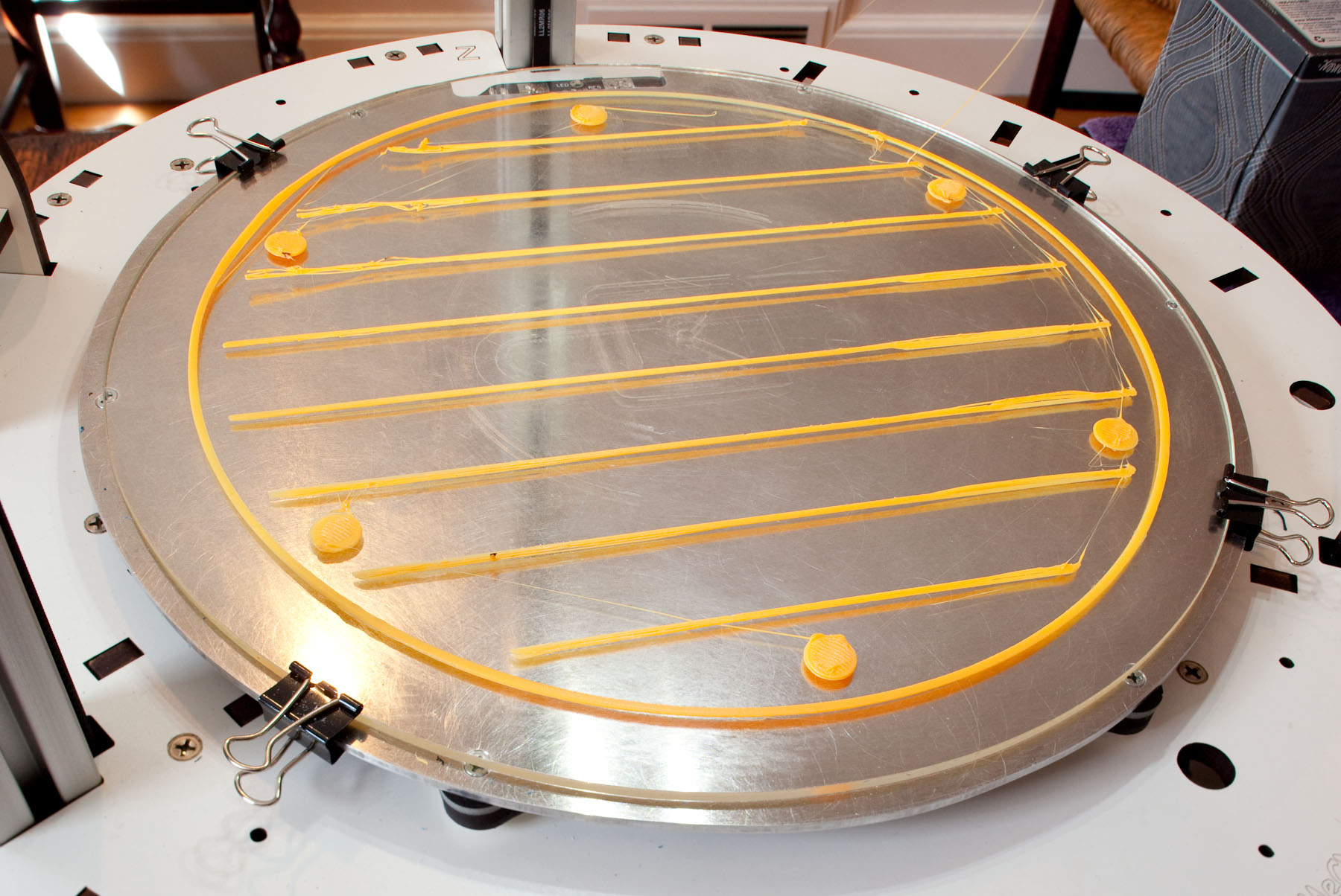

Made this a few days ago to test my z height and delta radius. It's not perfect, but it all stuck to the glass except a few spots near 11 o'clock.
I think my plate is probably fine.

doing that on top with the glass wont give you accurate idea of how flat your aluminum plate is, but if your printing with it like that, that's fine, because your calibrating it to the glass.
the glass will mask some of the discrepancies of the aluminum plate. (if you have any)

Yeah but all I care about is printing on the glass. If I can print to the whole surface, then I'm happy. I'm open to suggestions on how to further improve it - such as playing with the location of the clips.
Thanks.
