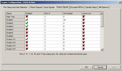

When I click on the Mach3 diagonstics tab, the port 1 current state DRO shows this (the pluses are green):
Also, if I am using the SeeMeCNC Mach3 profile, should I have to change anything under the Ports and Pins menu, Output Signals tab? Enable 1, 2, and 3 and Output #1 are selected.

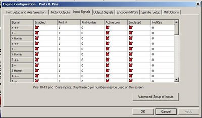

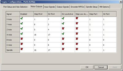

Here's some pictures of my settings. I hope they show up. I appreciate the help.

Re: Troubleshooting EasyDriver
Are you sure you have pin 16 on the 3 axis board wired to the ED Step line? That's what you have configured in Mach. If the step and dir are reversed, the motor won't turn. An easy check is to switch step/dir assignments in Mach and try to jog.
Also, your A tuning - looks like you have Mach Native Units configured for inches. In theory it shouldn't make any difference. In practice, a number of us struggled with odd behavior until we reconfigured in mm.

I've tried switching pin 16 and 17 around. Nothing changes. I believe the EasyDriver is recieving the right inputs, but not outputing correctly so I ordered a new EasyDriver.
