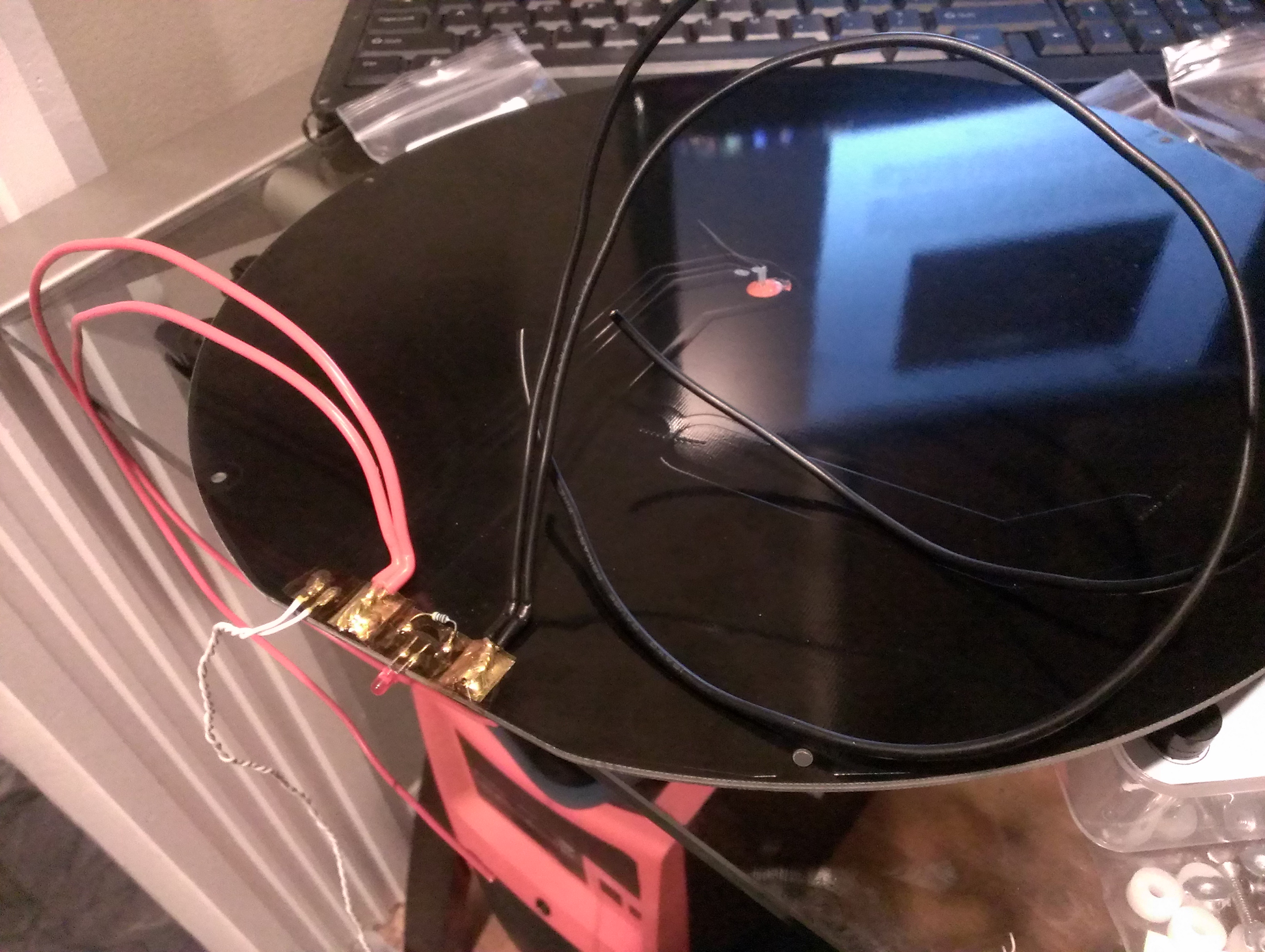

Got quite a bit done last night and this morning. I probably have about 10 hours in the build so far, but I have to admit I've been catching up some tv shows that I DVR'd at the same time.
I also ordered the Trick Laser carbon arms and platform LED's yesterday, as well as a set of motor dampers from cope.
Anyways, I got the base fully assembled, the extrusions installed and squared up, and the top mounted. Then I started to skip around a bit since I am waiting on the dampers and arms before I install the motors or do anything with the carriage/platform assemblies. Got the extruder, extruder mount, and spool holder sub assembled and went ahead and installed the pulley's to the XYZ motors with the extra 6mm spacing required when using dampers.
Here's a few pictures of the work thus far...

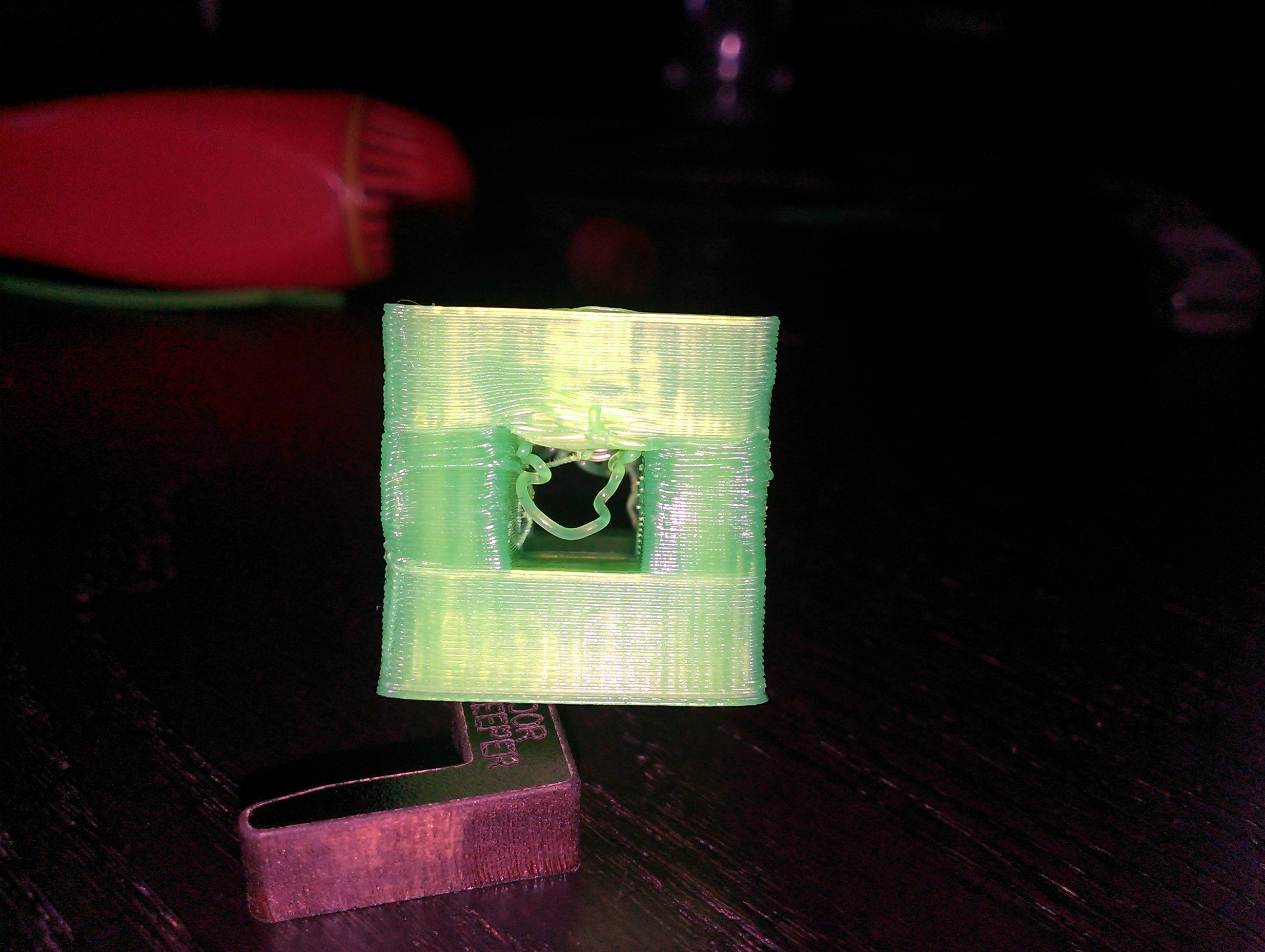

Ok...so long time no true update.
Got the printer powered up and running yesterday. Fully calibrated and printed my first (and second) test cube today. Got some comments and looking for advice on some settings....without further a due here are some pictures.
Also, I promise after the end of this I will post some good pictures from the DSLR instead of my crappy camera phone
Now for the first calibration cube and the 3/8" rod holders (one of which broke). Everything printed with PLA without a surface fan with the specifications outlined in geneb's instructions. Please...any advice is helpful!

Comments wise....
- Looks like to print PLA, I really need a surface fan to cool the material. Would this solve any issues seen in the calibration cube?
- To make better bridges is it better to mess with bridge acceleration or bridge speed?
Any and all other comments welcome!
Comments wise....
Re: So it begins...first 3D printer build...Rostock Max
I'd bump your retract up just a bit. You REALLY need a layer fan. Until you get one, you can dial back the print speed using the slider in Repetier-Host.
Thanks for the tips. I wonder if there is anywhere local where I could pickup a fan today?
I still need to get my non-fan prints good enough to print a fan mount though
. What print speed would you recommend for PLA with no layer fan?
