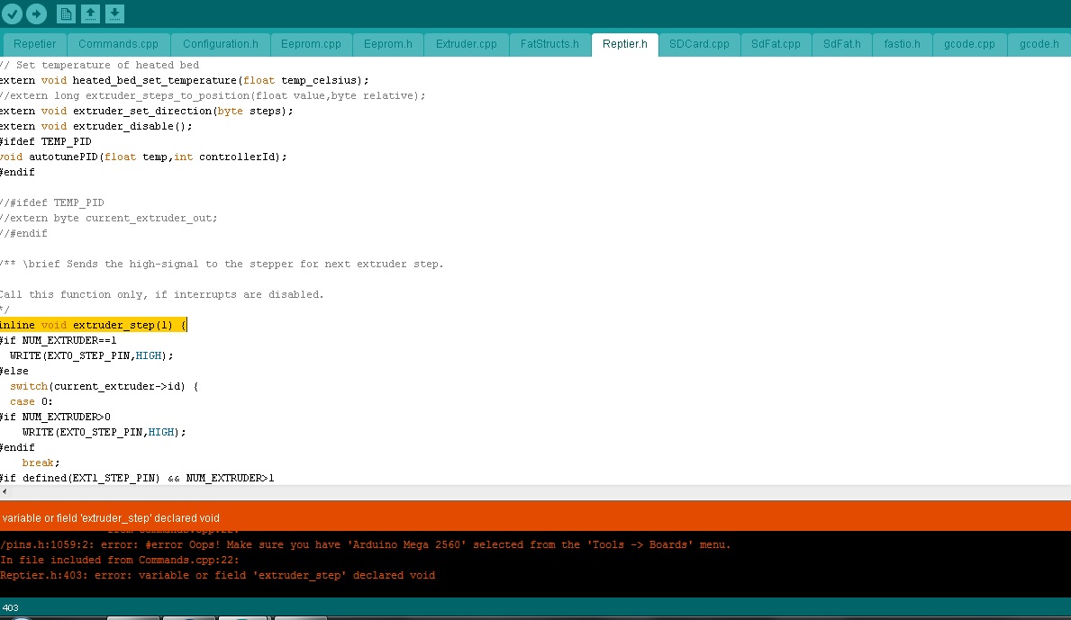

I still can't get the " extrude" to move the filament the correct way regardless of if it is set to true or false. I've double checked all my steps and I am uploading etc etc correctly I believe. Not sure what is going on.
It is showing a code error. I attached a pic. I have not edited this area of code at all, but it shows this error message when I upload it.

Re: Print_Radius problem
Do you have the correct board (mega 2560) selected under tools --> boards? Confirm that first, then you can use the 'verify' button to check for errors before attempting to upload. If then you still show the error, I would grab a fresh copy of the firmware and start over as I don't know where that error would have originated.
