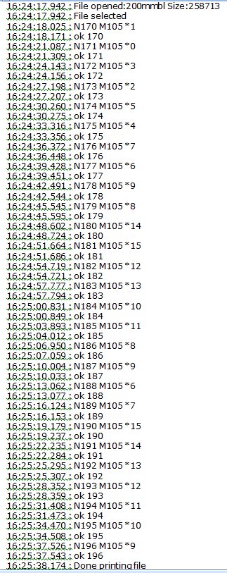

I've been printing from the SD Card to achieve best quality prints and I've been getting SD Card Read errors:
and prints are terminating early before they are completed:
Any ideas on how to remedy these printing issues that arise when I print from the SD Card?
