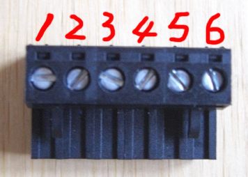

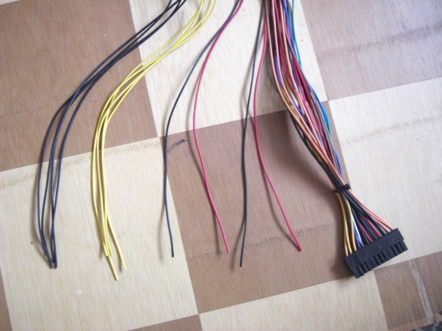

excuse me , i am a new guy from Taiwan
this is first time assembling rostock max kit
RAMBo controlle require four yellow wires and four black wires in the power supply
to provide power to the the Onyx heated bed and the hot-end.
according to the assembly guide the four black wires on the left most should insert into
pin 1 in the black terminal block connector as pictures indicated, and the four yellow wires insert into
pin 2, then a single black wire for pin 3, then red wire for pin 4 respectively , is that correct? any reply would be appreciated

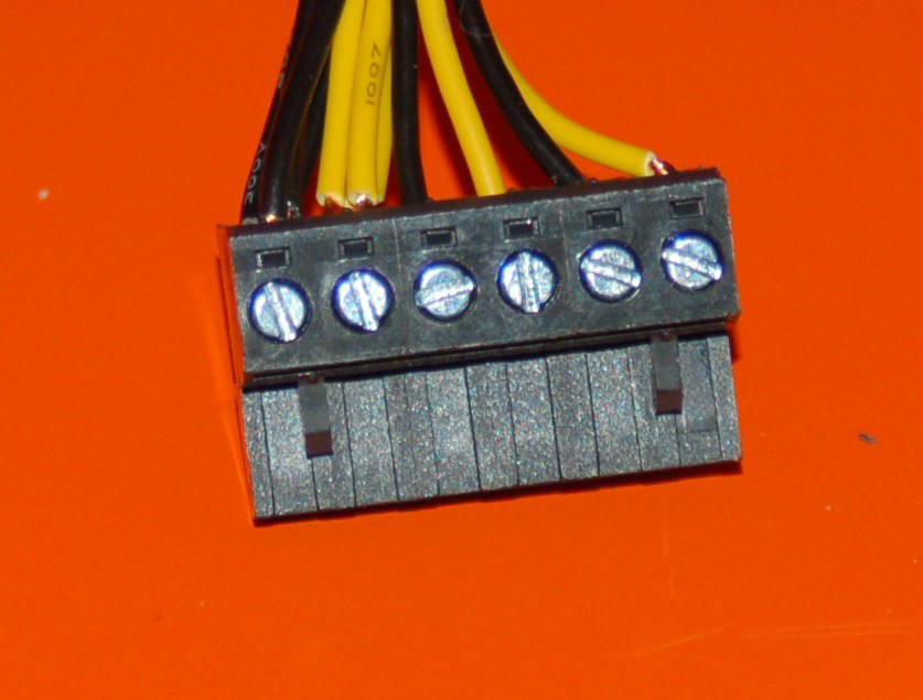

I think you may have an old or bad copy of the guide.
The latest guide can be downloaded here: http://www.geneb.org/rostock-max/Rostoc ... -Guide.pdf
I have enclosed a picture of what the connector should look like after wired properly.
Welcome to the Forum!

Eaglezsoar wrote:I think you may have an old or bad copy of the guide.
thanks for the reply
judged by the picture from you , i just need to replace the red wire in pin 4 and pin 6 with yellow wire
and it's done, is that right ?
Re: power supply problem
That should be correct. There should be no red wires. Just follow the picture I sent.

actually,the guide has nothing wrong, it was completely my own idea tried to use red wire instead of yellow, by the way, what's wrong with red wire, why it can't be used ? please forgive my silly question
Broose
Posts: 227
Location: NH, USA
Post by Broose »
The red wire is 5V and the yellow is 12V. You need 12V for each of the three supply inputs on the Rambo.
