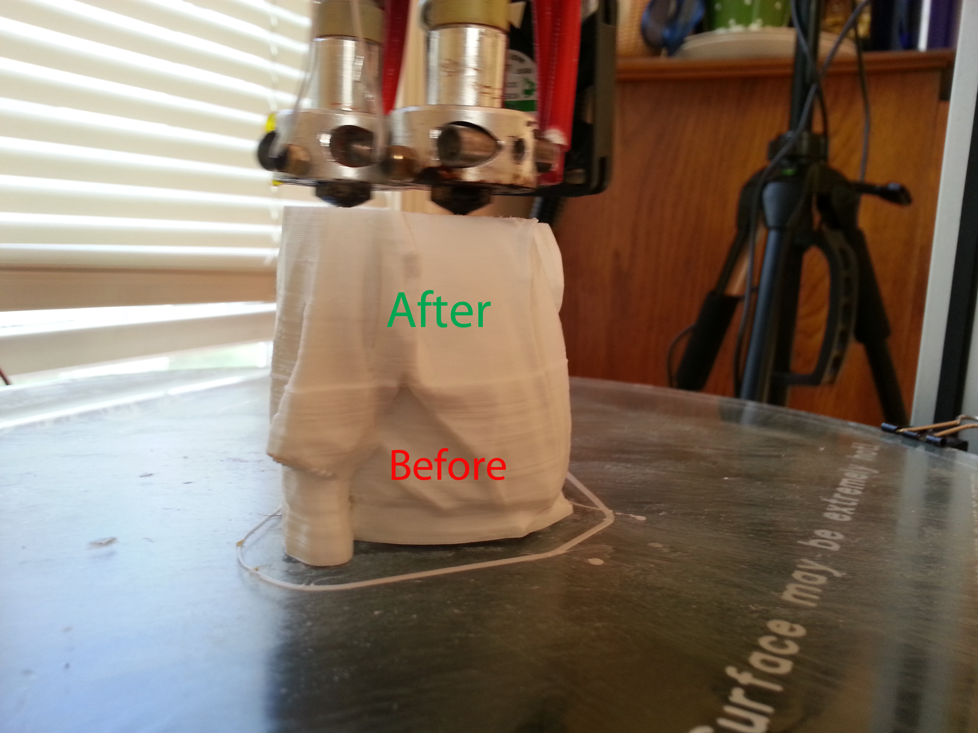

Ensure all bearings are rolling on cheapskate!
I know it seems obvious but My last few prints had really poor quality even after re-calibrating like 10 times. I was under the assumption that it had something to do with my new dual hot-end setup but it reality it wasn't. The top cam bearing on my x-axis came a little loose (as they tend to do after time). I ended up snugging it up during a print and the difference is honestly night and day.... So when your prints start looking like the sand at low tide do yourself a favor and check your bearings
Re: Ensure all bearings are rolling on cheapskate!
Nice job, and great reminder!
Now, get that warping under control!!!
