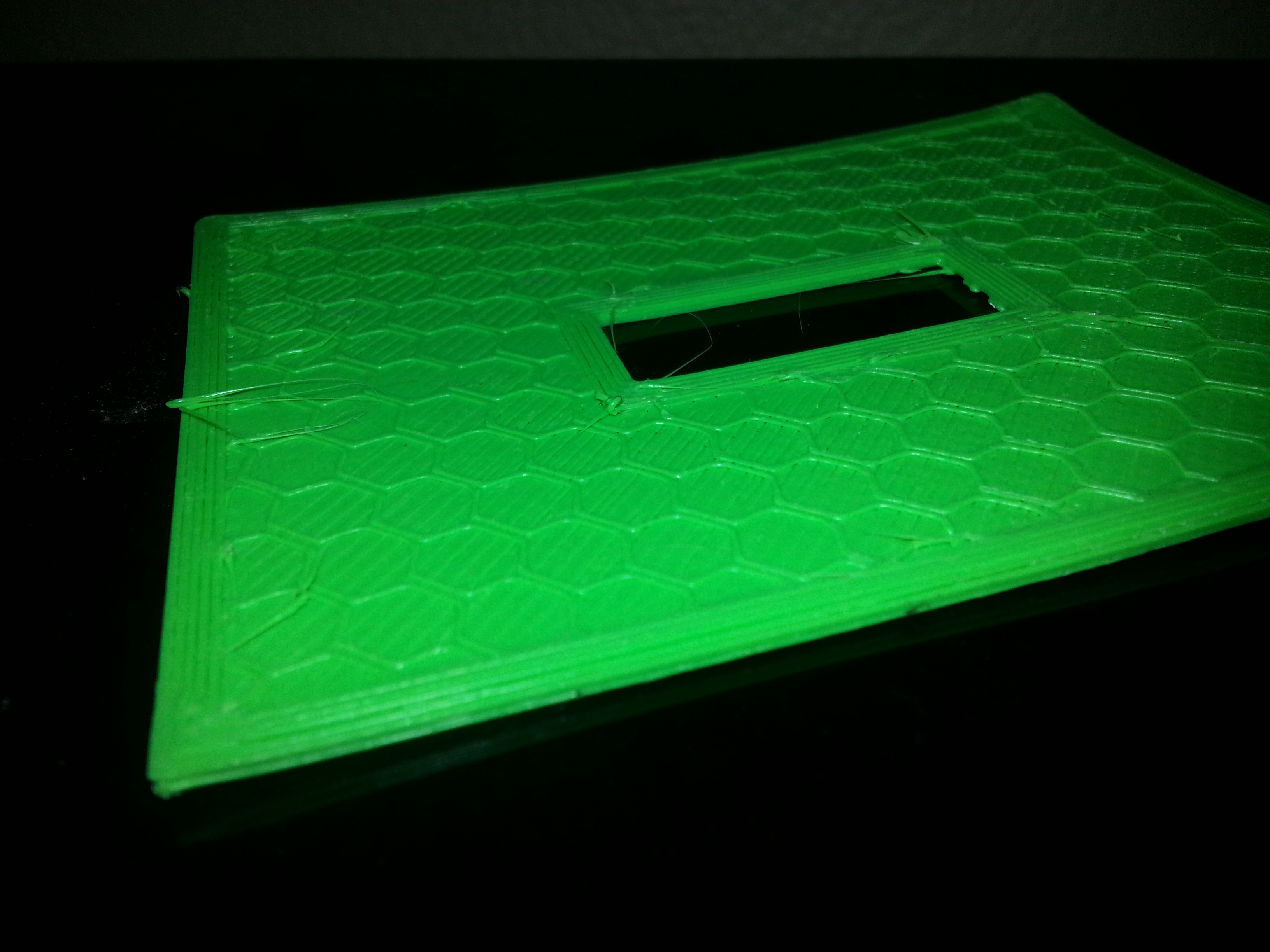

I can't seem to get a 90 mm x 120 mm x 5 mm ABS print working without edge curl.
Some particulars:
I have a well-calibrated printer.
0.50 nozzle
235 head temp
65 bed temp, glass with painters tape
0.25 layer thicknesses - but I've tried lower
I've tried skirts and rafts in Kiss - with inflation of 8, and inflate support of 2
Kiss seems to ignore raft settings and quite frankly, Repetier is not suited for this type of printing - I've tried all sorts of infill with it - different speeds, fill densities, etc. It simply gives me too much or not enough plastic - with the same curl.
What's the secret to Kiss w/rt external support? Should I include a 0.25 thick, 1" raft wide in the drawing and just cut it off after I'm done printing? Seems like that's not what we're doing here...
Another question while I'm at it: Why does edge curl occur at opposite corners when the part is so large?

Can you show a picture of the part, large prints can be tricky in ABS.
Sharp outside corners area the usual areas you see warping, the quick fix is to add a circle 2 layers high centered on the corners that cause issues, often referred to as Micky mouse ears. Less perimeters, less solid layers and less dense infill will also help.
The curl is just the plastic shrinking as it cools, you print layer 1 by the time your done, it's cooled and shrunk, you print layer 2 on top of it and as it shrinks it causes the layers below to curl upwards, you need to have enough adhesion to the bed to keep the part flat during the print.
I like hairspray on glass for ABS, but as parts get large ABS starts to be difficult.
You can also try and keep the temperature of the entire part elevated, the idea being if the entire part cools together it won't warp,I've seen people use heat lamps to do this.
PLA is pretty trivial to print at that size, but it comes with it's own issues.

Thanks for replying!
(apologies for the photos in advance. My Gallaxy SIII is not great at closeups.)
The design is a phone holder for an outlet. I made it in Autodesk Inventor Fusion, it has design issues but I was eager to print it.
Kisslicer - good vertical (80mm) but the edge kept curling. I had medium infill set. I even held the bad edge down when the head wasn't in the area. The best print of the bunch but the edge curl killed it. I don't think the print will need supports for the circle.
Can't really see the edge curl here but it's about 3mm up on each corner.
Played with infill.
Reduced infill and speed but changed infill to "straight" - that definitely didn't work - I should have set the extrusion down a bit.
Less infill and mouse ears! I'll try those. I'll also try keeping the heat in. I think there's room for innovation there. The round tube or perhaps just printing something...

Anyway, here is the drawing with the mousey ears that is going to the Wobbly Weeble next.
http://dropc.am/p/KhiI1a
JohnStack
Posts: 839
Location: Carlsbad, CA
Re: Combatting Edge Curl
Post by JohnStack »
A very slow print but a decent one. For some reason, the areas around the balls didn't get filled in - but I blame that on geometry and translation.
The mouse ears were only 0.25mm think - I was amazed how they held the corners. I increased the print temps to 70 and reduced infill. I kept the tape since I wanted to keep things a bit consistent. I forgot to add insulation as suggested and then decided to see it through.
This print is 90 x 110 x 75mm high.
Things I didn't like:
The top surface (would love Kiss to have top thickness)
The vertical part is weak. I can fix the design but it's weak because of infill on bottom of the vertical.
I also found a dead spot on my bed by doing this. I had to pause the print and pull off unattached stuff in dead corner.
This was a very slow print - like 3.5 hours. I'll adjust the drawing and print it a bit faster, perhaps with thicker layers.

FWIW I think you are under extruding looking at the top surface.
I'm surprised none of the slicers have made it easy to add mickey mouse ears yet, Slic3rs brim is close, but there is a significant advantage to having the interior corners between the circle and the part.
