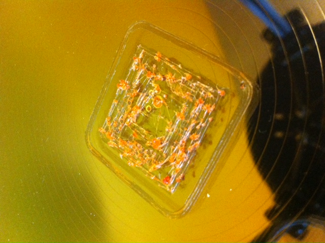

First Print - help needed
Major update: First Print
Apparently it's not essential to tune the bed, so I moved on to trying a test print: NEED... MORE... PLASTIC...
I'm not getting enough filament out of the nozzle...
What I know id probably correrct:
Temperature = correct - nozzle is heating up to 185 degrees (0.5 mm nozzle)
Feedrate = correrct - If I type in 100mm to the repetier extrude box, Steve's Extruder spits out exactly 100mm of filament.
What may be wrong?
Steve's extruder is not gripping the filament hard enough - while it can extrude 100mm with no load, maybe the load of squeezing it through
a tiny hole is making it slip, maybe I need to tighten the feed jaws?
Maybe there is an obstruction in the hot end / teflon sleeve inside the hot end?
Maybe I have the settings wrong in the firmware / slicer / repetier settings.
Maybe some other thing?
If anyone has any tips I'd be really grateful

- foshon
- Posts: 600
Re: Analog_Banana's Rostock Max in the UK
Will it extrude in free air? I have read that some users of Steve's extruder mark the filament so that there is a visual indicator of slippage. You may want to try increasing temps a bit (5 degrees at a time), I have a spool of PLA that needs 195 to extrude well.

First Print!
I made the following changes:
set repetier to 203c (which measures as 190c)
Switched to Faberdashery Red PLA from their Rainbow Fun Pack
Added a 12v Peek fan to the hot end.
Not sure which change made the difference, but something's working,
The banding is caused by the peek fan switching itself off every few minutes.
I have the 12v 25mm fan runnnig from D9 on the Ramps 1.4 - Which also seems to stop the heated bed reaching specified temperature.
I'm searching for the right pins and method to run the peek fan.
The cube actually looks a lot better in real life - just the fan thing making it irregular.
There's plenty of room for improvement, but vertical resolution and accuracy is looking very promising
Thanks for the forum help..
