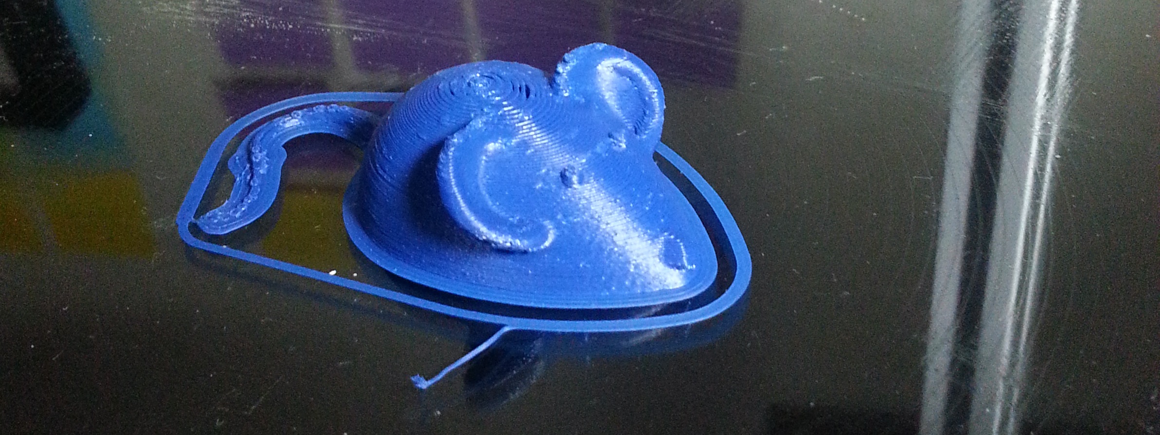

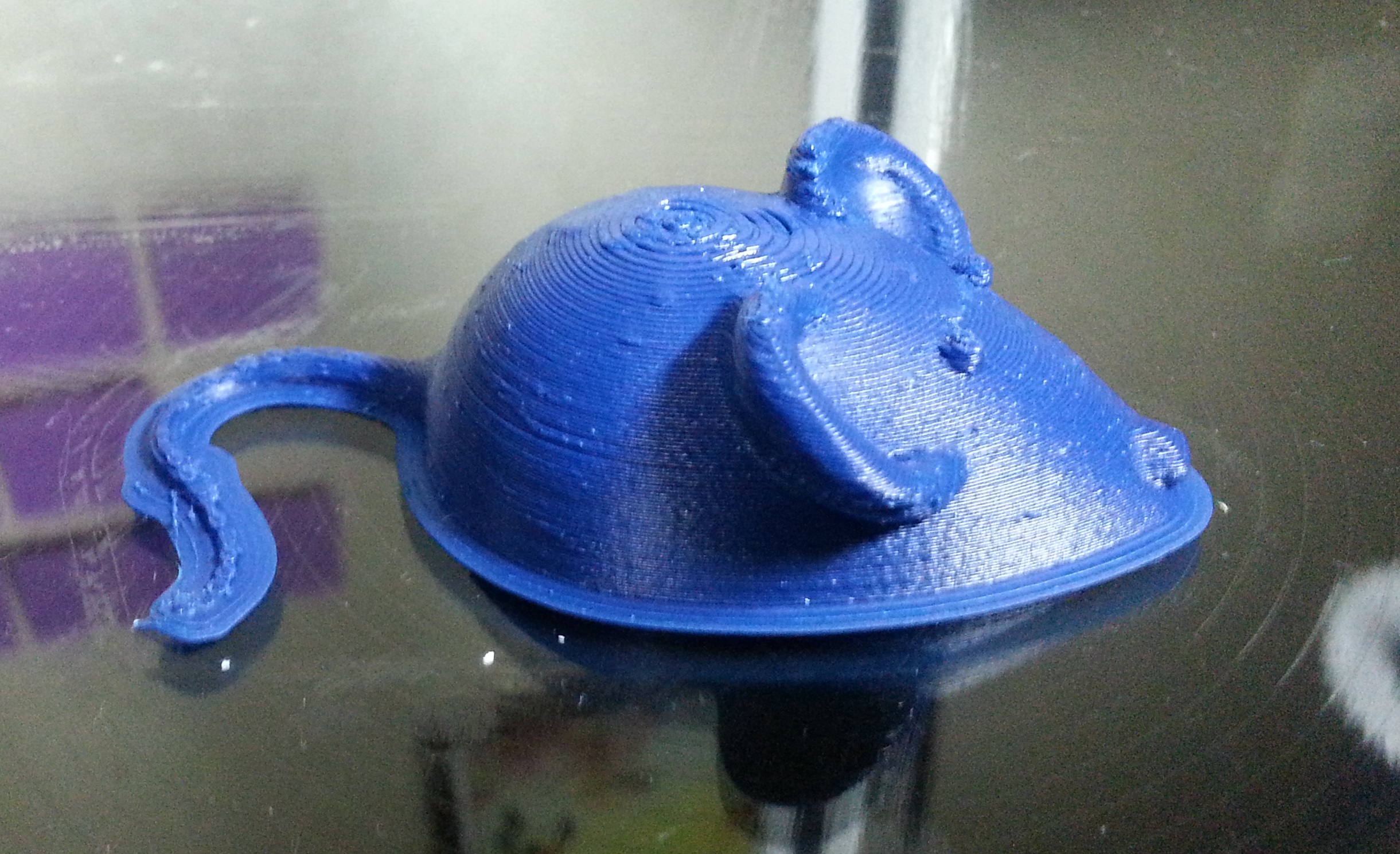

my first print!!!! Not perfect but at least I have something fun to give my better half!
