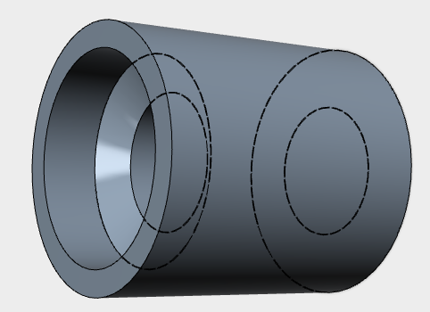

I still like the idea of using that threaded aluminum fitting - so I made this drawing of a tube to fit over the nib of the J-head and the aluminum fitting for the brass fitting of the bowden tube. This only requires one slight mod - which is to run a screw through the top piece of melamine to catch the notch of the aluminum fitting so that it doesn't turn.
Might be cludgy... I'll also try the other stl.

I spent the $9 to see if it might be useful. I can think of 100 variations to this and @foshon's links are good options too.
If your existing head is screwed up and you don't want another, the reality is that you need a working printer - or a friend to print something for you; or alternatively, parts need to be added to this kit to make it support at least a single basic J-Head. Those parts are some kind of threaded shaft to fit over the top of a standard J-Head nib. (or at least that's what I'm calling it.) The shaft should accept the Rostock brass fitting from the bowden tub.
