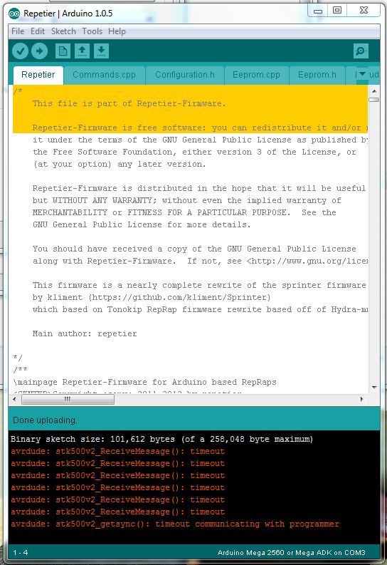

I am new to this 3d printer stuff so could someone please tell me what the most current firmware I should be running for my rostock max (very recent kit running a rambo 1.1 and LCD addon)
I have tried downloading those on the seemecnc downloads page but when ever I try to upload to my rambo I get a timeout error in the Arduino program. I have seen a few post that seem to suggest to make mods somewhere to allow it to reload the firmware on the board but can't find the full details on how.

You should only use the Repetier firmware, specifically the version in the SeeMeCNC github repository.

FWIW it's my understanding that the latest board come with repetier installed.
If your getting timeouts, make sure you have the correct board type selected in the arduino IDE, the correct com port selected and you don't have any other software connected to that comm port when trying to download. If that doesn't work, I'd try a different USB cable.

I have already check I have the correct board loaded, the same com port as is displayed in the device manager and shut down any other programs that may be connected to the rostock. I will take a spare usb cable home tonight and test that but I can connect to it in repetier host and update setting from that.

did you set the correct baud rate also, for your usb com port.?

Where do I find the Baurd rate for the usb com port? I have found the usb bits per second rate that is set at 9600cambo3d wrote:did you set the correct baud rate also, for your usb com port.?

Here is the time out error I am getting :

Near the top of the tab titled "Configuration.h". This setting must match the baud rate set in Repetier host or the two will not understand one another. Changing this is not going affect your ability to upload firmware. The usb baud rate you are talking about is only for serial communications between your computer and the board while uploading or serial monitoring. This issue has been discussed before IIRC, I think one suggestion was to try a version of Arduino between 1 and whichever you have now. You can go earlier then 1 but you will have to rename the ".ino" to ".pde".

Just FYI, the baud rate at which the Arduino IDE communictates with the ATMega controller on the RAMBo during the firmware update process has _nothing_ to do with the baud rate at which the RAMBo uses when in normal use.

jestah wrote:Where do I find the Baurd rate for the usb com port? I have found the usb bits per second rate that is set at 9600cambo3d wrote:did you set the correct baud rate also, for your usb com port.?

Trying an other computer to connect to Repetier host gives me the right settings in the EPROM page .... WIN FOR ME!!!!
Making progress but still not able to upload firmware to my Rambo.... Fail for me.... (*^%$%$#&%^$
I need to change my PRINTER_RADIUS as my head sits a little high and I am keen to get the last of the calibration sorted ( I can't get each tower home screw perfect but the head is within 0.05-0.1mm so I can live with that for now but is this still to much error? Each time I tweak one the others go slightly out)
Correct com port, Check....
Repetier not connected, check....
Different USB cable, check....
I will try to find an older copy of Arduino to run but find it strange that the seemecnc vid says to use the latest so that should not be the issue....
Still no luck
Correct board time, check....Polygonhell wrote:make sure you have the correct board type selected in the arduino IDE, the correct com port selected and you don't have any other software connected to that comm port when trying to download. If that doesn't work, I'd try a different USB cable.
Still no luck
Re: Very frustrated but not giving up (firmware question)
Did not work with Arduino V1.0.1 on a different computer.... left it to upload for well over 5 mins and not even a time out error
HELLLLPPPPPPP ?!?!?!!??

Try a version of Arduino that is before version 1 (22,23). Rename Repetier.ino to Repetier.pde and see if it will upload. Please let us know if this works.

AFAIK, it won't work - Repetier requires a version of the Arduino IDE greater than 1.0.
I'd try a different USB port and see if that works. You may simply have a dodgy board - it does happen.
nope... no luck....geneb wrote:AFAIK, it won't work - Repetier requires a version of the Arduino IDE greater than 1.0.
I did find this and might give burning a new boot loader a go
http://forum.arduino.cc/index.php?topic=163152.0
or do you guys think I should just send the board back to seemecnc?
I would contact SeeMeCNC directly about the issue.
