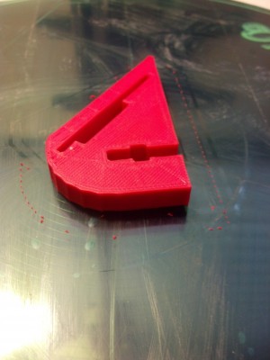

Here is a sample piece, i belive i printed this at 80mm/sec

Another part at 100MM/sec 350MM/sec Travel
