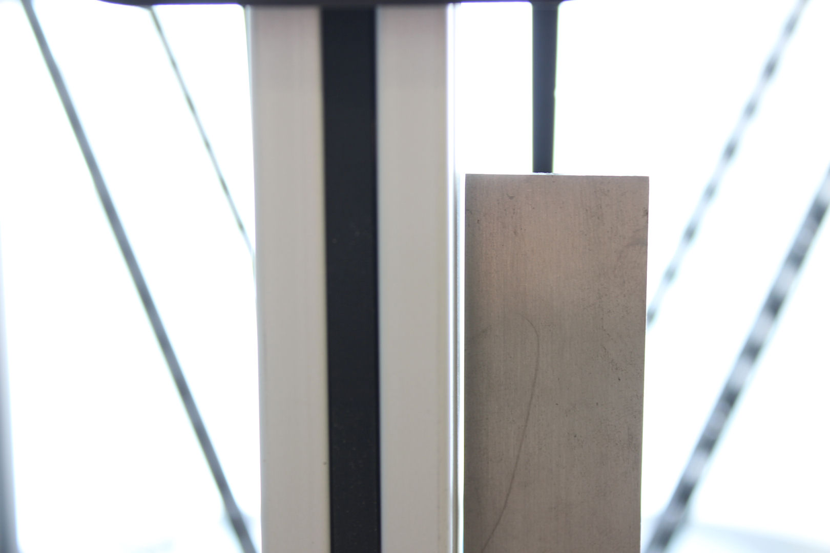

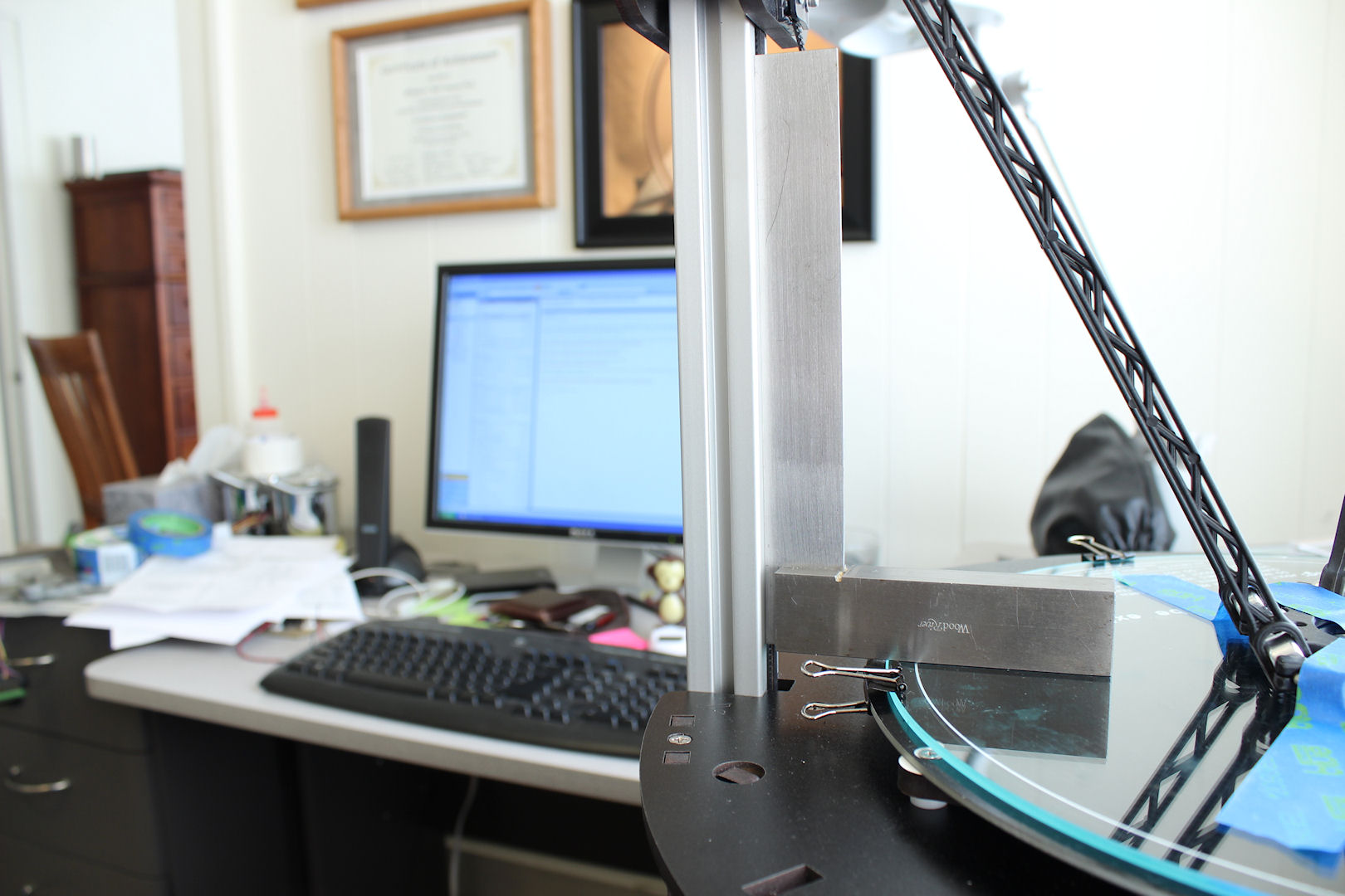

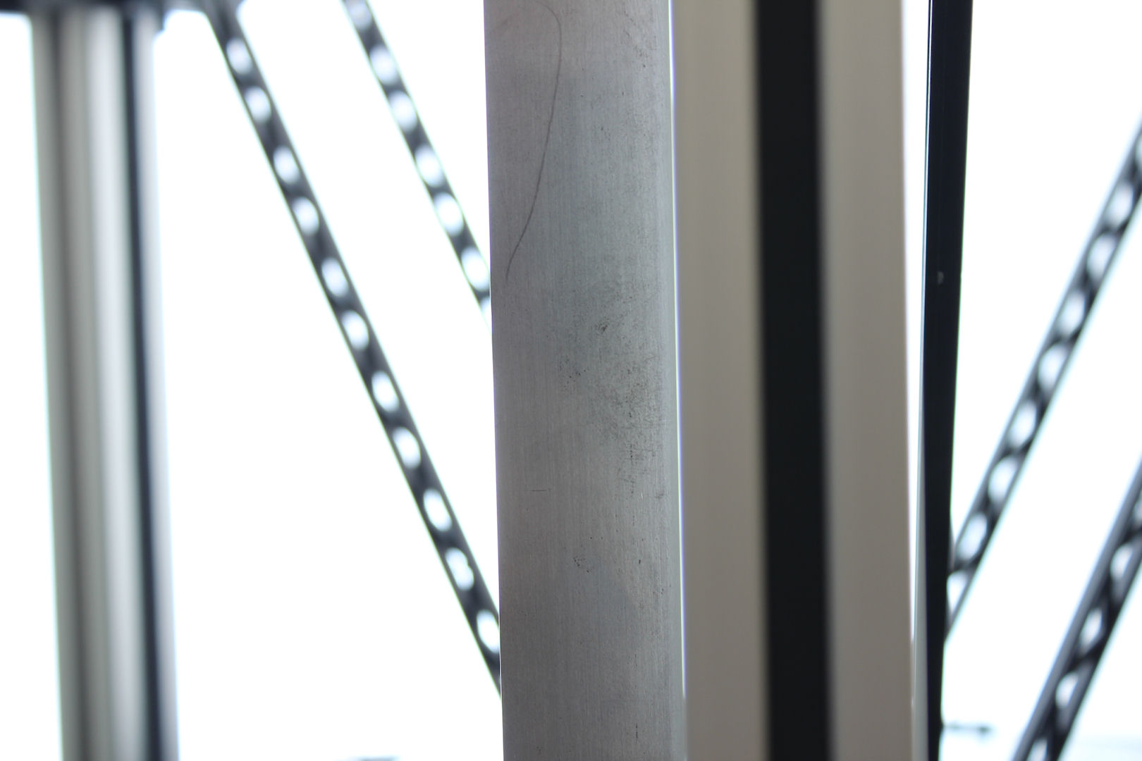

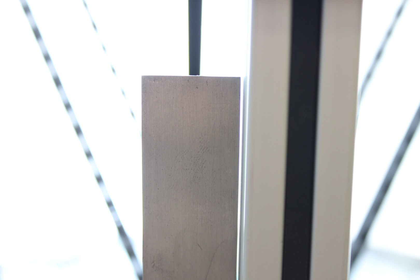

Here's a quick explanation. In this first photo the engineer's square is resting on the build plate (the glass) and its vertical leg is oriented perpendicular to the Y Axis face. If you zoom in in the photo you'll see there is no gap between the vertical leg of the engineer's square and the Y Axis face - the Y Axis, then, is perpendicular to the build plate (the surface of the glass). To test for "plumb" one would normally want to move the square to the side of the Y Axis. But, the build plate (the glass) does not extend around the side of the Y Axis. An obvious alternative is to simply place the square on the Upper Base Plate with the vertical leg against the side of the Y Axis. But when you do you get this with the square to the left of the Y Axis: And when you put the square on the right side you get this: When you get a gap at the top of the square on both sides its obvious the Upper Base Plate is not flat at its periphery (especially next to the Y Axis).

We can apply a variation of this technique to test for "plumb" of the Y Axis. In the photo below the square is on the build surface and is oriented parallel to the face of the Y Axis. By positioning the square so a thin sliver of light shines between its vertical leg and the side of the Y Axis we can determine if the Y Axis is plumb. If there is more light at the top or the bottom of the sliver then it is obvious that the Axis is tilted (is not plumb). When you look at the sliver of light in the photo you'll quickly see that the gap at the top and bottom are the same. This estimate of plumb can be made more convincing by moving your head slightly until the edge of the square just "touches" the edge of the Axis. When it is perceived to touch, moving your eye (not your head) up and down will confirm that there is no gap at the top or bottom. Humans can detect as little as .1mm variation with this procedure. It's remarkable but true.
I wish I had a measuring device that might allow me to check for plumb in a more reliable manner. But, this is a whole lot better than what I had.
